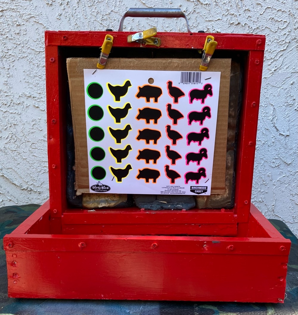

I agree with the duct seal…
In the box, made by one 4”x1”x8’ wood, is about 10 pounds of the stuff.
Behind the duct seal (It looks like C4) is a 16 gauge steel panel.
It stops all pellets and some slugs from .25 Marauder (which I no longer have).
The box it is sitting in catches some of the pellets that bounce off of the central clump that will occur.😂
