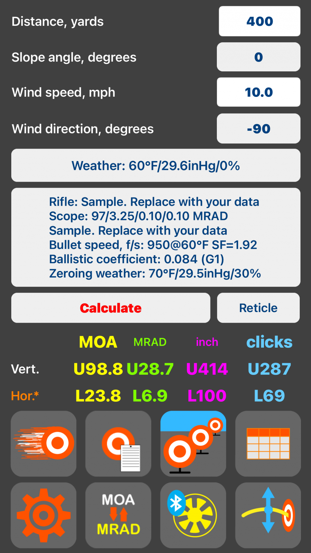

Hey OP, you might not know but you can download StrelokPro and compare ANY projectiles, drop, flight time, any & everything. It makes long shots easy once you know how to use it and you have a good rangefinder.

I brought up SHOOTER app on my phone and will use JBM calculations on my computer to make quicker referencing. I'll use my Vulcan2/30cal/44's at 865fps and my 22rf/40gr at 1100 fps. In this case I'll pick 5 mph deflection in milliradians in a value wind, meaning it is coming directly from the side. I did this to show how much more the AG blows than the 22rf in a normal wind speed.
Wind drift below
22rf at 90Y is .5 mil - AG at only 39Y is .5 mil
22rf at 110Y is .6 mil - AG at only 47Y is .6 mil
22rf at 130Y is .7 mil - AG at only 56Y is .7 mil
Next my 6mmBR with 105gr at 2850 fps compared to the AG
6br at 585Y is .5 mil - AG is same at 39Y
6br at 696Y is .6 mil - AG is same at 47Y
6br at 797Y is .7 mil - AG is same at 56Y
The correlations will be approx between PB and AG but it's better than not practicing at all.

Just mentioning this - you can choose a different sized steel for the PB and for the AG. Like a 3 moa size for the AG and a 1.5 moa sized steel for the PB. This compensates for less precision in the AG in most cases. So for example you had a 3 moa steel at 50Y which is approx 1.5" for the AG and a 1.5 moa steel at 200Y for the PB which is 3" approx. Or a 3 moa steel at 75Y which is approx 2.25" for the AG and a 1.5 moa steel at 300Y which is 4.5". And so on. Or calculate moa sized steel for both relative to distance and drops.
Here's typical elevation required for a 308 load with 175gr going 2670 fps. Elevation required for my AG, the Vulcan2 30 cal I used in my previous post.
200Y for PB is .4 mil, AG is .4 mil at 47Y
300Y for PB is 1.1 mil, AG is 1.1 mil at 59Y
400Y for PB is 1.9 mil, AG is 1.9 mil at 71Y or 6" sized steel for the PB and a 2.2 sized steel for the AG"
