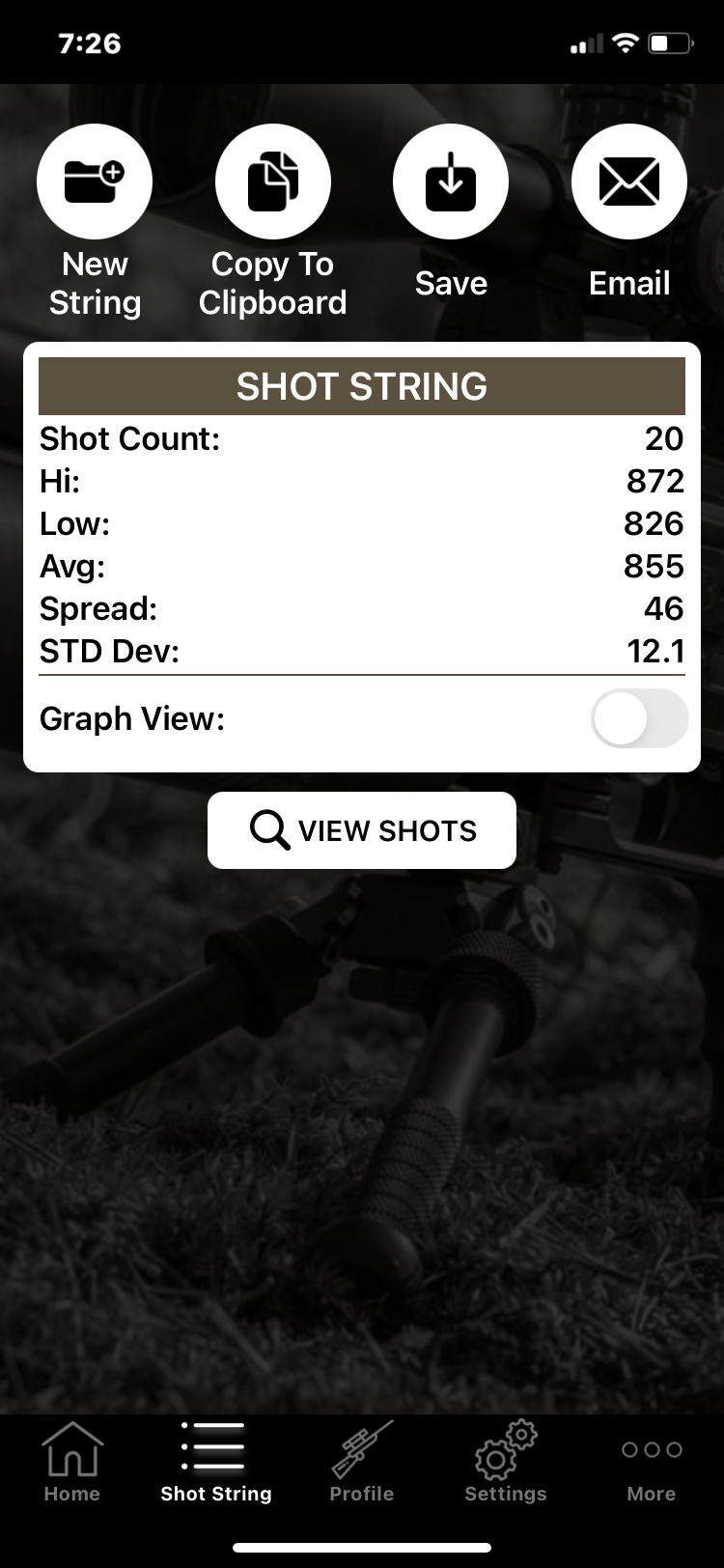

Hello Troy, this is what I did with my .25 empire xs, ported the valve, barrel, and valve back plate to 4.98 mm tried a fx impact heavier hammer spring from huma (didn’t work well) so went back to the stock spring maxed out and this is what I get. Do you think more is to be had? View attachment 291240
20 shots at 880 -900 is achievable but they seem more accurate at under 830-840 and I think that's because of the large airblast needed for 900fps disrupts the pellet. The airblast is exaggerated with it only having a 13" barrel.
