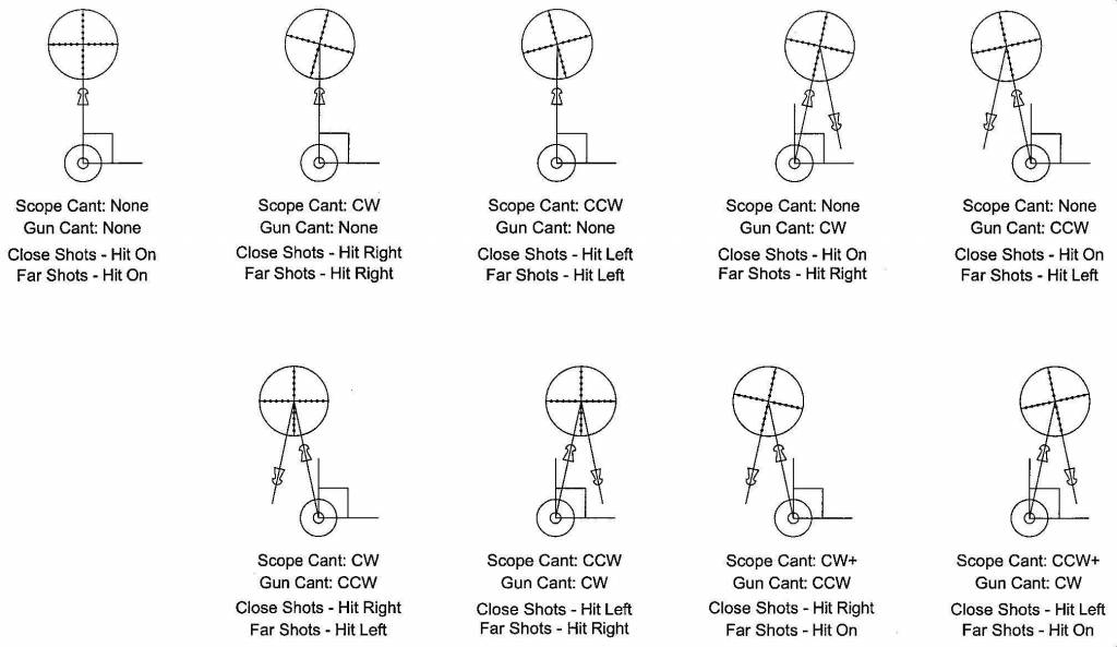

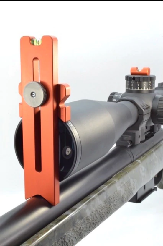

Step 5 - Make sure the scope is centered over the bore. I set up a mirror at 5 yards and set the scope to 10 yards. Put the cross hairs on the center of the bore and look for the top line of the crosshairs to bisect the objective lens. Adjust the scope as needed.

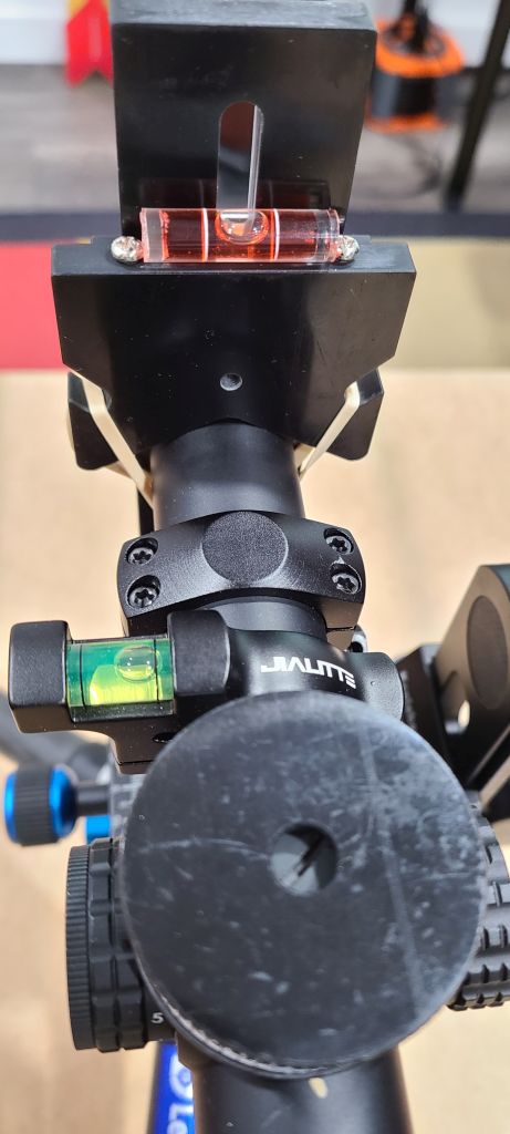

Step 6 - Set the bubble level. I have a plumb bob set up behind my indoor target, so I get the crosshair on the plumb bob and move the bubble until it is level.
