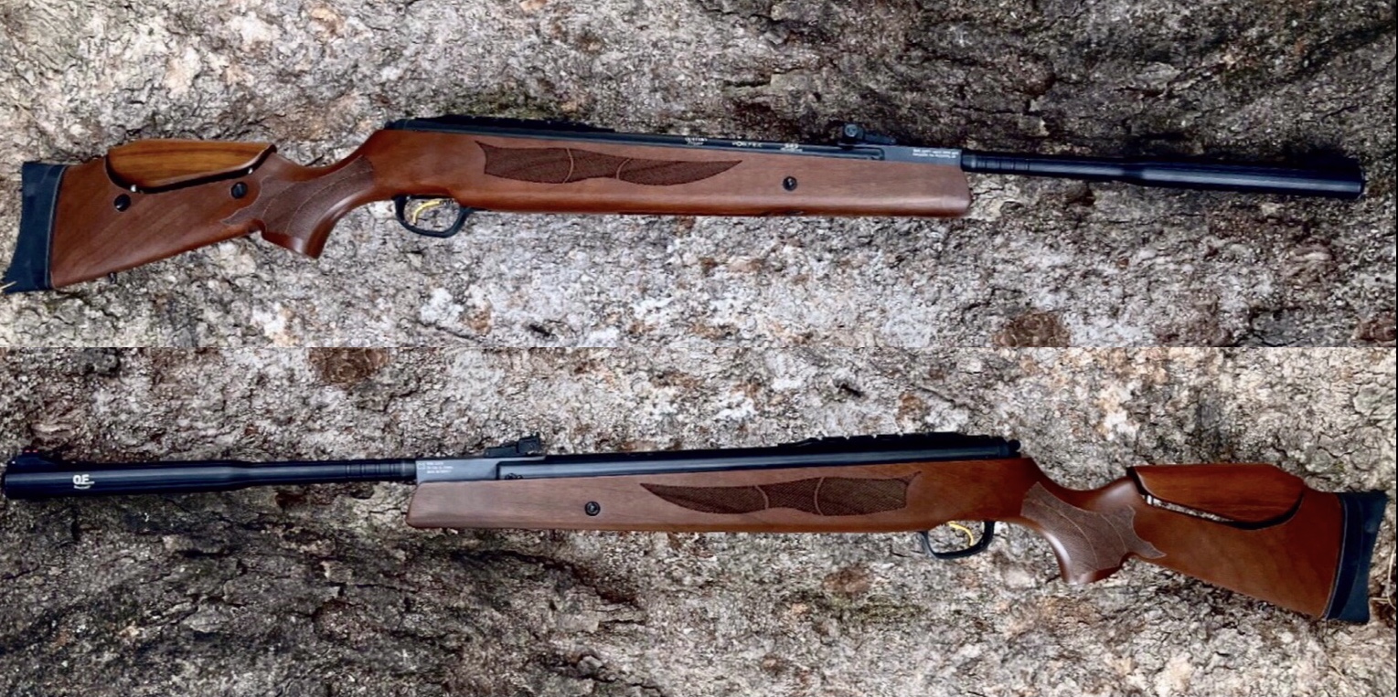

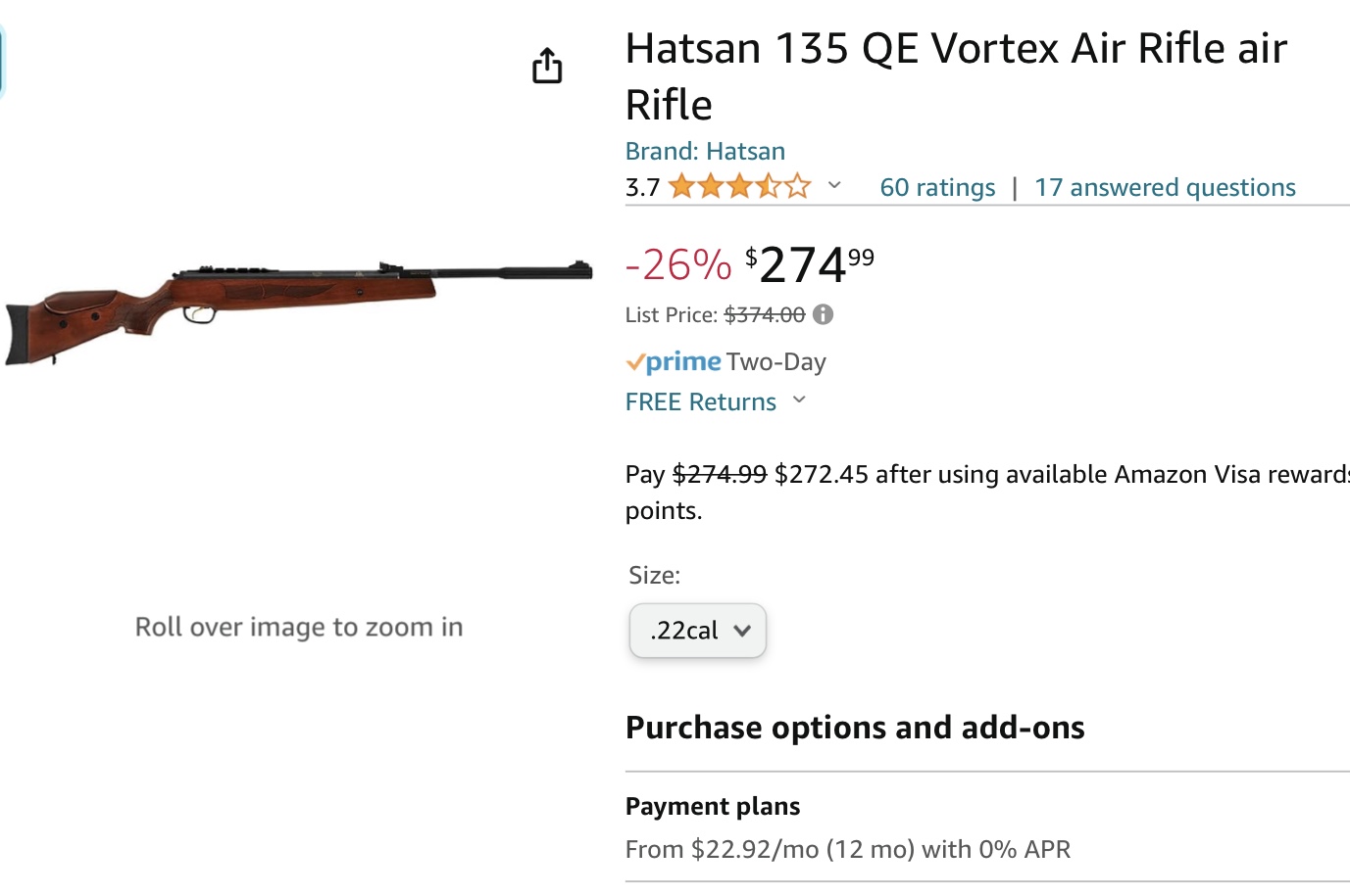

I have several Hatsan’s. The 135QE is my favorite. I would not recommend any Hatsan without the Quattro trigger. The Quattro trigger can be tuned to an excellent weight. They are solid guns and without an equal at their price point. IMHO. You really do need to learn to work on your airguns, especially springers. And even more so on budget ones. The Hatsan 135 is a fabulous gun if gone through properly. The 22/25 caliber are the sweet spot on the 135’s. The features on this model at this price point are incredible. These are VERY large guns but have a balance that makes them easy to handle. The cocking effort is not for anyone who thinks a Weihrauch or equivalent is a challenge. But my 135QE 25 caliber is one of my favorite airguns. And when my shoulder is not acting up, it’s my “go to“ lead slinger.
I have several Hatsan’s. The 135QE is my favorite. I would not recommend any Hatsan without the Quattro trigger. The Quattro trigger can be tuned to an excellent weight. They are solid guns and without an equal at their price point. IMHO. You really do need to learn to work on your airguns, especially springers. And even more so on budget ones. The Hatsan 135 is a fabulous gun if gone through properly. The 22/25 caliber are the sweet spot on the 135’s. The features on this model at this price point are incredible. These are VERY large guns but have a balance that makes them easy to handle. The cocking effort is not for anyone who thinks a Weihrauch or equivalent is a challenge. But my 135QE 25 caliber is one of my favorite airguns. And when my shoulder is not acting up, it’s my “go to“ lead slinger.View attachment 391418View attachment 391419
No wonder they're a bich to cock. That much power from such a short barrel. I shot my full length R1 today. At 18.5 fpe it's not fun for a long time. I can't imagine cocking one of those monsters with such a short barrel for more than a few shots.
It’s a short barrel with a long sleeve. It’s a momentum thing to cock. I do it one with one arm just like any other barrel cocker. If my shoulder is behaving, I can cock it all afternoon. You don’t want to shoot it for a while then cock the HW30. May just rip the barrel off. Seriously though, these guns are a riot to shoot.
I've been wanting one of these in .30 for awhile just because of how ridiculously silly they are
