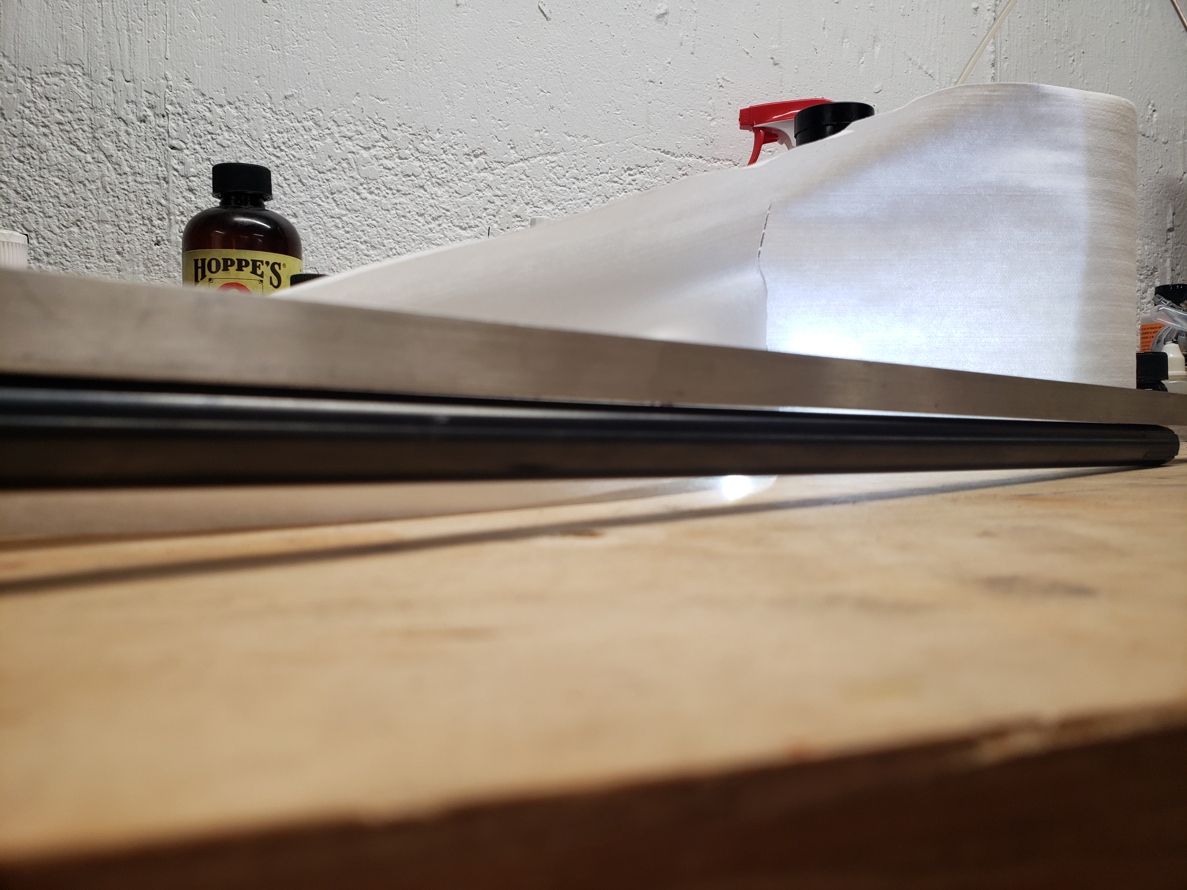

It's hard to measure. I few thousandths out at the muzzle puts it a long way out. I check the barrel with a straight edge first.
Sometimes the barrel is bent in the middle. Someone sent me a R1 with the barrel bent. It's hard to see but there's a straight edge along the top of the barrel. You'll see light under it mid barrel. I located the high spots and straightened it in an Arbor press. Then reinstalled it and adjusted it in the gun.
