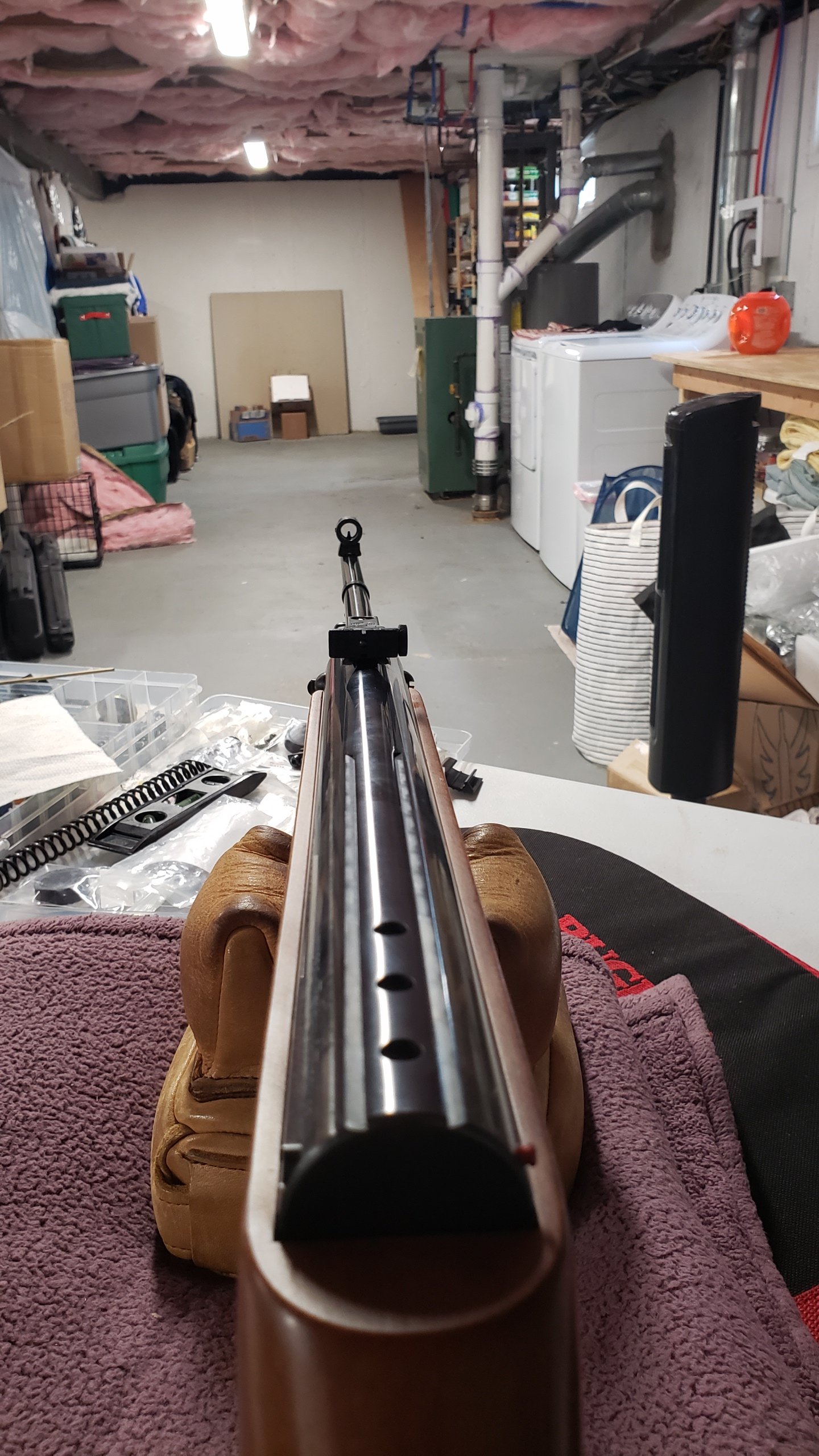

If your rings aren't centered in the dovetail you're going to have lateral variance. Most dovetail rings are made to fit multiple dovetails resulting in the scope being offset to the receiver.
The Sportsmatch rings are as close to center of an 11mm DT as I've seen. Most new Weihrauchs need the barrels trued left and right to some degree. I do it all the time. Here's a new Hw35 with the barrel hooked to the left over 5' at ten yards. I use Sportsmatch rings and multiple scopes optically centered with a mirror for redundant verification. . Adjustments needs to be checked at two different ranges with no wind.

They're easy enough to tweak left, right and up. I try to adjust them to be within a quarter inch at 10 yards and then check them again outside at 25 yards on a windless day. I prefer the windage require less than a quarter turn of the turret.
The Sportsmatch rings eliminate the complications of offset mounting.

the scope. If I'm still shooting an inch to the right @30 ft with the Sportsmatch rings
I'll know my barrel is canted to the right. I think I'll run a straight edge along the receiver
tube and measure each side of the gap between the straight edge and barrel tip.

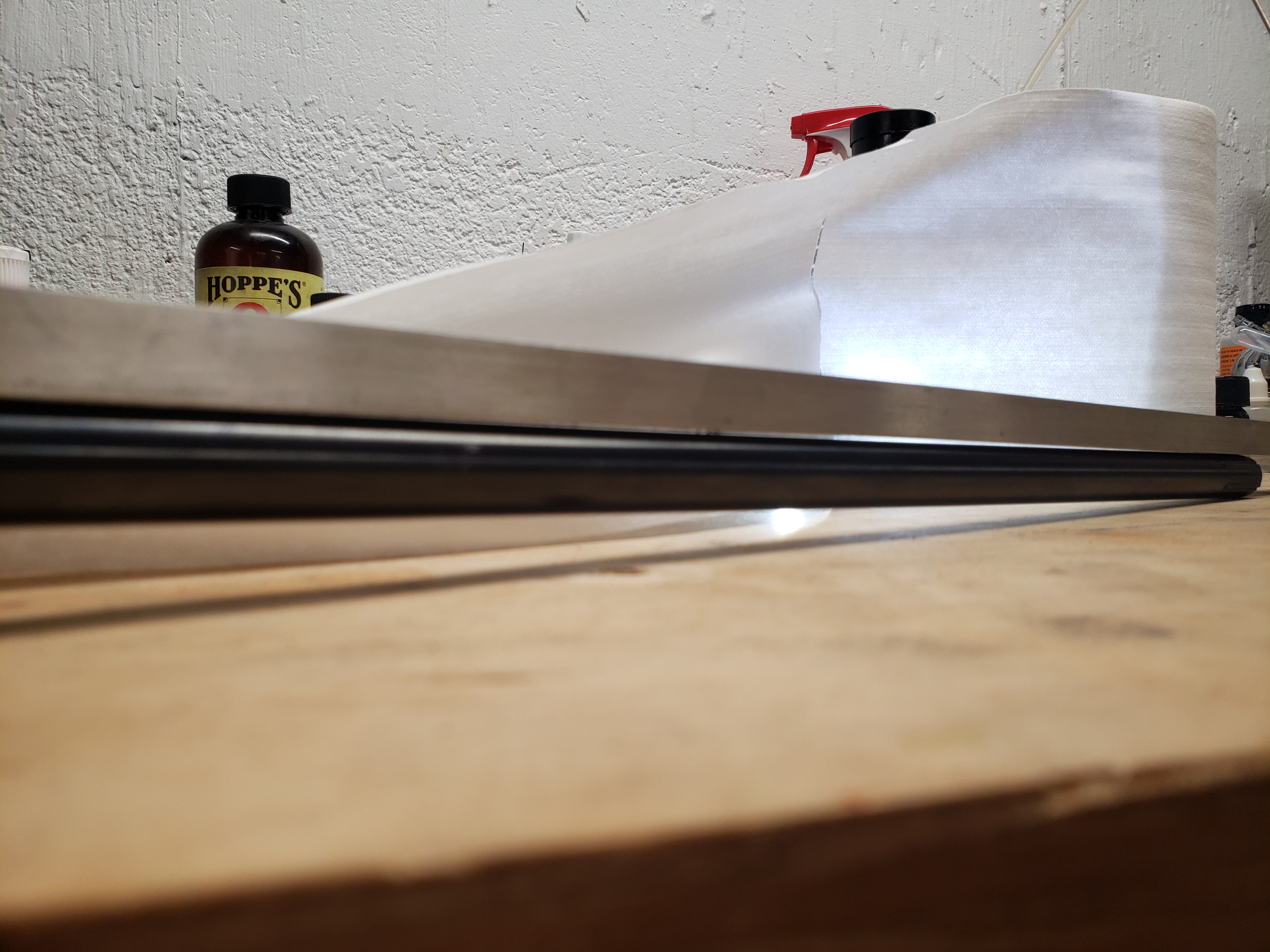

It's hard to measure. I few thousandths out at the muzzle puts it a long way out. I check the barrel with a straight edge first.
Sometimes the barrel is bent in the middle. Someone sent me a R1 with the barrel bent. It's hard to see but there's a straight edge along the top of the barrel. You'll see light under it mid barrel. I located the high spots and straightened it in an Arbor press. Then reinstalled it and adjusted it in the gun.
