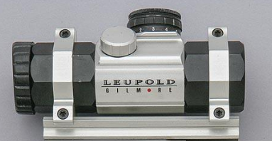

Hmmmm....maybe I have not relayed my message correctly. The old Leupold Tube Red Dots had a light weight (aluminum) six-sided, picatinny rail mount that worked exceedingly well on my powder burner revolvers.
I just wondered why that was the only time that I had seen or used one and it worked perfectly, at least in my instance.
Here is a picture of the one that I have. Although it is a short 'scope' I have used this one for well over ten years going ± 45,000 rounds of recoil without a mounting or misalignment hiccup.
Curious why something like this wouldn't work on an air rifle without the recoil especially. You bring up some valid points about misalignment, although I'm not sure that at least some misalignment can't be overcome with the scope adjustments.
mike
mike
I highlighted the important part of what you said. There is no vertical line to try and get intersection with the bore for holdover/unders. It's a "floating" DOT.
