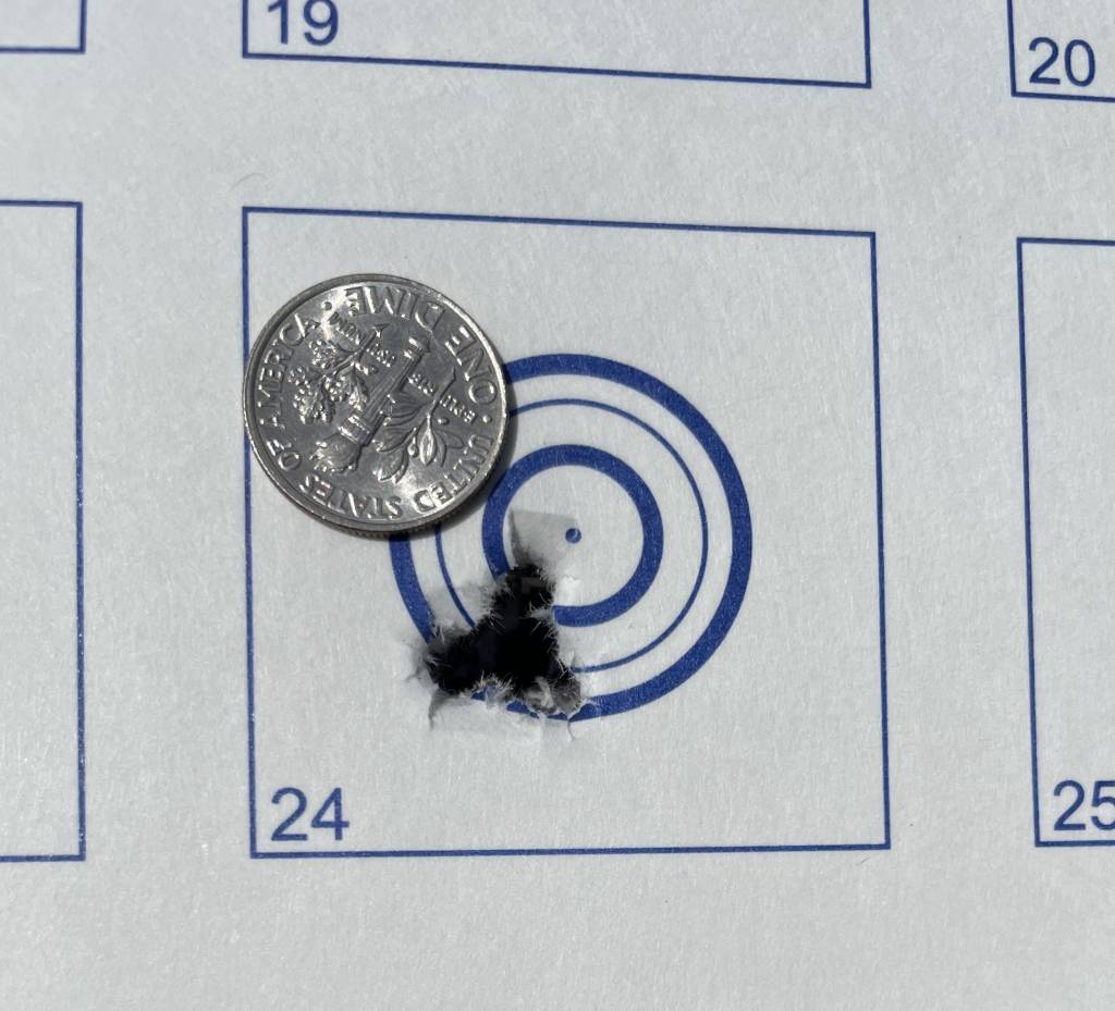

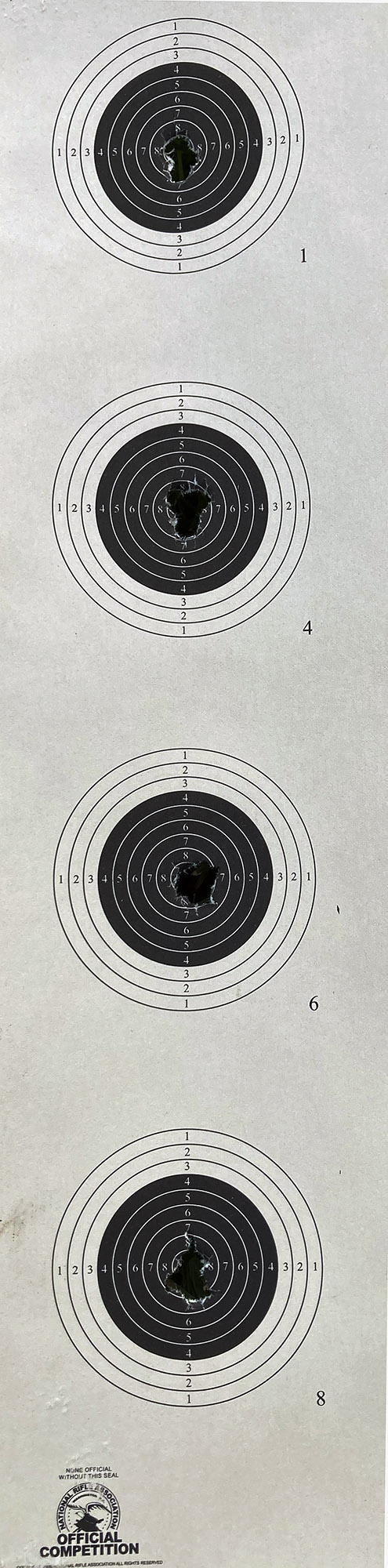

I'm shooting JSB Knock Outs and JSB/FX Heavy pellets out of my Crown with the standard Superior liner. Pretty much shots on top of each other at 50 yards. Oddly, point of impact does not change when I switch between the pellets and slugs. I do have the harmonic tuner installed. As mentioned before, as long as you don't go heavier than 34 grains, you don't need the Superior Heavy liner. I tired shooting a few groups with NSA 33.5 grain slugs and got the same accuracy results but point of aim shifted about an inch.
