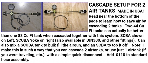

This is what you will need
https://www.amazon.com/Taousa-Station-Detachable-Stainless-Pressure/dp/B0179LFCLO/ref=sr_1_3?ie=UTF8&qid=1532964260&sr=8-3&keywords=scuba+fill+station

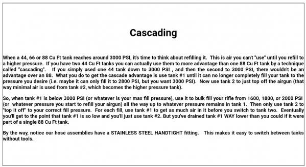

i would fill the with the aluminum tank, then top it off with the higher pressure steel thank, that’s called a cascade fill.

This is what you will need https://www.amazon.com/Taousa-Station-Detachable-Stainless-Pressure/dp/B0179LFCLO/ref=sr_1_3?ie=UTF8&qid=1532964260&sr=8-3&keywords=scuba+fill+station
