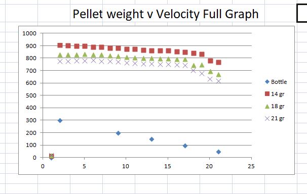

I had to make two graphs because I'm not good enough with Excel to do everything on one graph. First graph is the overview graph and shows the various pellets and the pressure decrease as the shot count went up. Total shots for this test is 60. I also can't figure out how to get the picture in the body of the post.

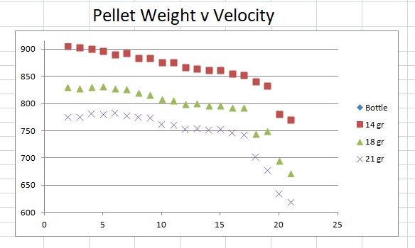

Second graph blows up the chart to better see the pellet velocities.
I doesn't appear to me like there is any regulated pressure/shot happening anywhere. For the first 8 shots on the 14 grain pellet, I used my different weights going up to a 2 oz weight and there was no difference in the overall dropping of the velocity from shot to shot so the velocities are just using the Crosman hammer. So, I'm not sure what the next step would be. The above conversation hinted that a lighter hammer might be required but I think ("think" being the operant and, in my case, dangerous, word) this is saying that I'm not hitting the valve anywhere hard enough. So maybe a lighter valve spring or somehow an even heavier hammer spring/heavier hammer?
Thanks for any and all suggestions, critiques, or comments.
