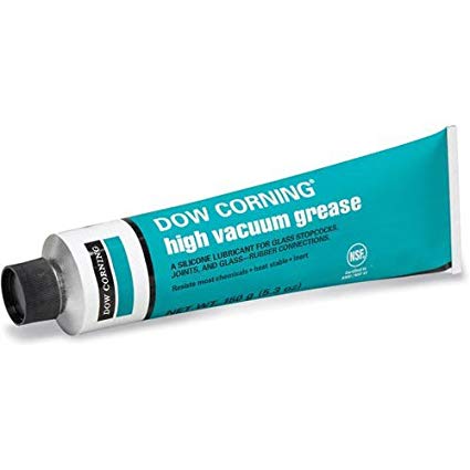

Do not use any type of grease or other lubricant for gun O rings. At high pressure O ring deforms to fill area and with grease it can’t work properly.
Do not compere it to hand pump. Most of the O rings on a hand pump works in low pressure and those that work in high pressure replace regularly and small leaking is not important there.
Going to have to disagree with you on this. Using orings not lubed is just asking for leaks, no matter how dense the oring.
Silicon greese like Trident is good, but Dow High Vacuum grease, it's made for just that, to perform under pressures.
I’v never saw that vacuum grease. I used normal molycote silicone grease and found O ring failure and leaking with it.
