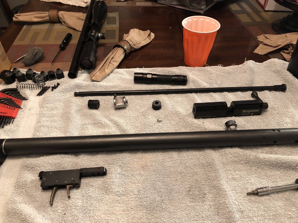

.22 caliber. I watched a 30min video of a guy changing to an aluminum lower tube and new valve and nylon hammer so I feel pretty confident that I could completely disassemble johnny5 😂

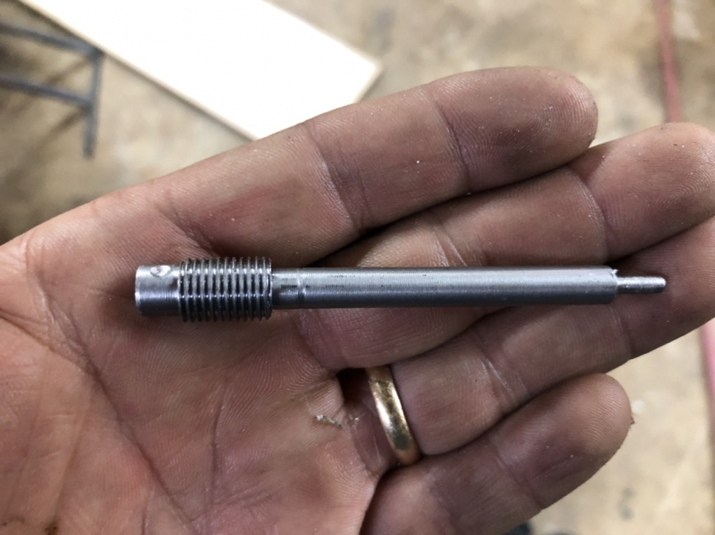

1574886995_15105129415ddede53c42ff4.11800974_7F112B3A-D0F5-41F0-92EC-4C547BDA7FAE.jpeg
I do believe this will work...gotta few things I gotta do and I’ll get back at it.

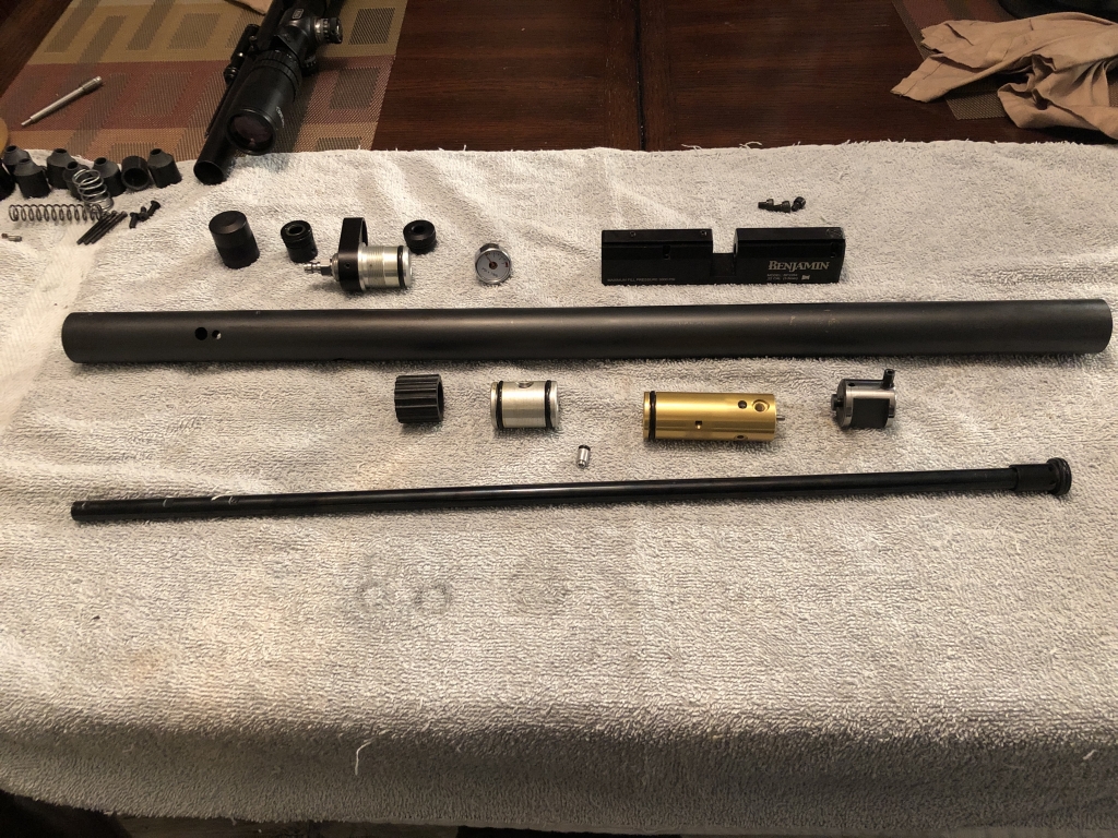

Ok...proud to report that the handmade tool worked flawless and I’m currently here...just cleaning things as I go. I’m gonna stop here until I get further instructions. I did notice when taking it apart that the transfer tube has the top oring missing..it’s not in the barrel because for giggles I removed it as well. If I need new parts I guess now would be the time to change them out.

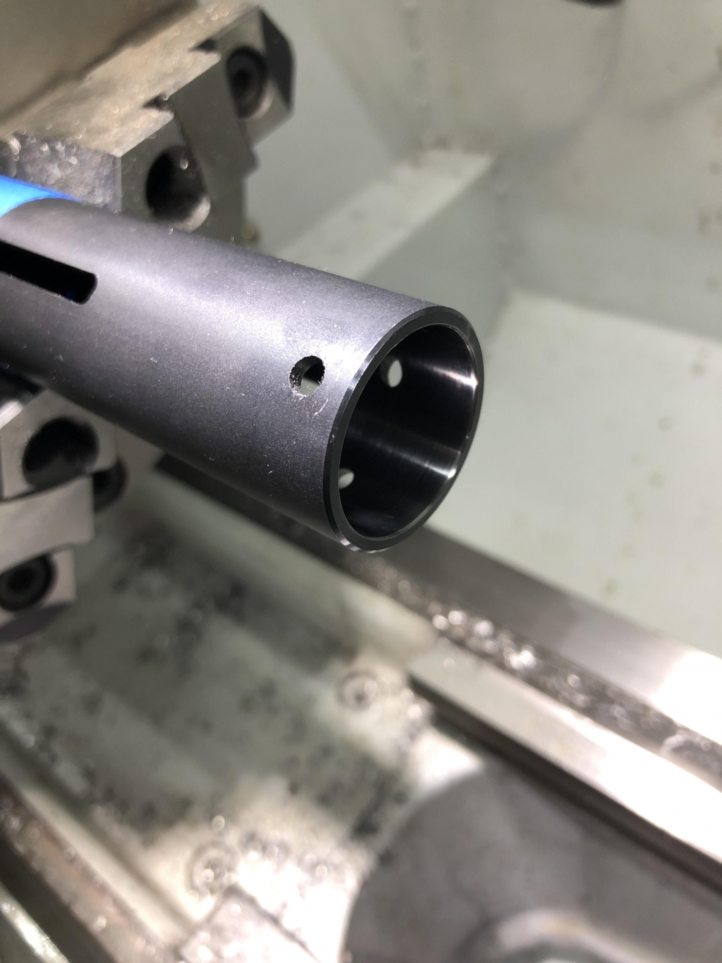

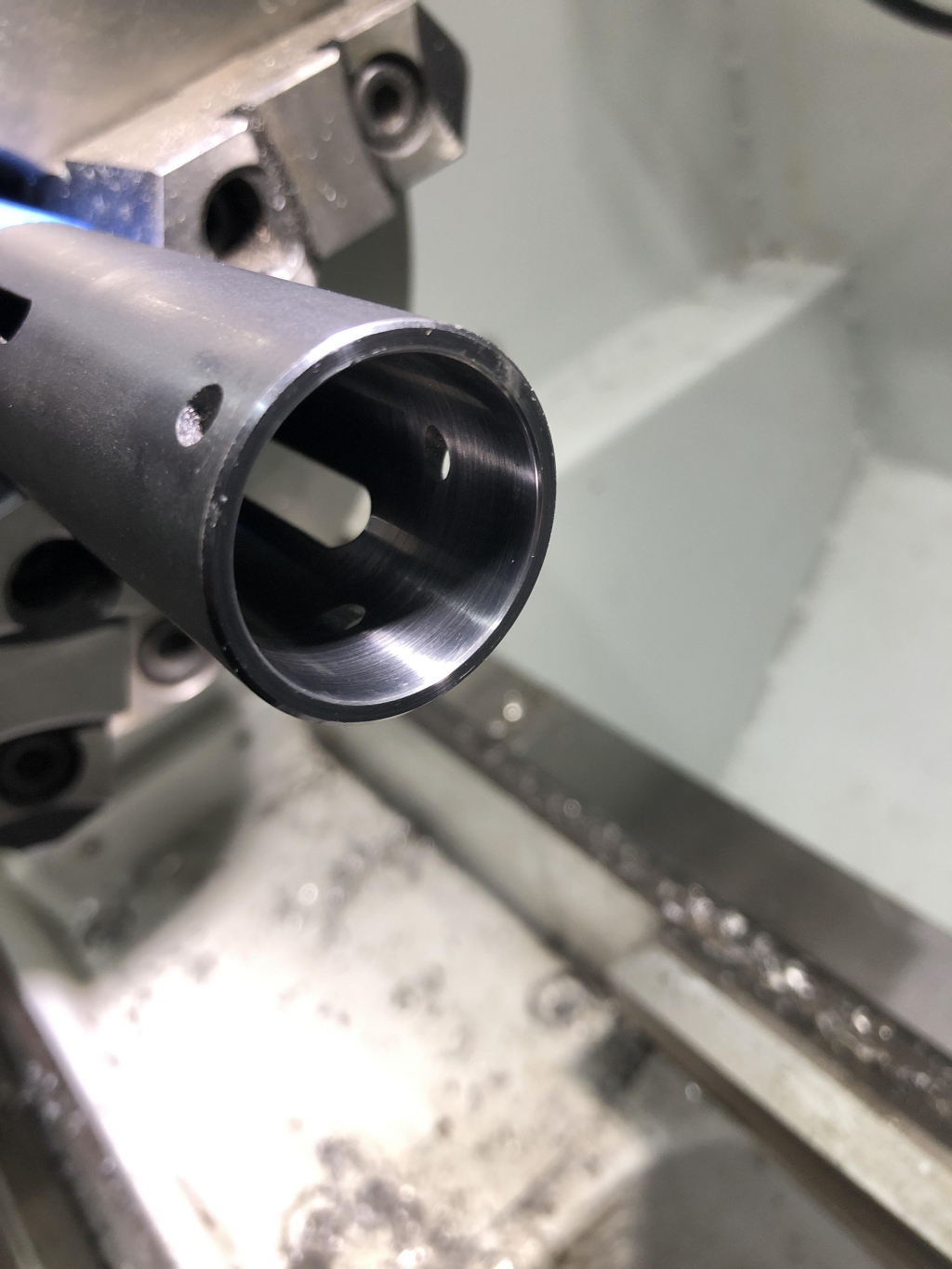

JasonBowlin,

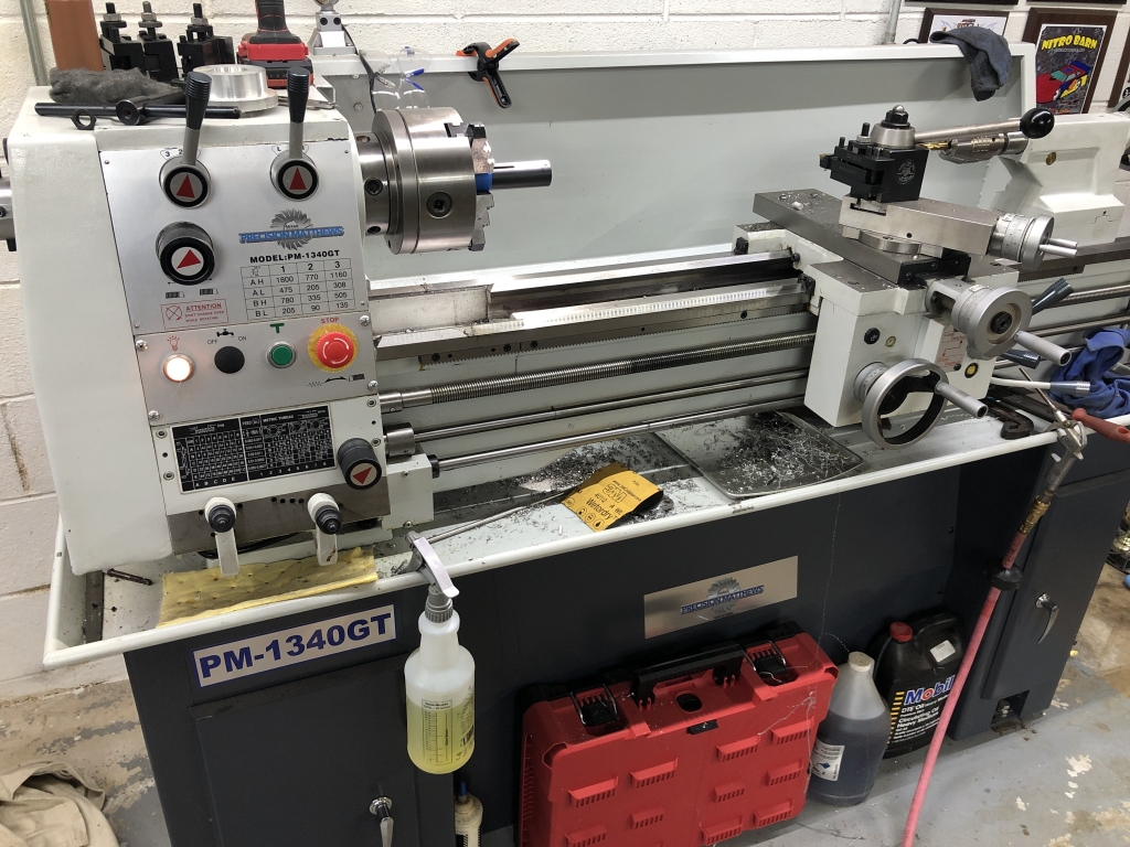

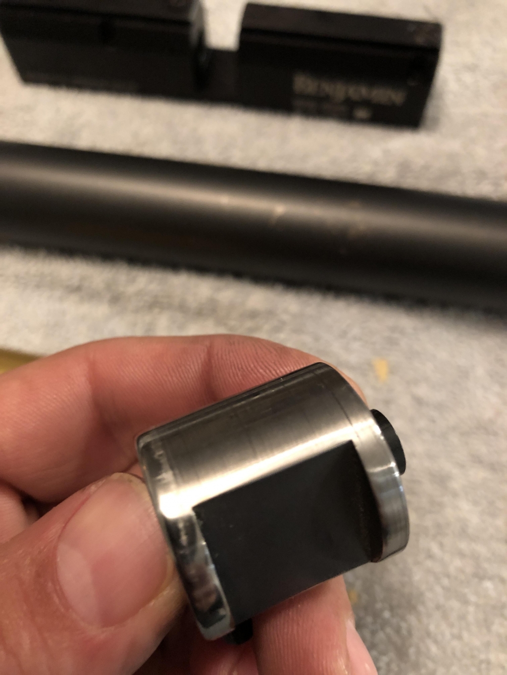

Now that you have it apart, take the air tube, and where the valve stem is towards the rear of the tube, polish that "bore", so to speak. I did mine with a paintball barrel swab, with a dab of polishing compound. Make it like a mirror. Do the same with the hammer as well. If its the factory hammer, the finish can be a little rough. Being that you said you have a lathe, you can remove the striker from the hammer, and put a longer bolt in it to hold it in the lathe chuck. When removing, there is a set screw in the side of the hammer. In between this setscrew and the striker threads, is a microscopic teflon piece that is white. Do not loose that, it's a VERY important part of the equation. After you do all of this, I'll walk you through the next step.

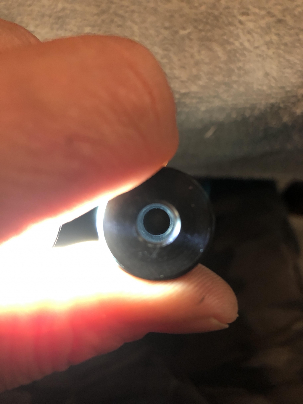

Jason,
Yes, you do not want to go any further, as the valve orings may not seal. Another thing that I forgot to mention, is the holes in the air tube from the muzzle to the valve, particularly the hole of the gauge block can be chamfered, to avoid cutting the orings from the gauge block and the valve. If you do this, you might have to LIGHTLY polish inside of that hole after chamfering to insure no burrs. You can get a tool from Archer Airguns to plug that hole, and save the o rings. Some guys take the gauge block, reinsert it so the smooth side of the block is showing (not the gauge threads). Then they mix up plumbing epoxy putty, and stick it in the hole for a couple of minutes and remove it so it doesn't bond. Let it harden, and you have a nice o ring tool .
While the barrel is off, now is your chance to change the barrel oring at the breech. Before you do that, now you can thoroughly clean the barrel. Being that it is removed, you may use regular bore cleaning solvents with patches, and I would scrub the bore with a nylon brush.
When you get all these steps complete, we'll go to the next step.
