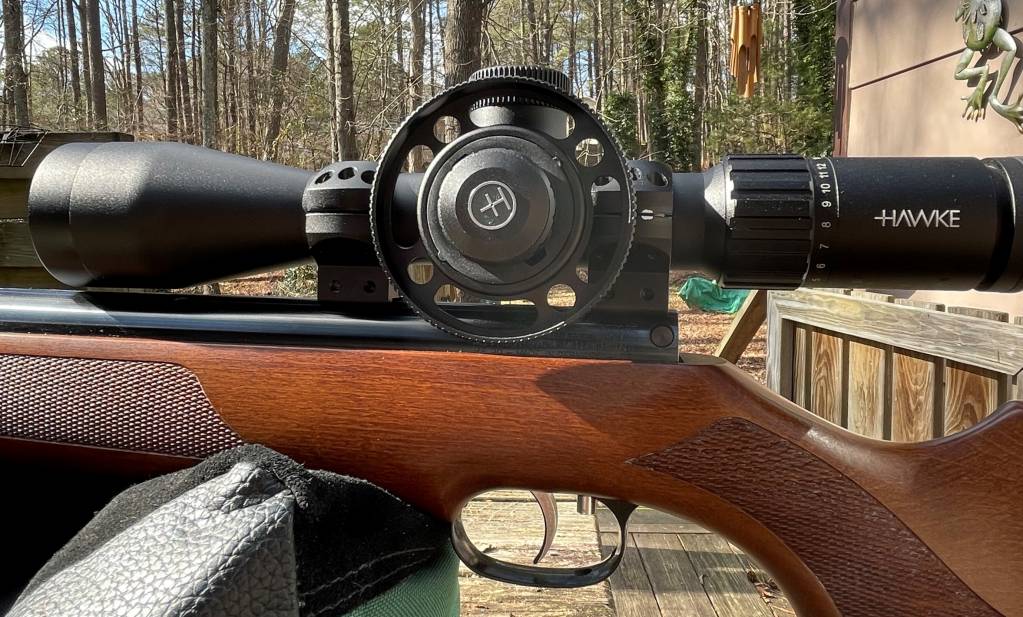

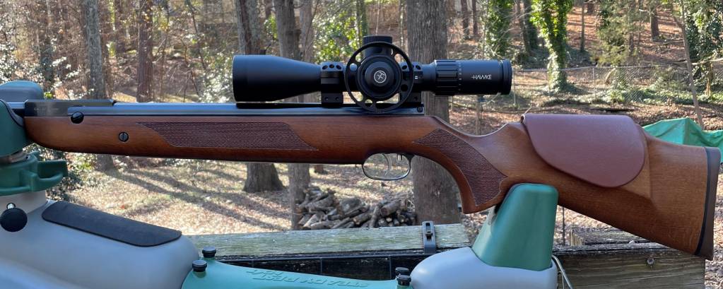

I used Hawke 2 piece medium tactical rings to mount a 4-16 x 44 mm Hawke Airmax compact IR, SF scope on my HW95. This scope has a 2" objective lens while your 50 mm scope has a 2.2" objective lens. My setup left less than 1/8" clearance with the medium rings so IMO you will need high rings for your scope. My check is to mount the rifle with your eyes closed and then open your shooting eye and you should have direct center scope alignment. I added a check pad to my HW95 to achieve this alignment.
