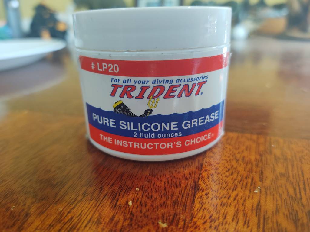

Long lasting of o'rings is also related with lubrication with silicone grease.
The faster the o'rings get dryer, the less they last.
Just be sure you don't get this stuff, or any silicone, on metal-to-metal parts that are under pressure or heat. A lot of folks mistakenly think that silicone is a good metal lube, which it is not. And under high heat or pressure it will cause seizing.
