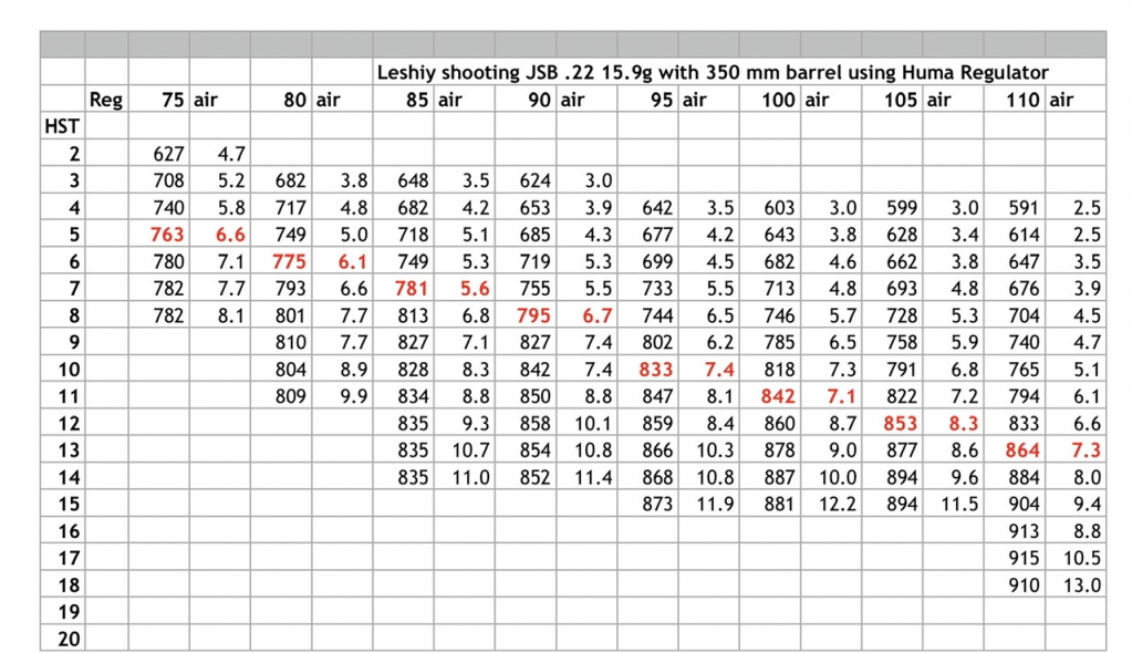

30 bar per shot is way too high. I don’t shoot my Leshiy with the .25 cal barrel but I made a reference chart a few months ago using the .22 350mm barrel. I only went from 75 bar up to 110 bar on my regulator with different HST setting. 13 bar per shot was the most I was showing. Maybe your HST is set way too high.
