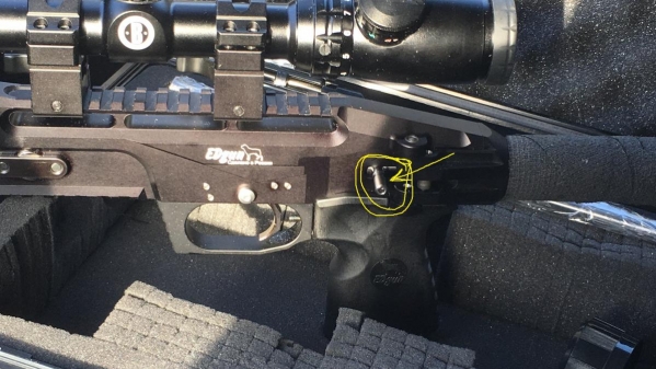

Guys on a Russian forum, who have Leshyi for a while already had that problem and had to replace springs.
As I mentioned before, they even started making and selling easily removable lever
When you leave Leshyi stored for a while - you unscrew that cocking lever
