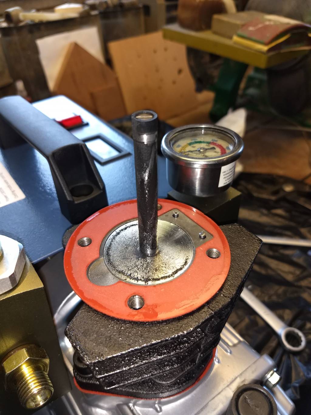

 This is the very abrasive carbon deposit form improper oil. Notice the area where the reed valve rest. It can no longer seal. Yet the poster though it was looking good with no harm what so ever. Again, nothing could be further from the truth. It is pending doom for this poor unit! It will lead to failure period! (Note the coating on the synthetic piston ring. Might as well be sand paper). This is one of those cases where the saying "Here's your sign is appropriate.

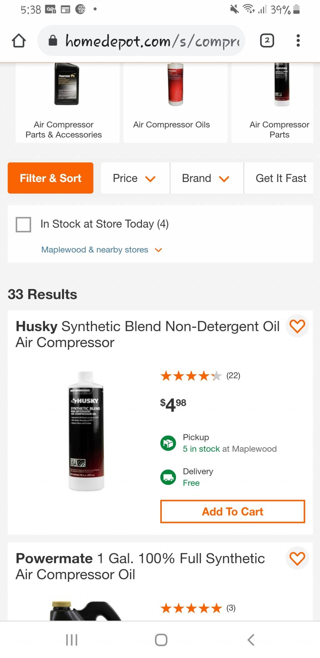

If you spend 3-5k on a compressor, its best to use high quality oil made for the compressor. But these are cheap Chinese compressor. A brand name company will recommend their high price oil, or you can void warranty. They want you to buy their $50 a quart oil duh lol. But most of the members here don't even own a 3-5k compressor. Most here own a yong heng or those 1k compressor also made in China. I own and use a yong heng and hatsan lighting for 3 years and use royal purple for a year till I switch over to the cheap $5 a bottle husky compressor oil at home depot. I'm still waiting for it to blow like some claim. My compressor still running just fine. So I speak from experience, as long as you are using synthetic compressor oil or non detergent compressor oil, you are fine. Don't need a pricy brand name compressor oil for these cheap compressor.
