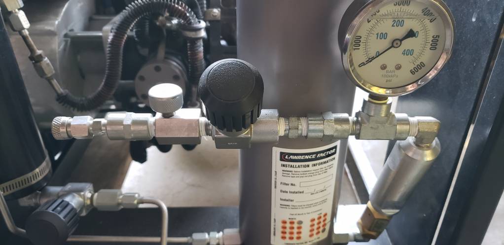

You have come off the bottom of the filter container? Would it not be better to come off the priority valve or the upper part of the filter container. It’s a little hard for me to see exactly what you have done but it seems you and I are heading in the same direction.
As to why no others. I suspect just because they didn’t know any better (maybe)

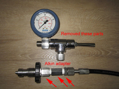

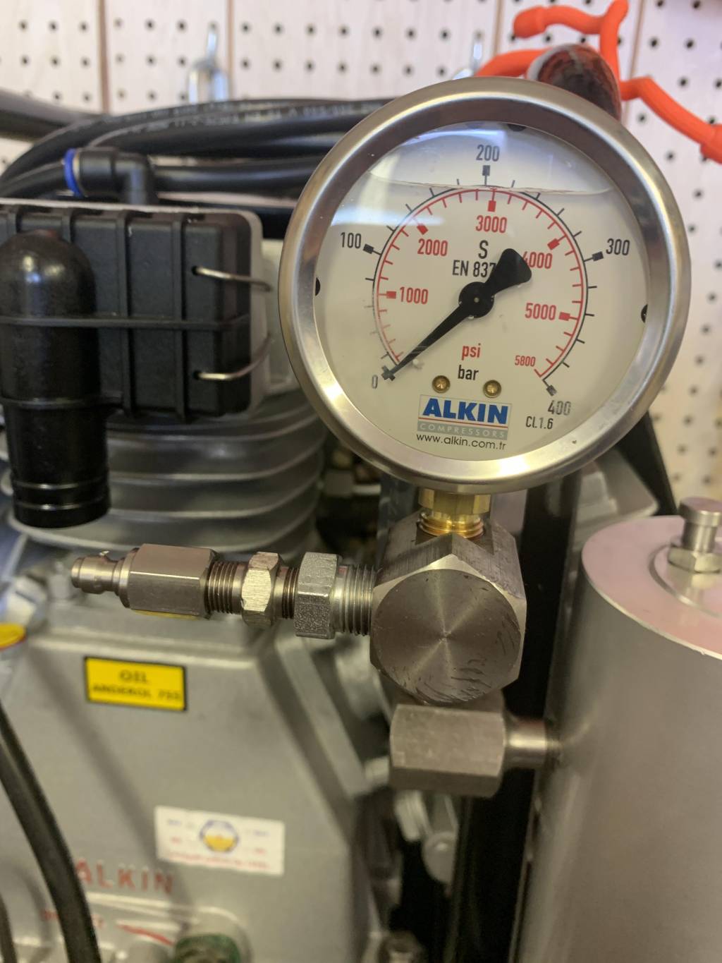

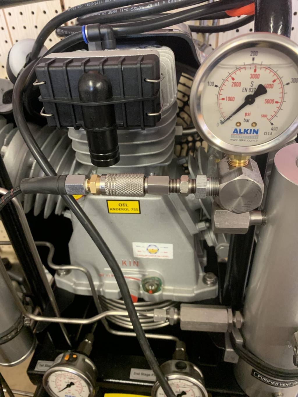

My Alkin mods should be complete in a week when the parts arrive. Alkin U.S. is sending an adapter to directly connect the fill hose to the DIN300 which lightens the hose connector by 2 pounds. I have two parts on order to complete the mod. One is a 2.5" 6K psi gauge and the other is a steel Tee connector added to where the fill hose attaches. The Tee is 1/4 NPT male to 2 1/4 NPT female at both output sides. I'll set the Tee vertically with the gauge at the top and the air hose at the bottom.
The gauge is a convenience not a necessity since I can read the pressure on the tank gauge. Most dive compressors have the output hose on the frame with the exception of Bauer and Alkin which have them on the fill hose. I could also add a bleed screw but I will use the air tank bleed. The whole point of the mods is to lighten the fill hose and make the compressor a bit more user friendly. Total parts cost is only $25.

Today I received the adapter from Alkin which reduces the hose weight by 1.75 lbs. It omits the bleed lever, pressure gauge and two adapters from the fill hose. If you want a compressor where you get responsive service, buy an Alkin. They shipped this adapter on the same afternoon I asked about it. That is customer care like we rarely get when we buy equipment. Thank you David and Ayden.
Here is a photo of the fill hose with the take off parts above in the photo. Once I receive a Tee valve I have on order I'll install a gauge on the compressor although it's a convenience not a necessity. If you are new to compressors and tanks and are asking yourself why remove these parts? There is a gauge and bleed valve on the air tank already that read fill pressure and bleed the pressure from the hose after a fill.
