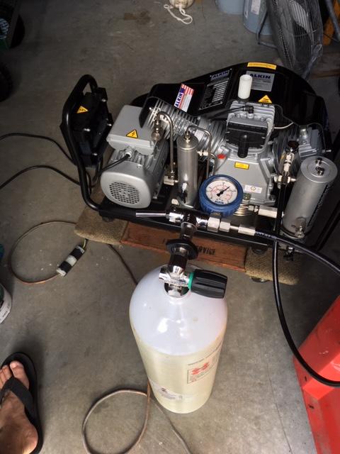

I’m a new owner . The fill valve operation has me unsure Filling the tank seems to go ok but the disconnect has me questioning . Once the air tank is filled you are to close the valve on the air tank and then close the lever on the fill valve . What happens then is what has me in doubt. The compressor immediately goes into over pressure and the pressure relief valve opens with a pop. Seems like the fill valve handle should release pressure preventing the over pressure. The operation of the fill valve handle does not seem intuitive to me. What am I doing wrong or misunderstanding.

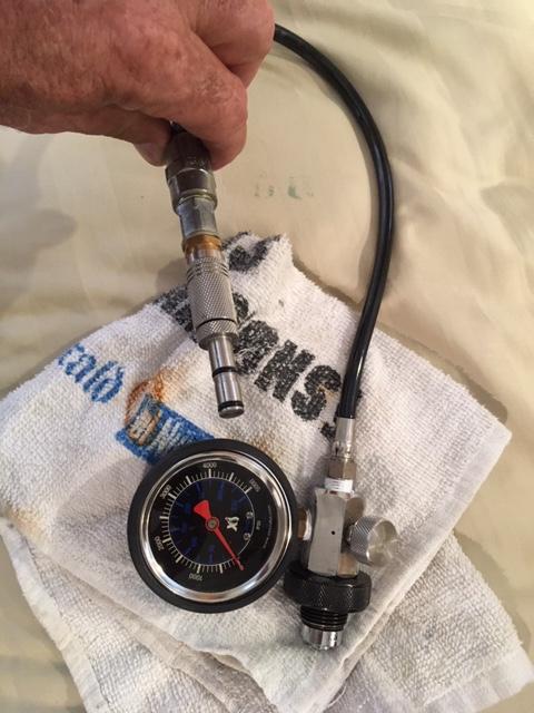

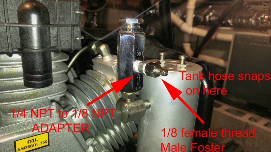

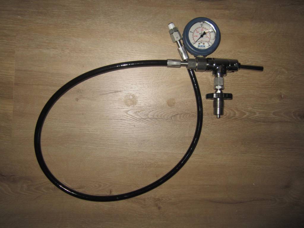

My only very minor quibble with the Alkin compressor is that the fill hose assembly is a brick and the lever isn't as convenient as a bleed screw. The entire fill whip is much heavier than it needs to be. The factory fill whip weighs 2 lbs.9oz. as pictured. It has far too many adapters and heavy components. Smithfan4152 and I made the same mods to our W31's. We removed the 1/4 NPT threaded fill whip connection to the compressor and replaced it with a 1/4 NPT to 1/8 NPT adapter. It has a female 1/8NPT threaded male Foster attached to the adapter. Now we just snap on the tank hose quick connect to the male foster on the compressor. It's so much lighter and much easier to use. The bleed valve and gauge on the tank give us the same functionality as a factory fill whip.
Bubbleboy64 is correct that the fill whip lever is counter intuitive and not as user friendly as a bleed valve would be. Here's the confusion it creates. A bleed valve drains the entire fill hose. Opening the lever merely drains the space between the fill whip assembly to the air tank. The remainder of the fill line remains pressurized because there is a check valve in the Tee connector in the lever and gauge assembly. To drain the pressure in the factory fill hose between the hose gauge and the compressor the user must bleed pressure at the filter housing. This is confusing to owners used to bleed valves and no check valve in the fill hose. That is compounded by the incorrect opening and closing directions in the owners manual.

Here's a photo of the original fill whip which I removed and my filter tower connector mod. It's simple with no loss of any filling capability.

I watched heavyw8 video and that’s what Alkin tells you to do. BUT two things. First if you are filling to 300 bar you hardly have time to close the valve on your tank and then operate that toggle lever before the pressure goes over the limit AND more importantly at least on my unit moving the toggle did not vent the fill whip though that vent hole he pointed to. That procedure did not work for me.
