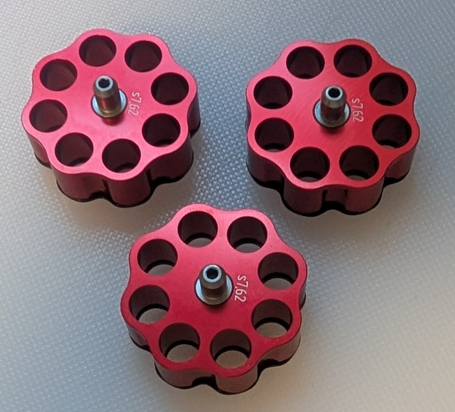

EDgun Question: Edgun Leshiy 2 Magazines 30 cal Red 7.62 Ammo Compatibility
I bought these three genuine, beautiful red Edgun magazines abroad. They are ostensibly 30 cal / 7.62 mm. They are supposed to be for slugs I suppose, as there is an "s" engraved with the 7.62 (see pic). NSA slugs and Diablo Exact pellets fit perfectly in my other two Edgun magazines, which are all black. Neither of these fit in these spiffy red magazines -- ammo is too big for it.
Do you suppose these are ammo specific magazines? I will be selling all three, if they are. All three are brand new, unused. They were PRICEY.

@RobertNoPest, LIkewise. I don't have any .300 slugs, so I can't verify anything. I do have red mags that I suspect are slug magazines as well, but they are unmarked and might be older versions. They do not fit .303 Nielsen slugs. JSB Diabolos are also a very tight fit. JSB Hades do drop right in, however. Do you have any similar pellets that you can try?

I have quite a pellet collection, but most of them are other than .30 cal. Nice that airgun ammunition is cheap! My 45-70 ammo is about two bucks a round . . .

Likewise, I seem to have more .25 than .30 selection. I'll place an order when I get around to it.
