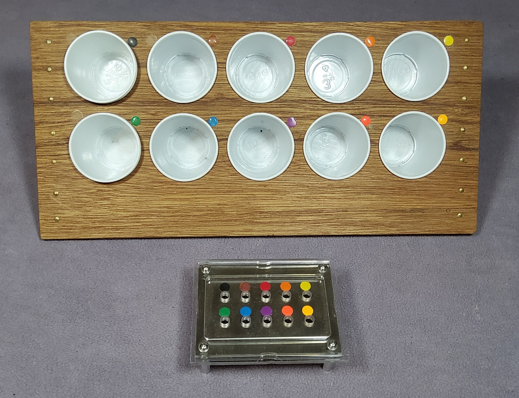

I put matching colored dots on my pellet gage and my sorting tray... pellet from orange hole on the guage goes into the orange bin type thing LOL! .,,It's quicker that reading the numbers and there's less chance of dropping the pellet in the wrong bin.

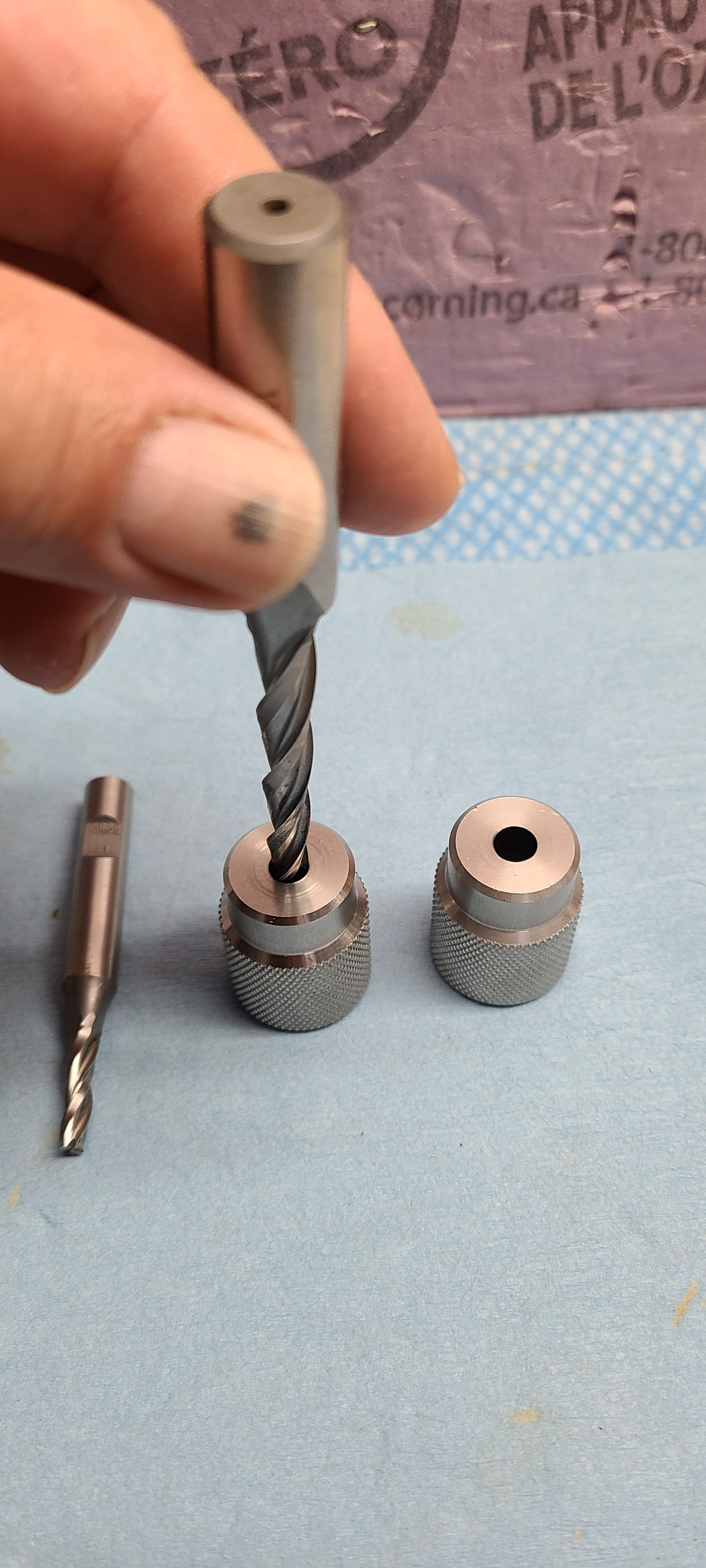

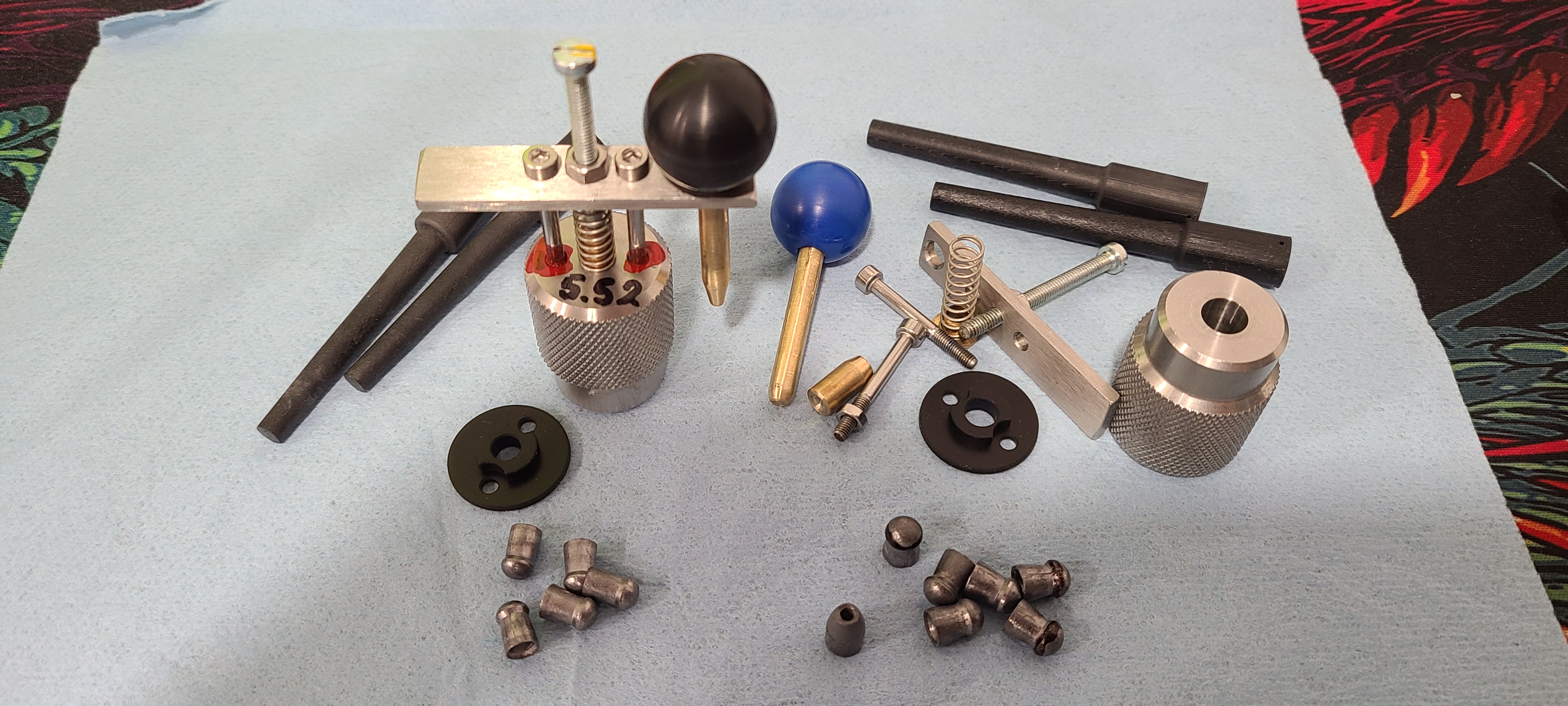

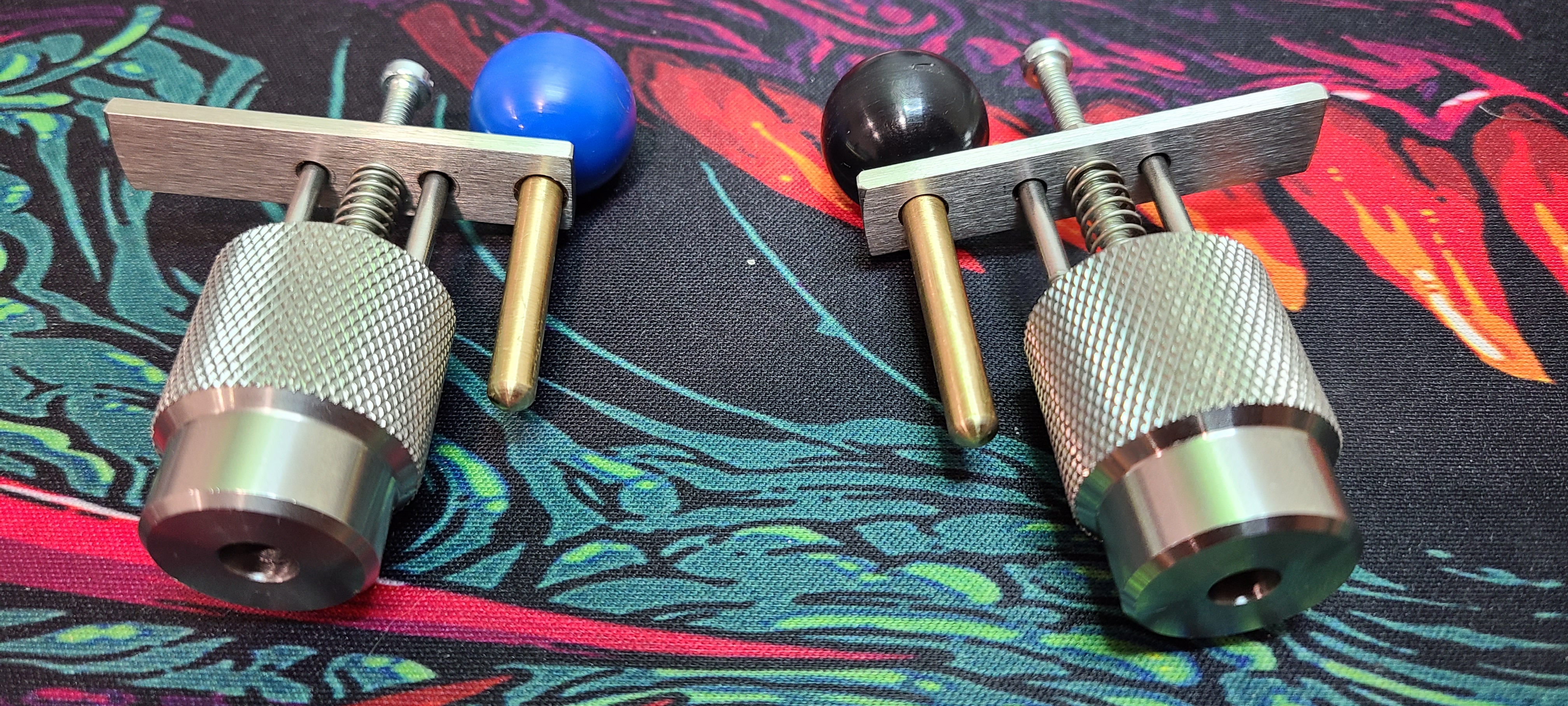

I was sorting pellets with that gauge for over a year long and I got tired of it. Invested into pellet re-sizers and I am good now ;)
Still wanted to improve these tools and became a real project to tighten the tolerances to my liking.
No more weight sorting or rolling or head sorting, all the pellets I shot into a paper I just resize the head all the same.

I need to quit procrastinating and order a tapered reamer to finish my pellet sizer.
bigHUN, what size reamer did you find worked best?
What is in the pictures is a tapered endmill, but the inch sizes were either large to fit into a hole or short flute. Later I ordered in milimeters 1.5 degree conical hand reamers from aliexpress and finished the job by hand. The re-sizers working well but still slow for the volumes I am capable of shooting :) . Maybe over this incoming Canadian winter I will catch some time to redesign, I will be sourcing to a local CNC lathe shop I meet the owner not long ago. I want to make also a re-sizer for my slugs as well.

What's the ID difference between each color on the Pelletgauge?
The gage plate incremental diameters differ by 0.01 mm, (0.0004 in), the Pelletgage has ten apertures, or a span of 0.09 mm (0.0035 in) from smallest to largest. Apertures are guaranteed within 0.0025 mm (0.0001 inch) of nominal sizes. They are checked with class X plug gages. Note that "gage" is the more widely used spelling for a physical reference tool. And, since quality pellets are historically European, the Pelletgage was designed with metric increments to match the way they are sold by those suppliers.
