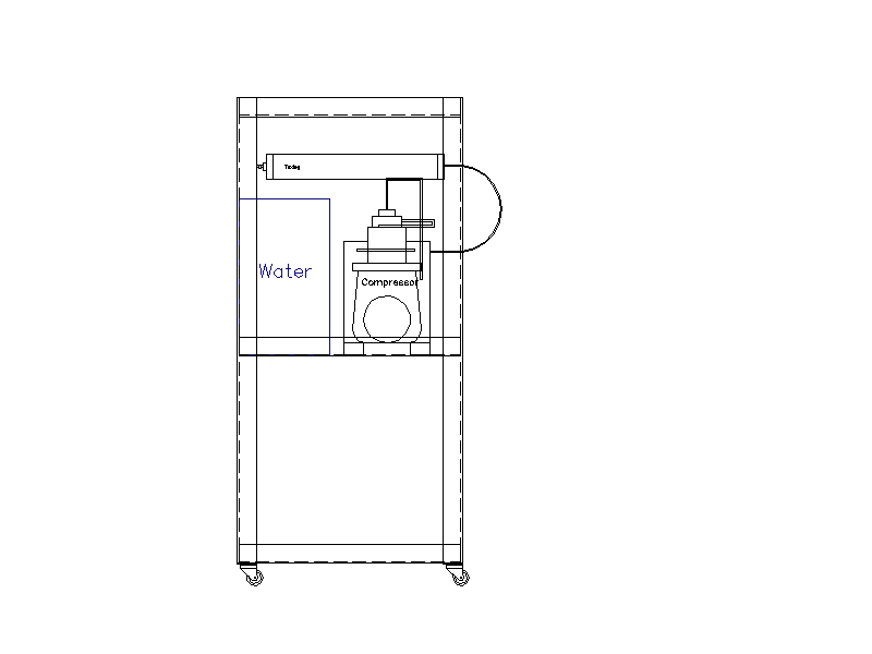

Hello everyone,
I am going to build a roll-around “stand” to hold a 5-gallon water tank, my Yung Heng compressor, storage space below, and a TUXING 4500Psi PCP Air Compressor Filter. ( see attached drawing ) On the top of the stand would be a “flat table” to hold my air tank or gun while being refilled. My plan is to connect the Filter direct to the Compressor via a high pressure hose and have a Foster Male Nipple on the “outlet” end. I have several questions:
1) Are there correct “inlet” and “outlet” ends on the Filter. No brochure came with the Filter and I only found a cutaway photo on the internet and it does not depict which is in or out.
2) On my drawing I am mounting the Filter above the “outlet” on the Compressor in order to eliminate as much water as possible from entering the Filter. Is this correct? Any suggestions for a better location?
3) Also I have the Filter mounted in a horizontal position, is this correct? Should it be mounted in a vertical position?
Thanks for the help,
ThomasT

You need the filter in a vertical position for it to be able werq properly. My Tuxing filter had no markings of any kind to say which was input and output lines. I just figured the desiccant should be on the bottom since it is going to be collecting all of the moisture.

Keep your moisture filters, guns and tanks being filled above the compressor to help keep the moisture out.

I plan to continue to use a good sized cotton filter first, before the dessicant. I am just using the filter it came with plus a housing filled with dessicant. I see what I think is oil in the filter after the pump has run a significant amount of time. You could accomplish the same thing with a cotton filter first in the one housing.

Hello everyone,
I found this youtube link about Tuxing Filters and if I am understanding ( the robot voice ) what they are stating, that the "intake" air ( from the compressor ) is on the end with the Carbon. This shows to be the end with the Foster male nipple is on and the "output" ( fill tank/gun ) is where the Hose is connected the location of the desiccant.
Hope this is helpful.
https://www.youtube.com/watch?v=6SjoTB4btJY

If you have a choice, use the top configuration. You don't need the carbon or the other stuff. The beads are the molecular sieve desiccant. That's the stuff that removes the moisture best. The carbon is just for removing odours. I don't think it matters which direction the cartridge is orientated but I would configure it with the O-ring sealed end on the outlet side. I think that they come with the hose on that end anyway. Mine is the older version that doesn't use a cartridge. A good idea is to salt the beads with a small amount of colour changing silica gel beads. That is a reasonable method of knowing when to change the desiccant.

Hello Eaglebeak,
I have already received the Filter and it is like the one on the bottom, along with one each extra material for a re-build later on. When it is time to re-order I can order the one shown on top as you suggested.
