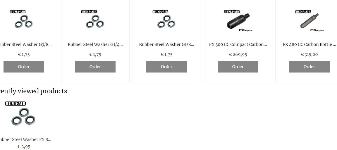

For those interested. I wrote to FXServiceUSA about the 'spacer' used on the Wildcat BT VP (placed between the valve and bottle) and this is their reply: "This is a Rubber/Steel washer (11507) and is a secondary sealing surface for the bottle adapter. All newer rifles have this washer for all bottle rifles." I suspect the part number is 11507 but no price was give nor reasoning for such an addition. Which among you will be adding this new part to your bottled FX rifles going forward? ChRiSiS has already put a carbon fiber bottle onto his new Wildcat MK3 BT VP and to my knowledge did not use the spacer. Any issues holding air ChRiSiS?

Did look something like this?
Then yes, normal, and one of the seals between bottle and valve. I have on my impacts. The steel washer is to prevent you from crushing the seal when tightening. It also is there to prevent high presure from blowing out the rubber seal.

No issues whatsoever!! It’s been nearly two months and no problems.
I don't think the 'rubber steel washer', part number 11507, is the piece I have been asking questions about. I will pull my bottle later today and take a couple of pictures showing what I am asking about. My main concern is if the part is functionally necessary or just utilized to add distance from the stock for the aluminum bottle. Wish FX would update their site with full schematics/ parts listing on the Wildcat BT VP.
