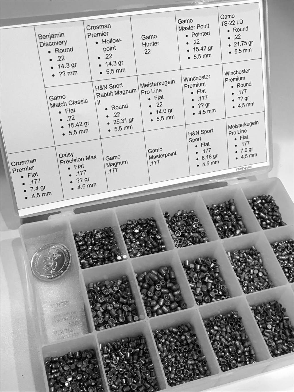

Made mine using a "floss storage box" you'd find at any hobby store. And 16-tins of ammo. :)
That's a nice setup!
