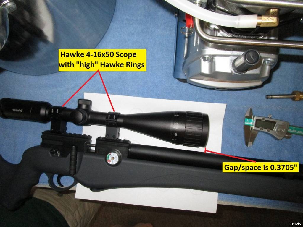

Hello everyone,
Will medium height Hawke rings mount a Hawke 4-16x50 scope?
Thanks for the help,
ThomasT
ThomasT
I had to use high Hawke scope mounts on my Hawke Endurance 6-18x50 because the mediums I tried made the objective bell touch the compression tube on my HW98. However, the mediums I tried were made by UTG and not Hawke. I don't know if there's a standard height that is considered Medium, but in this case high scope mounts had to be used.
Hawke tactical 2 piece medium 30 mm rings leave less than 1/8" clearance for the objective lens with a Hawke 4-16 x 44 mm compact scope with a 2"/51mm objective. The 50 mm objective Hawke scope has a size 2.2"/57mm objective lens. I believe that you will need high rings.

I hope I remembered this right because I just ordered a set of medium, but On GTA another member has a 4x16x44 with medium rings and he has 1/8" clearance. So I'd say with a 50 you'll need the high rings.

Hello Deerstalker,
Thank you I will order the high rings to be safe.

These are the Hawke rings that I believe you would need & I recommend this style. https://us.hawkeoptics.com/tactical-ring-mounts-30mm-2-piece-9-11mm-high.html
Hawke 50 mm scope & rings are; 2.5”/63 mm scope objective for 50 mm, 1.4”/35 mm high rings for half height and 1”/26 mm medium rings half height. I believe that Hawke medium rings would NOT work for your scope as the Objective lens would touch by about .1",reference, https://us.hawkeoptics.com/mounts.html
