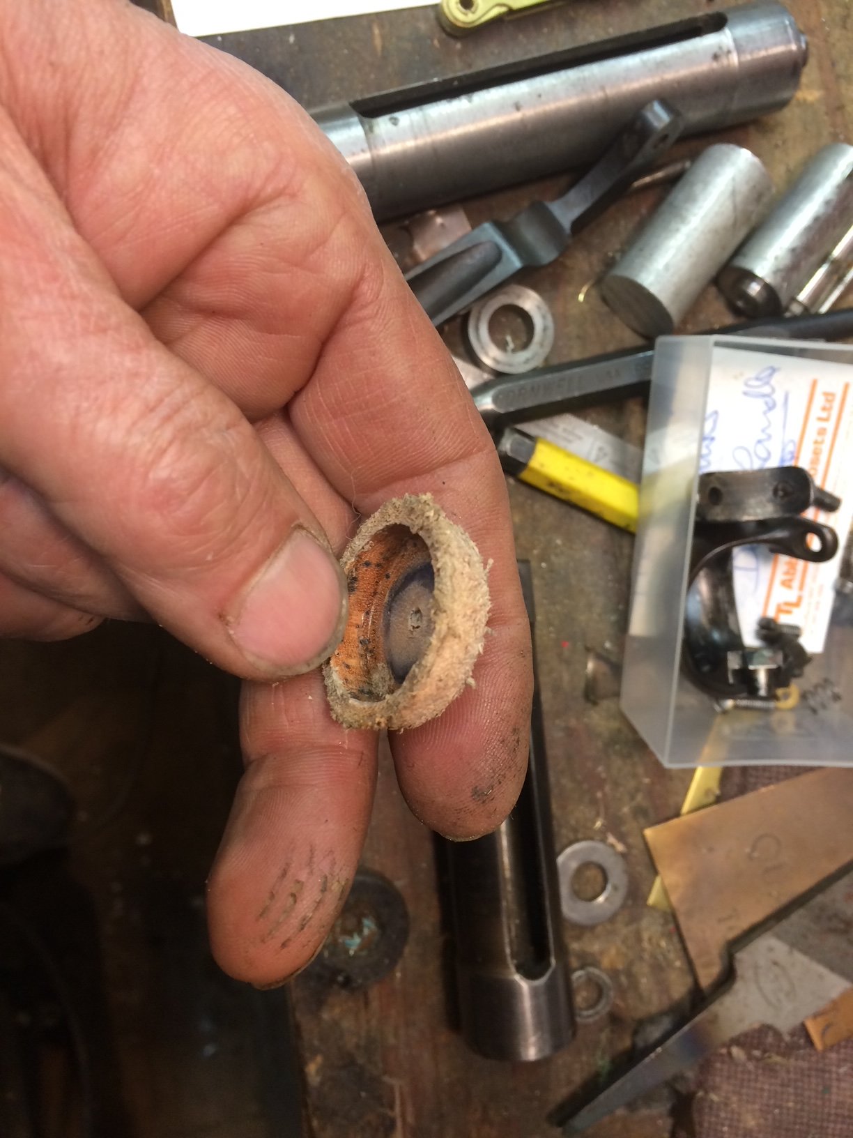

Yes, the leather seals are not as effiecient as the synthetic seals, but they are more forgiving. Back in the day, I have massaged many leather seals back to like new, where a synthetic seal would have to be replaced.

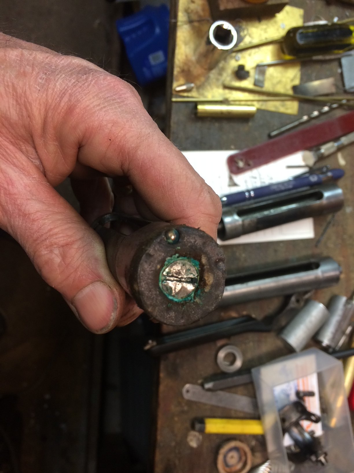

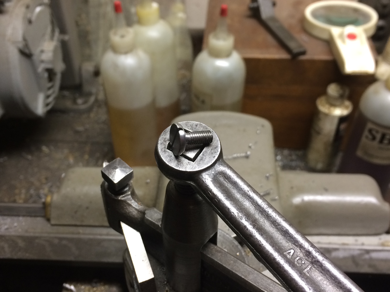

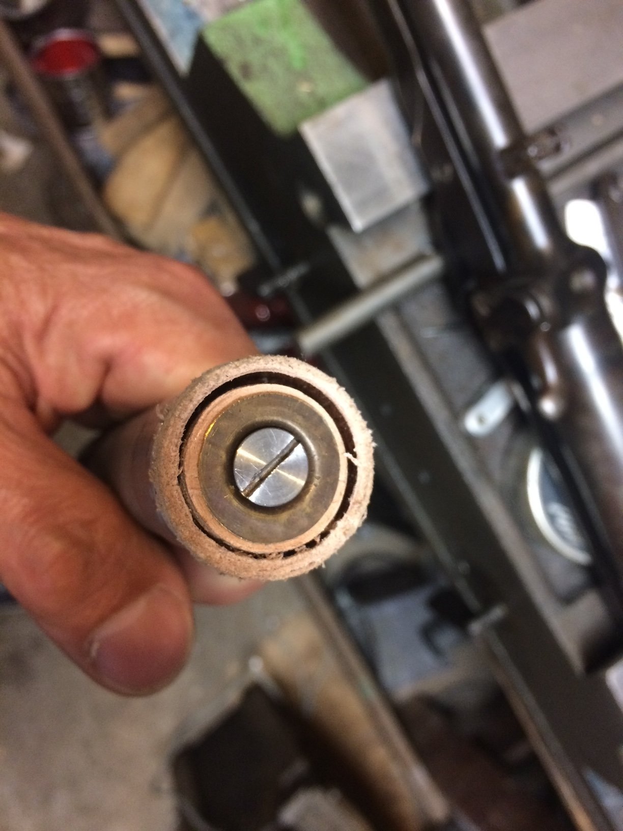

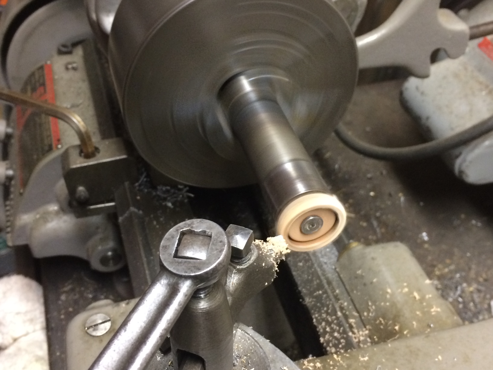

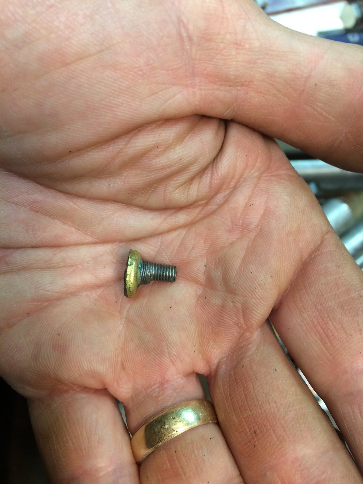

I make my own leather seals. And single pointed a new screw. Then made the brass washer too. Many times. The thin brass washer has to be formed and hardened. For prewar BSA rifles. A percentage of the .22 caliber BSA's will have a BB embedded in the old seal. Or who knows what you may find in there including cut up nails.
View attachment 414398View attachment 414399View attachment 414400View attachment 414401View attachment 414402View attachment 414403
Great work Karl. How much oil do you put a leather seal and is it silicone base ?
