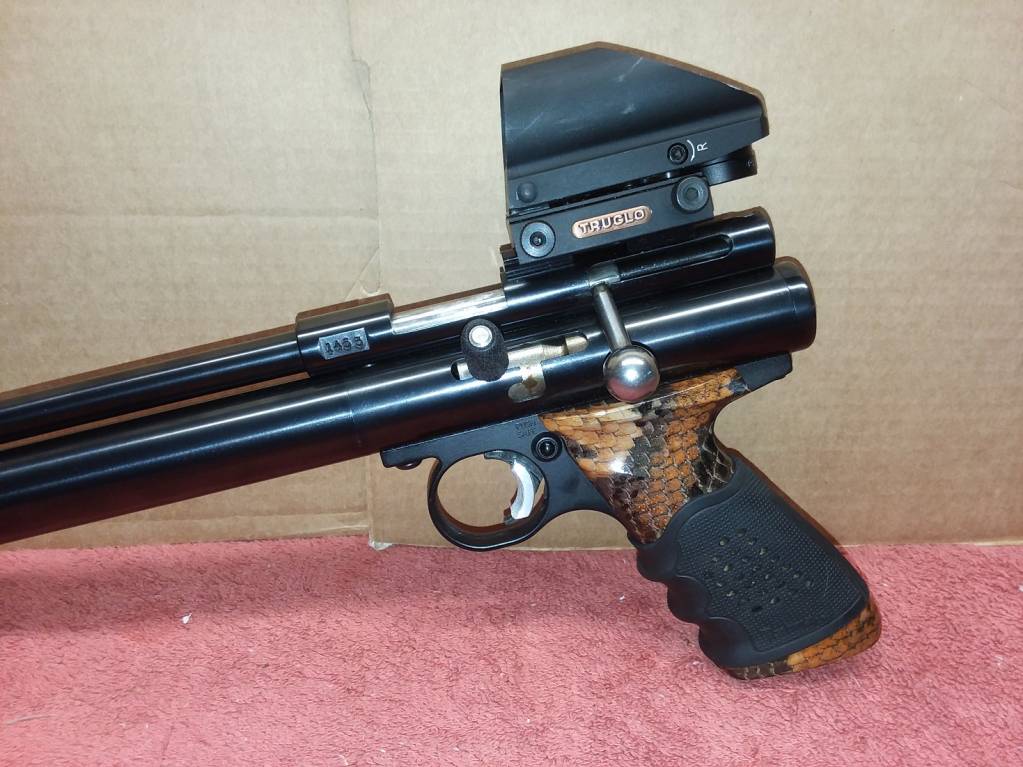

Having a heck of a time getting it sighted in. I pumped it to 3400-3600psi a few times because I had seen folks on Youtube go that high but then I kept finding loose screws. The piece that holds the barrel and reservoir together, near the muzzle, came completely loose at one point. After that, I noticed other loose fasteners. So I've only been going to 3000 which is the official pressure.
I've been using loctite and trying to get everything snug, one bit at a time. Every time I think I have it all tight and zeroed in, the next time I get the gun out it has not held zero. I have a SeeAll sight on it. Any tips on this or your favorite zeroing techniques are certainly welcome. I've read a few articles but this one is certainly a challenge.

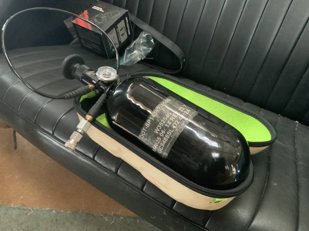

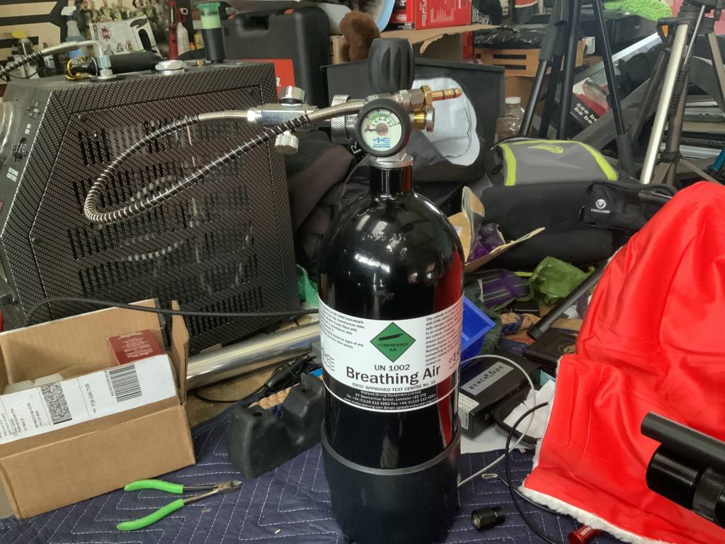

You need a guppy tank and a friend with a compressor! I tether off an old paintball tank

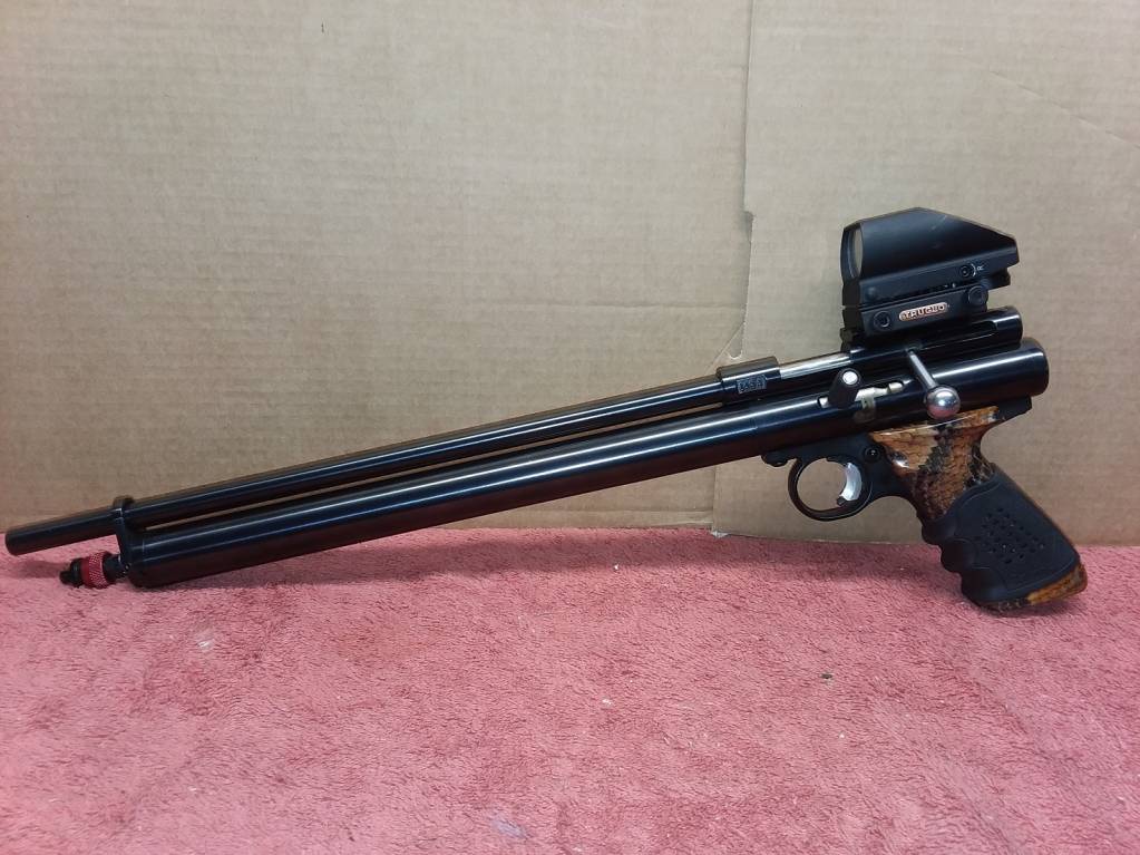

Quackenbushes are set up to achieve maximum power, hence way oversprung (hammer-springs) for consistency. In tuning my .50 Outlaw pistol I ended up cutting over 1.5" length off the hammer-spring in order to get a consistent powerband. Thusly "tuned", you might get 3-4 CONSISTENT shots per charge.
In my opinion you should remove the barrel-band, and get a tank to charge the gun. Pistols are plenty challenging enough without having to pump the thing up to get a few shots at diminishing returns

I like the tank idea. I suppose that even if I have to charge the tank by hand, I can do that in my office a little each day, then when I got out shooting I can just focus on shooting.
So, remove the barrel band? So that piece is unnecessary? I like that idea too. The barrel can just free float at the muzzle end? I never even considered that. I have been suspecting that when I tightened that band down I didn't get it perfectly straight and the barrel might have a slight bend to it. I much appreciate the feedback. Thank you.

In my opinion barrel bands are a horrible idea on PCPs, and can't believe they still exist.
I'll second that. Attach the barrel to a pressure vessel that expands, moves, and shrinks depending on PSI.
Also what was stated about the gun being set up for max power is true. The valve basically dumps air. It is not set up to be balanced or efficient. Only powerful.

I would recommend taking one of these approaches. 1) tether to a larger tank (ideally a tank regulated at 2500-2800psi) and sight it in. or 2) Tune for a bell curve prior to attempting to shoot targets and sight in.

I have not acquired an external tank yet - but I took Mackerall suggestion and tried sighting in at a constant 2800 psi for each shot (this meant 30 pumps between every shot - not terrible...I actually liked the rhythm better than pumping 120 times every four shots.)

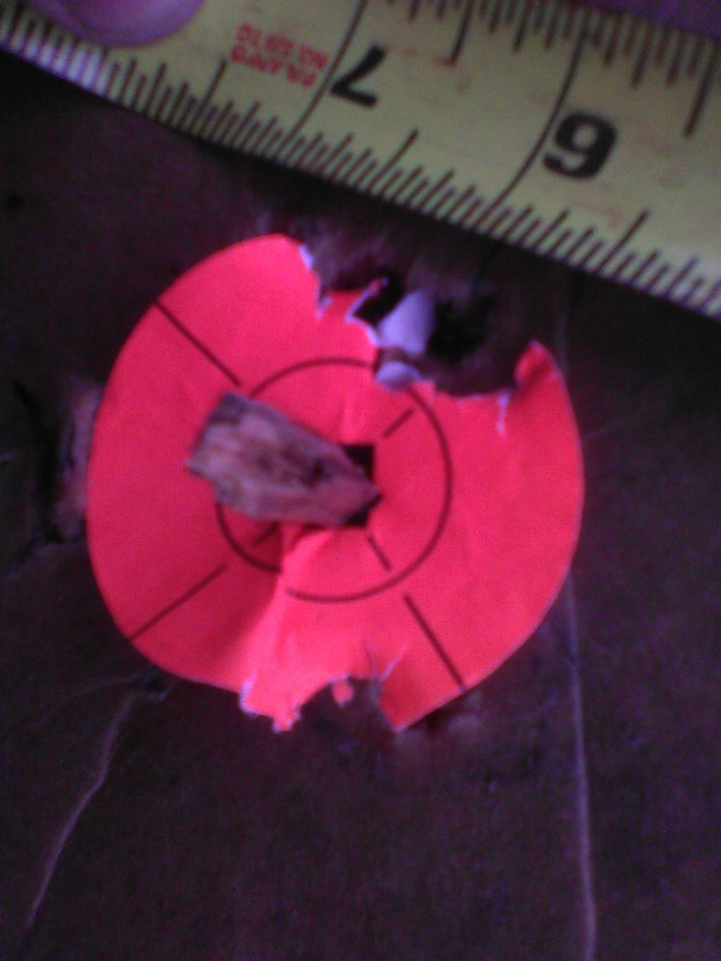

This, combined with the removal of the barrel band seemed to work wonders. I was actually able to sight-in. The three shots on top were consecutive shots from 25 yards after finishing the sight-in. Won't win competitions but I had started to wonder if this gun even could be accurate so I was very happy. The tips worked!
After that I had some fun and set up a beer can and the 2" center of a clay at 35 yards. Nailed both on first shots. Last time I went out I couldn't get this gun to hit anything at any distance.
The question now is whether it will hold zero. I am going to go out again in a week. - G
