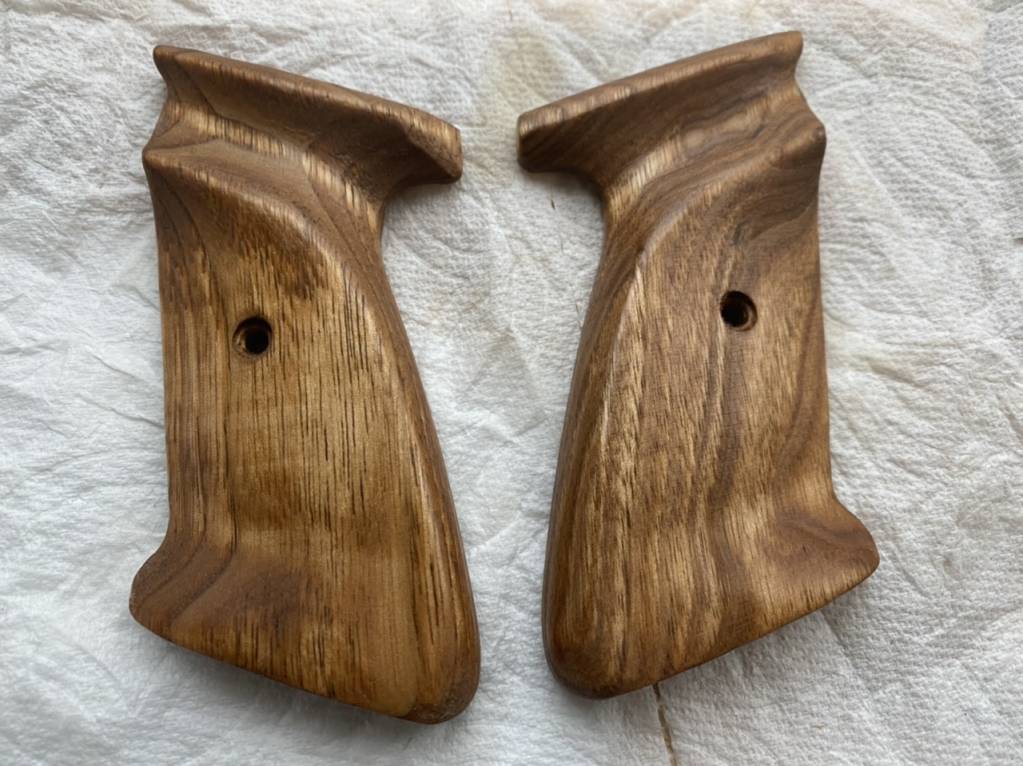

Been shooting the 1701P indoors exclusively for a while now and absolutely love it! At the current rate it probably will stay as the indoor lead free 5 meter pistol for as far as I can see. Order a ready to ship wooden grip from eBay as I wait for the fancy on but even that’s taking forever to make its way across US. Oh well, nothing I can do but wait. At least I still really enjoy some indoor shooting which I never considered before wasn’t for this forum.

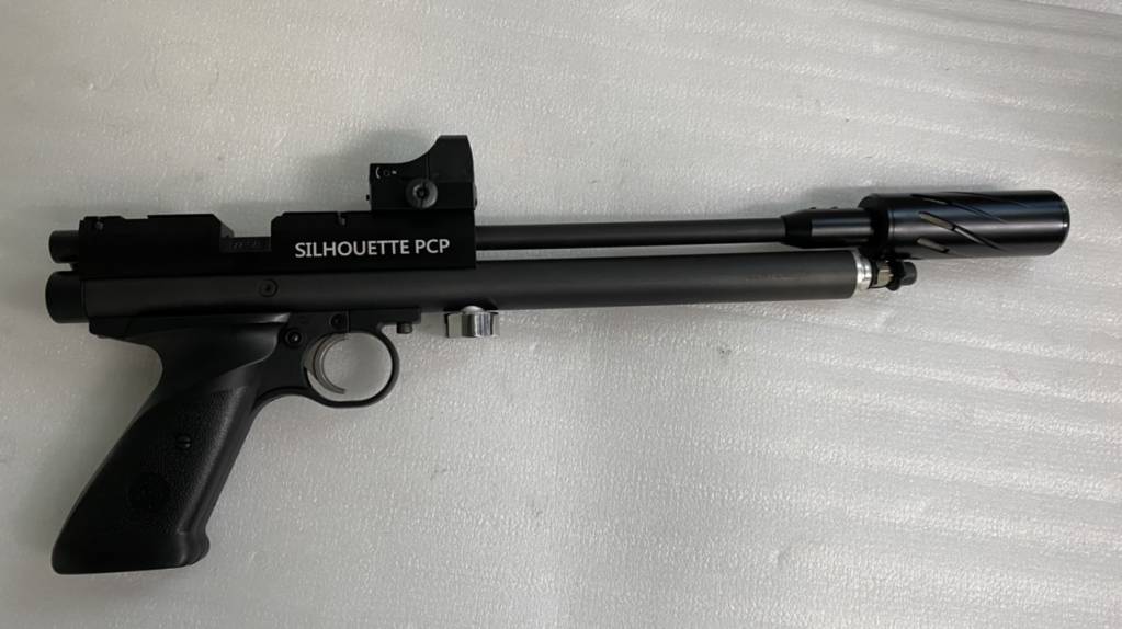

Some of the goodies finally showed up. First a plastic/3D printed slip on moderator for the 1701. It fits perfectly and weight only 25 grams with a fiber optic sight!!! Tried it on and it’s about the same quietness as the atom!!!!!! The atom and the adapter are about 3.1 oz but the new slip on is .8 oz!!! With the same sound performance AND so skinny the factory filler cap can go back on AND I can air up without taking off the moderator!!!! WOW!!!

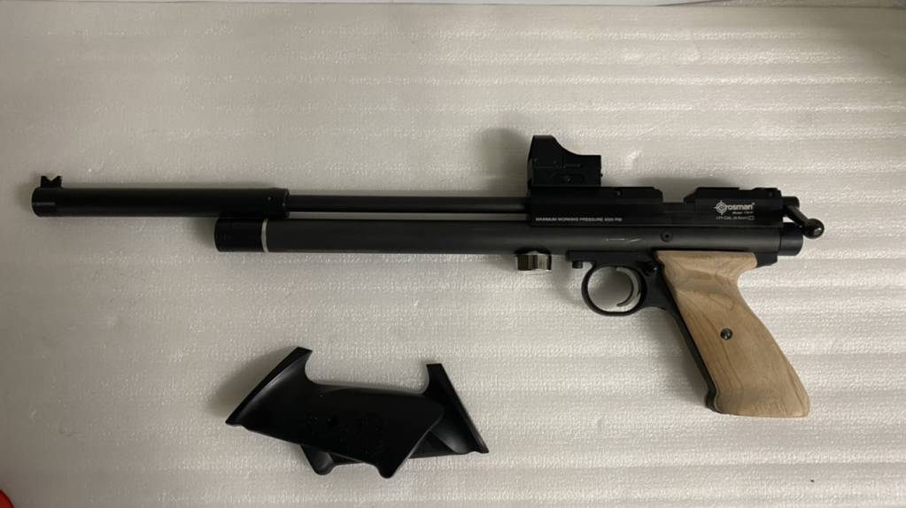

also the eBay grips showed up, it supposed to be ready to be finished but it’s a bit rough and ergonomics is better than OEM, good enough where I don’t want to go through the trouble of sending it back. I would not buy it again! I finished the surface with 00 steel wool and now soaking in my wood floor oil which is part Linseed and cedar oil.
questions: how long should I soak it in oil and which rear sight should I look into?

the moderator actually worked better than I thought it would! I can totally feel or don’t feel the weight up front and definitely changed the balance for the better! As far as sound goes it’s almost on par with the huggett atom at 3x the weight and 4x the cost!

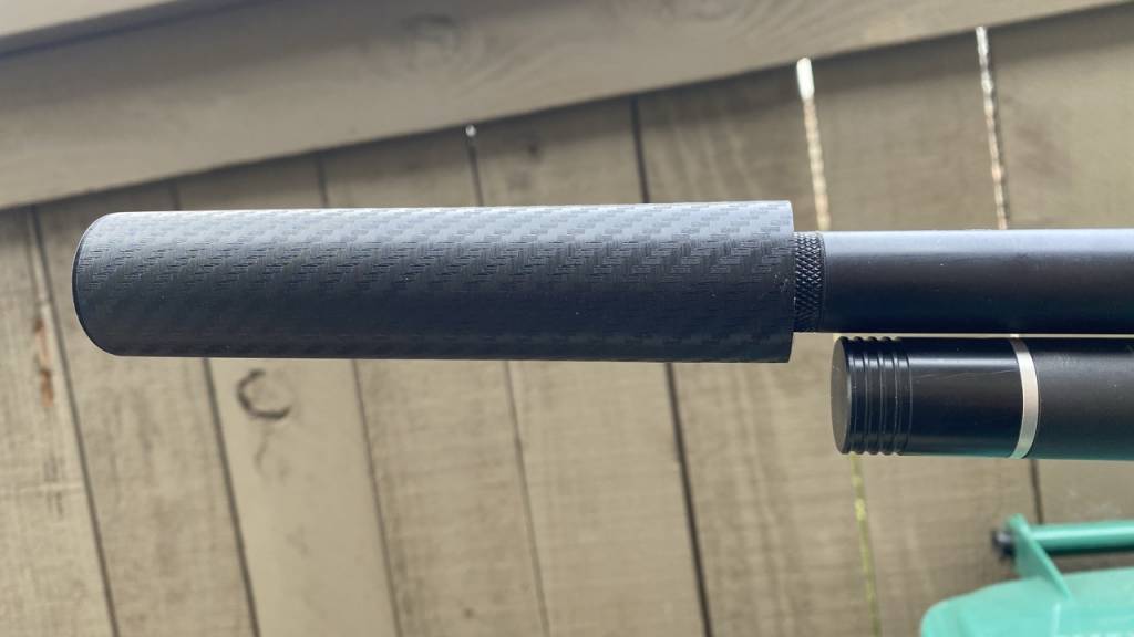

I also ordered the thread on version(1/2 unf) and it is under 2 oz!!! And works surprisingly well on my 1720T which also allows airing up without taking it off!!! It has plastic thread so I’m leaving it on for a long while! Keep in mind the 1720T is 7 FPE and 1701P is 2.5 FPE so plastic moderators are more than adequate, I wouldn’t put them on anything over 12 FPE.

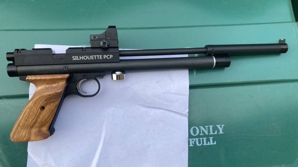

Thanks for the suggestion, I was thinking of going that route but I kinda torpedoed my own plans. On the 1720T I installed a huma regulator and the 1720T high power port, HS on low and super consistent at shooting 7.3 crosman pointed pellets like laser @650FPS so I am NOT touching it......for a while. LOL! Also I am currently very happy with how the 1701P shooting now, 410FPS with lead free pellets so I basically dedicated the 1701P to be the indoor leadfree gun. With the super cheap and light plastic moderator I got from airgununivers.net which I found through you fixed all the original problems I was trying to fix with the longer barrel. My filler cap is back on and I can fill the gun without touching the moderator and the bonus is the gun doesn't even feel like it has a moderator on! Huge thanks to you on that moderator! The only thing I'm waiting for now is the target pistol grip from Vernon Austin and I might actually leave it alone for a while.

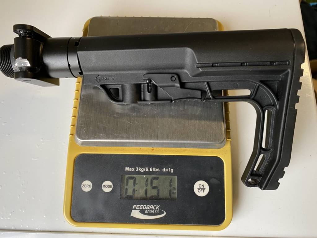

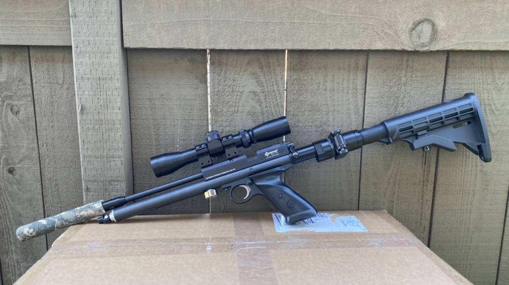

BTW the airgununiverse.net moderation is absolutely awesome on the 1701 because it's sooooo light! I'm playing with some ideas in my head with carbon tubes as carbine stock, even though I have the foldable stock adapter and everything else coming but I really don't like the extra weight so will see what kind of stuff I manage to rig up. Even at 480fps it's deadly accurate and need a good scope! I was wrecking house sparrows at my feeders out to 34 yards, can barely see with my POS scope but still manage to get 2 and both pass through with crosman pointed pellets, and it's stupid quiet at that power level. Another good thing with such low power is when I hit the bird it's a soft pop instead of the normal loud pop, the other birds don't seem to get spooked by it but I missed the second one to which I blame the scope. LOL!
This thing is just way too much fun!

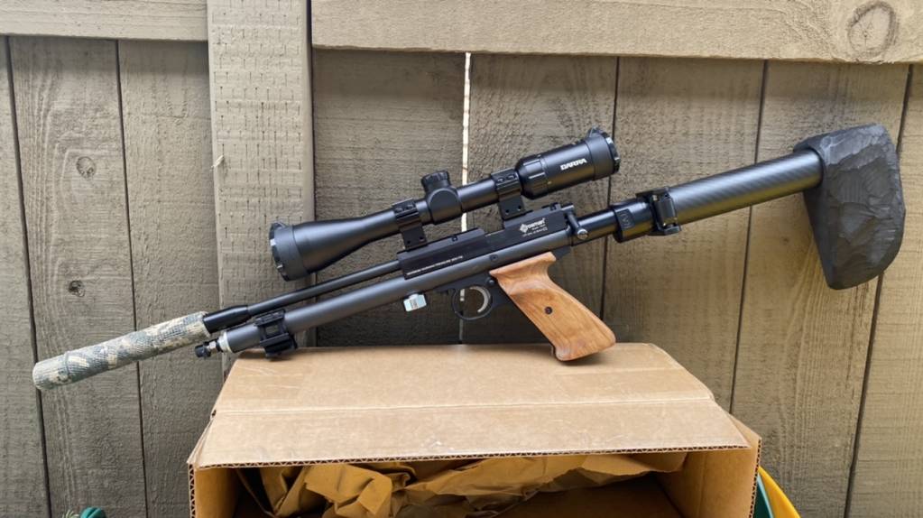

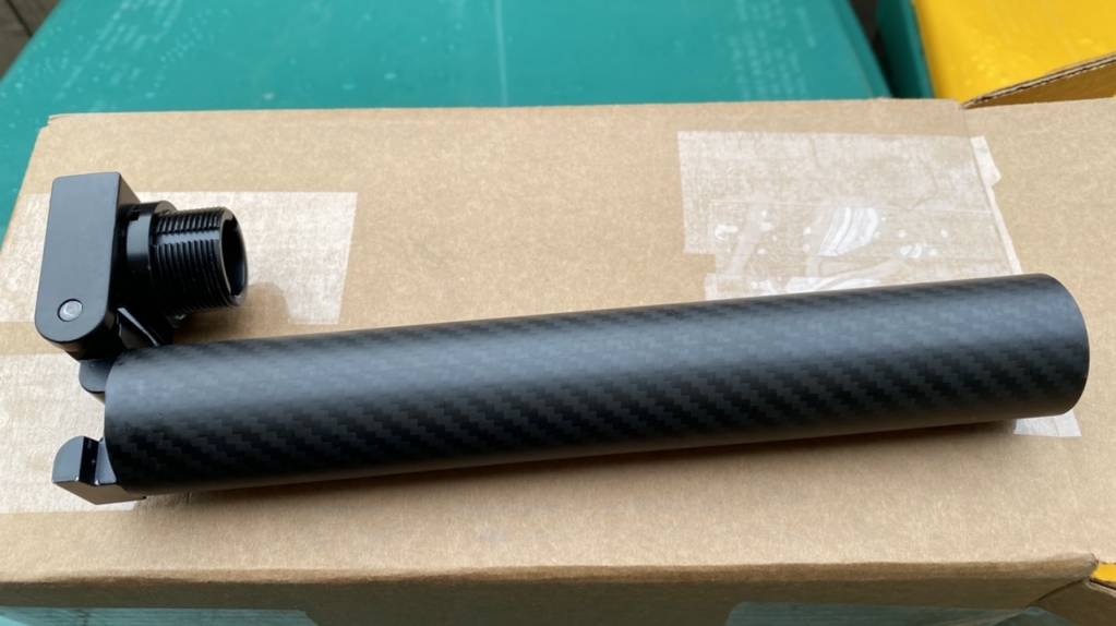

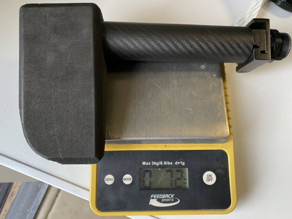

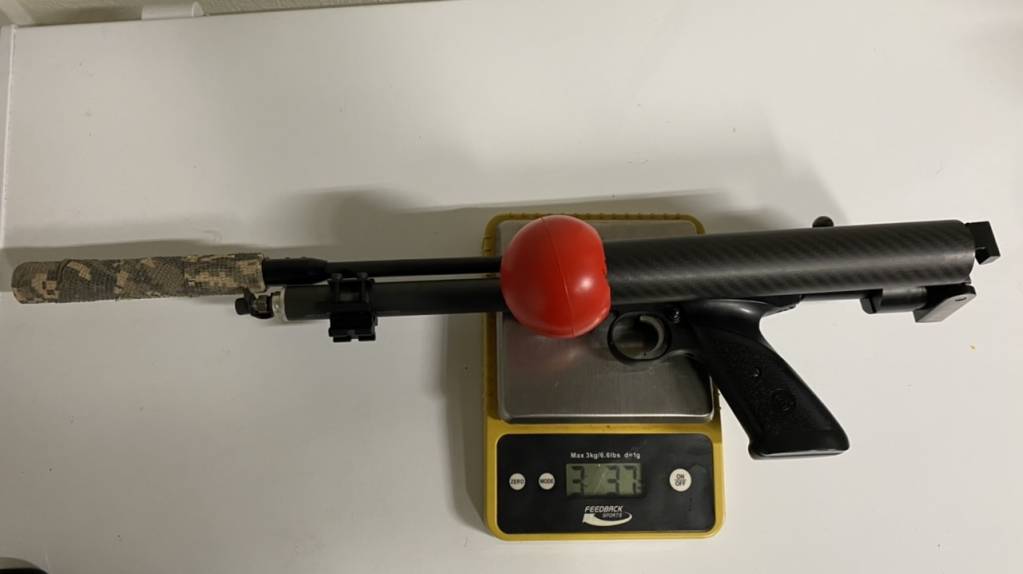

Tried a new scope and really isn’t cutting it but still better than the cheap pistol scope I had on it. Also installed my home made carbon and foam stock. Really light and quite comfortable except the carbon tube transfers all the vibration from the hamper so need to cover it with a patch of foam.
it is a lot lighter than the 1720t I have but that’s getting a new wood stock so not sure if it will weight more or less with the new stock.
Looking good! Got an air universe LDC on the way (tracking says it is in town and should be here yesterday- ahhh the USPS). Had to do some running around yesterday so I forgot to call CRosman for some parts. Got some kerosene for the garage heater so gonna work on the grips a little more (after I finish rebuilding the Crosman 101). I found a scope I like but it has very little eye relief so I guess it is back to the drawing board for that. Started working on a stock for it too. This project is never going to truly end.
