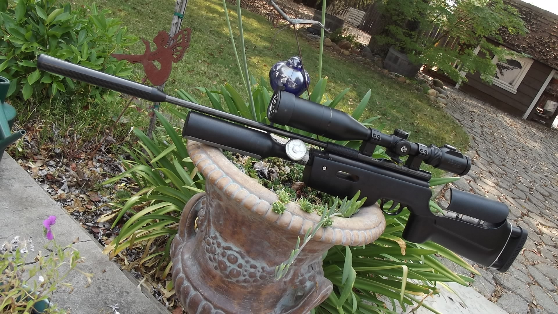

Pretty cool! I have a Tim McMurry modded QB78. I wonder if the ninja reg would work with that?First is finding a QB-79 in .22, as there no longer generally available
Then you add a Ninja regulator set at @ 1100-1300 psi ( No higher ) with a 13 or 22 CuIn bottle & Wala you have a PCP![]()

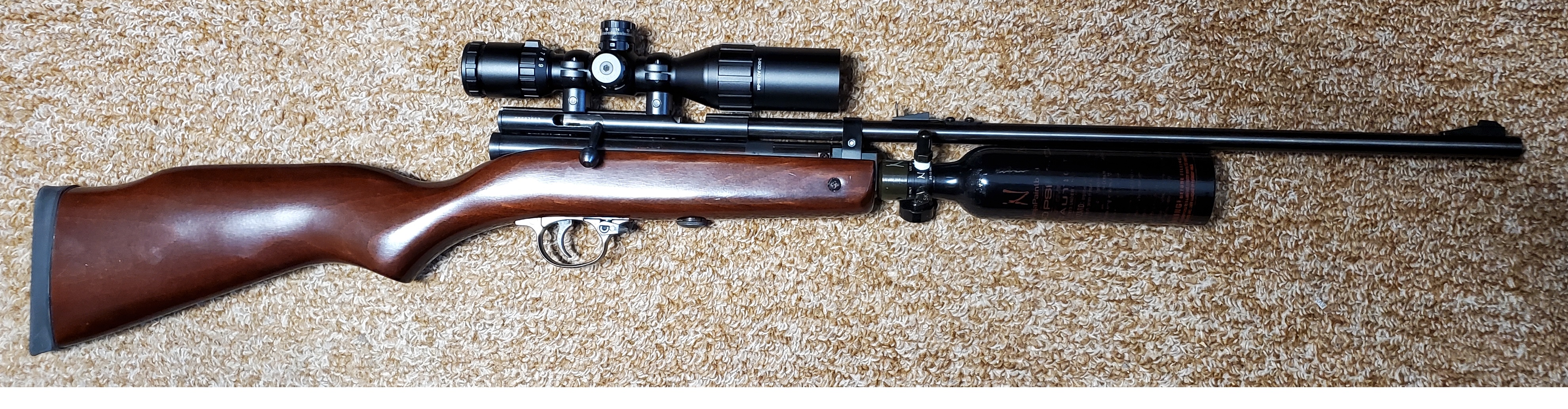

When you think about it though, aren't most modern airguns actually HPA? It's just a matter of which bottle and regulator are being used and where they are located.I had one with a similar regulator and offset adapter. I enjoyed tinkering, polishing and fitting parts.
Not to be nit-picky but isn't a QB HAP not PCP?
Yes, Nina paintball. Essentially you are building a singleshot Gen 1 Gauntlet.Pretty cool! I have a Tim McMurry modded QB78. I wonder if the ninja reg would work with that?
