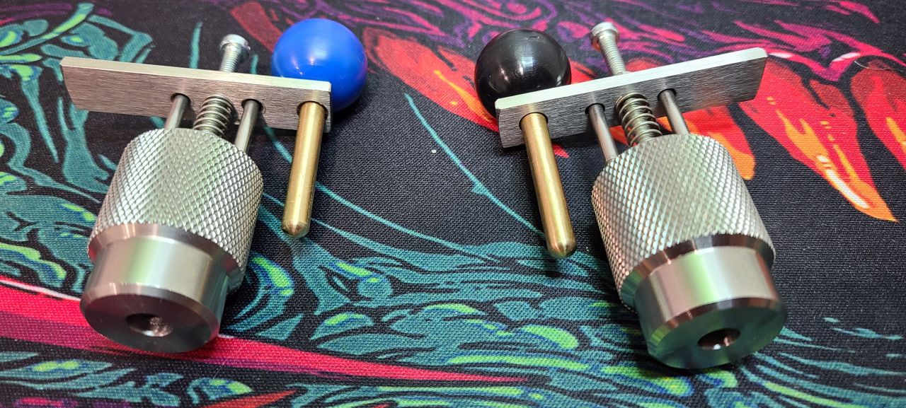

I received recently my two Trrobb pellet sizers in .22 and .25.

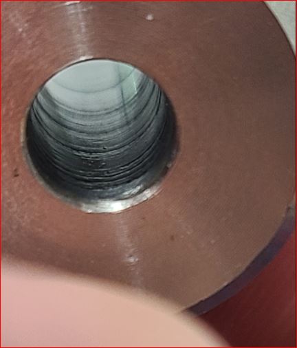

The smaller is kind a OK finish on the cone, but the larger .25 is a disaster. This thing cannot work like that.
This conical hole cannot polish, this needs to recut.

So I toke this piece to a friends machine shop yesterday and not good, toke it back today again until we butchered it now the hole got way too large = not for .25 anymore.
So I will be making a new part on my micromill tomorrow.

The problem with most sizing dies is that the entrance is chamfered and needs to be radiused.
