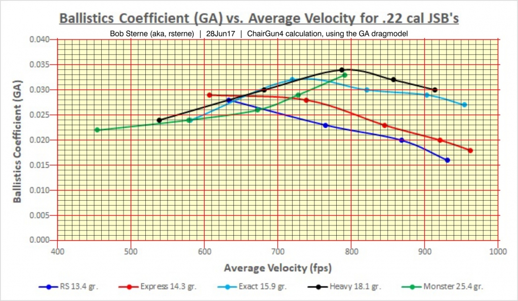

Kezselby,
there have been a few that published data of variable BC's (really, variable drag....).
Here's one by Bob Sterne (@ GTA) for JSB's domed line in .22cal:
If you're shooting that far out and the Strelok data don't get on on target, there could be a host of reasons, with a wrongly static BC being just one....
