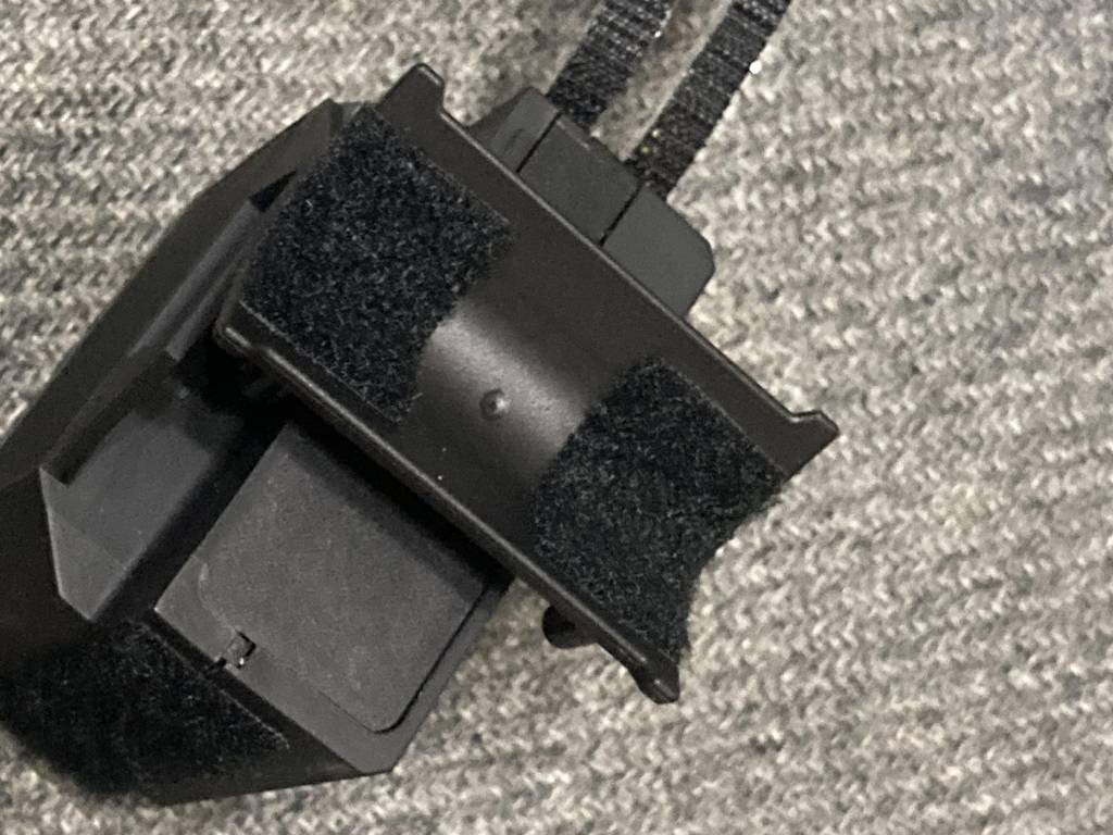

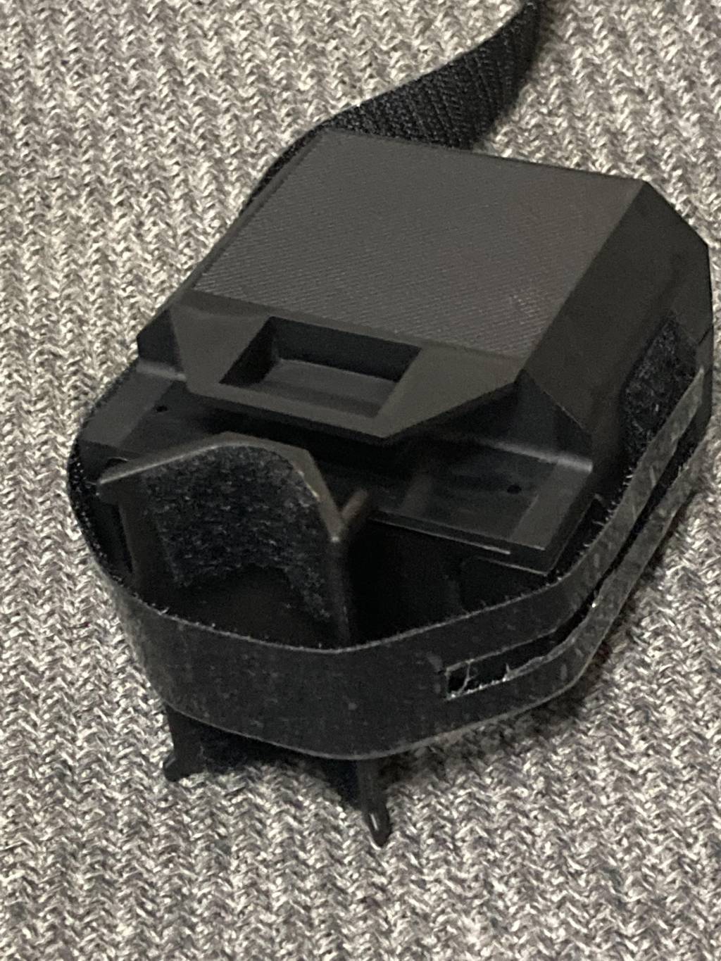

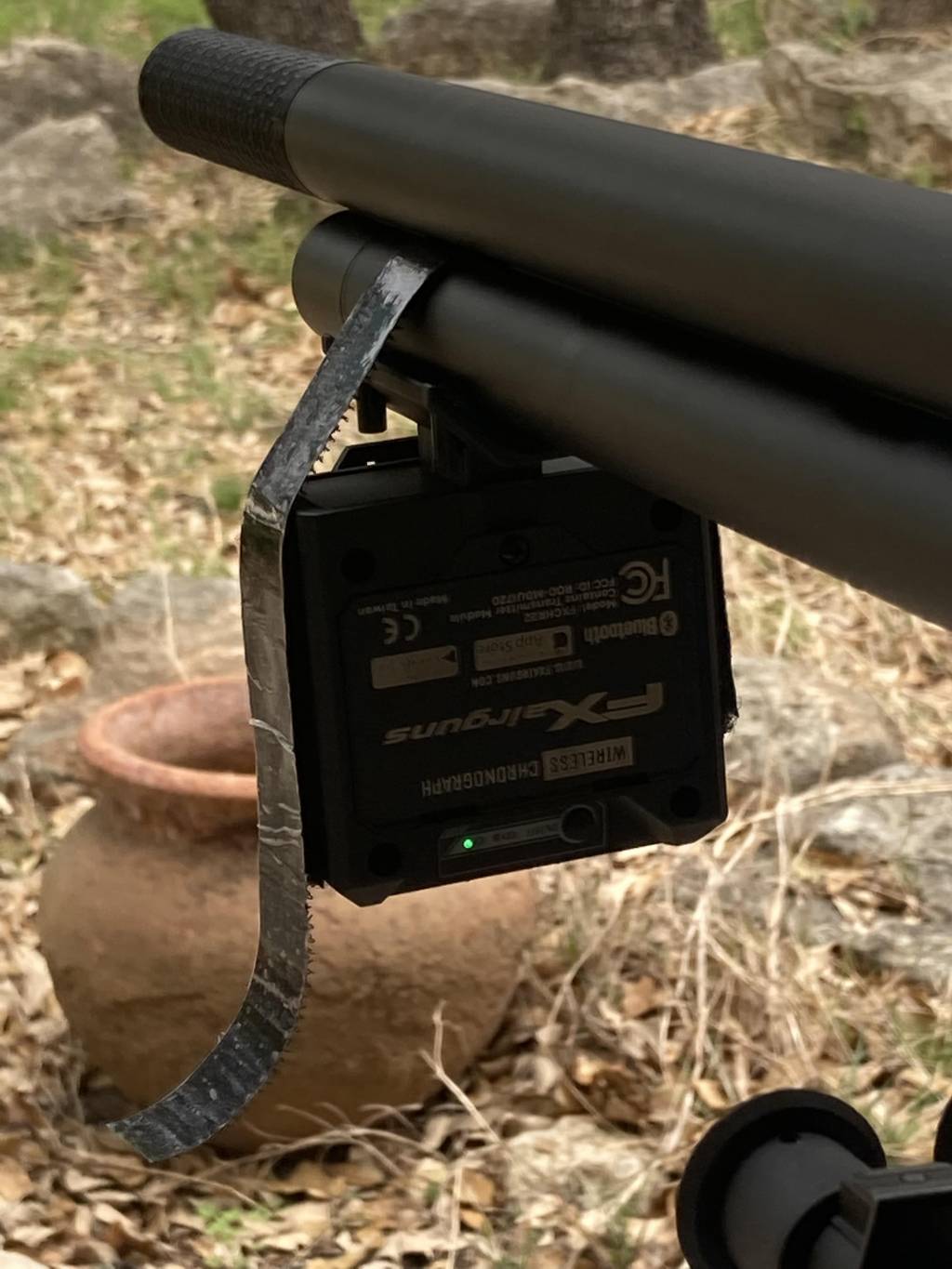

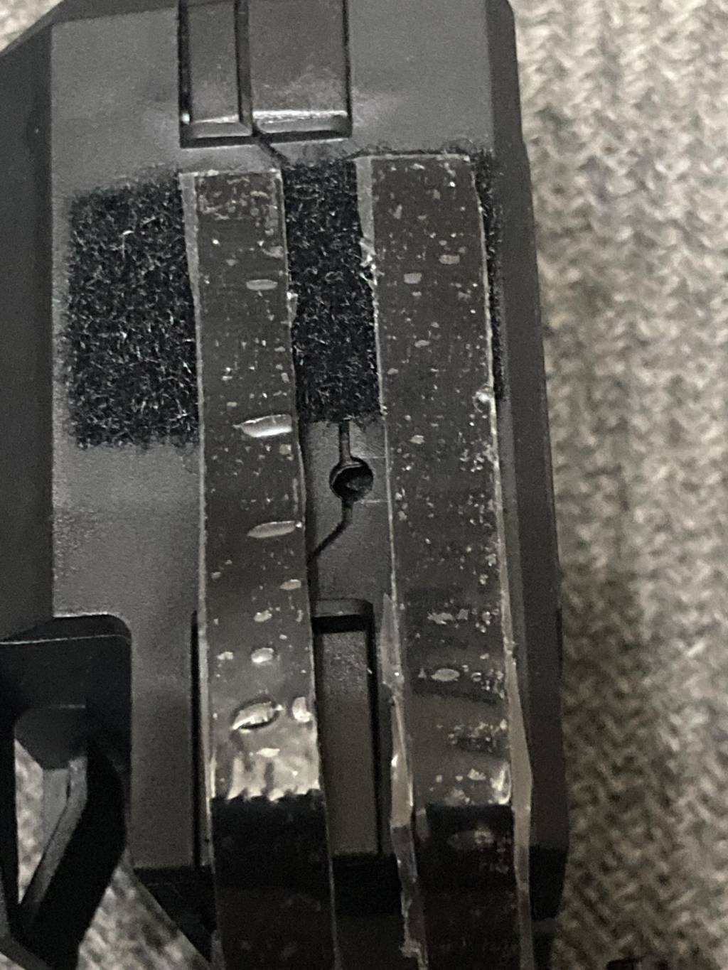

I just put an F X Coronagraph on an Avenger with Rubber Bands it caused the Pellet to
hit 1.5 inches low
So I mounted it with Velcro problem for me was solved see Photos
Larry ( New Member)
