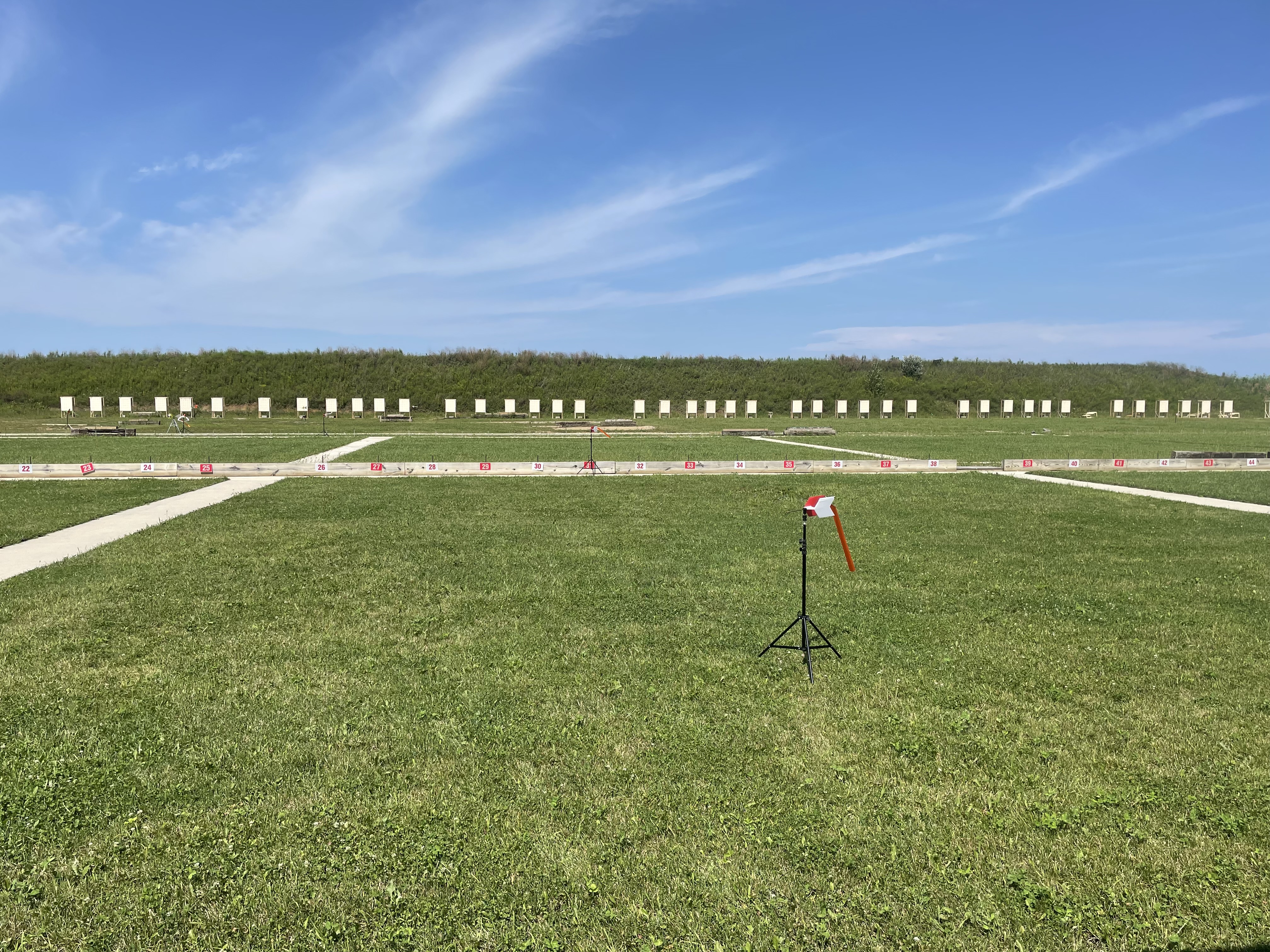

I was having a hard time visualizing (if I was at the bench ) holding on my 9 o'clock on my left bull, and actually having any chance of hitting my adjacent ( right ) bull with the wind. My holds are with relatively low winds at 100 yards, and I don't even go if they exceed 5-10mph. I have tried in the past with winds past 5 mph, and it's almost a waste of time. But, when you are at a bench rest event like PAC, RMAC or EBR; you can't change the weather. :)
I suppose you had to take a few sighters first to figure out your hold? Approximately how many inches were you holding to the left? Looks like it was 8 inches or so. Geez - makes me appreciate my low winds here in NC.
