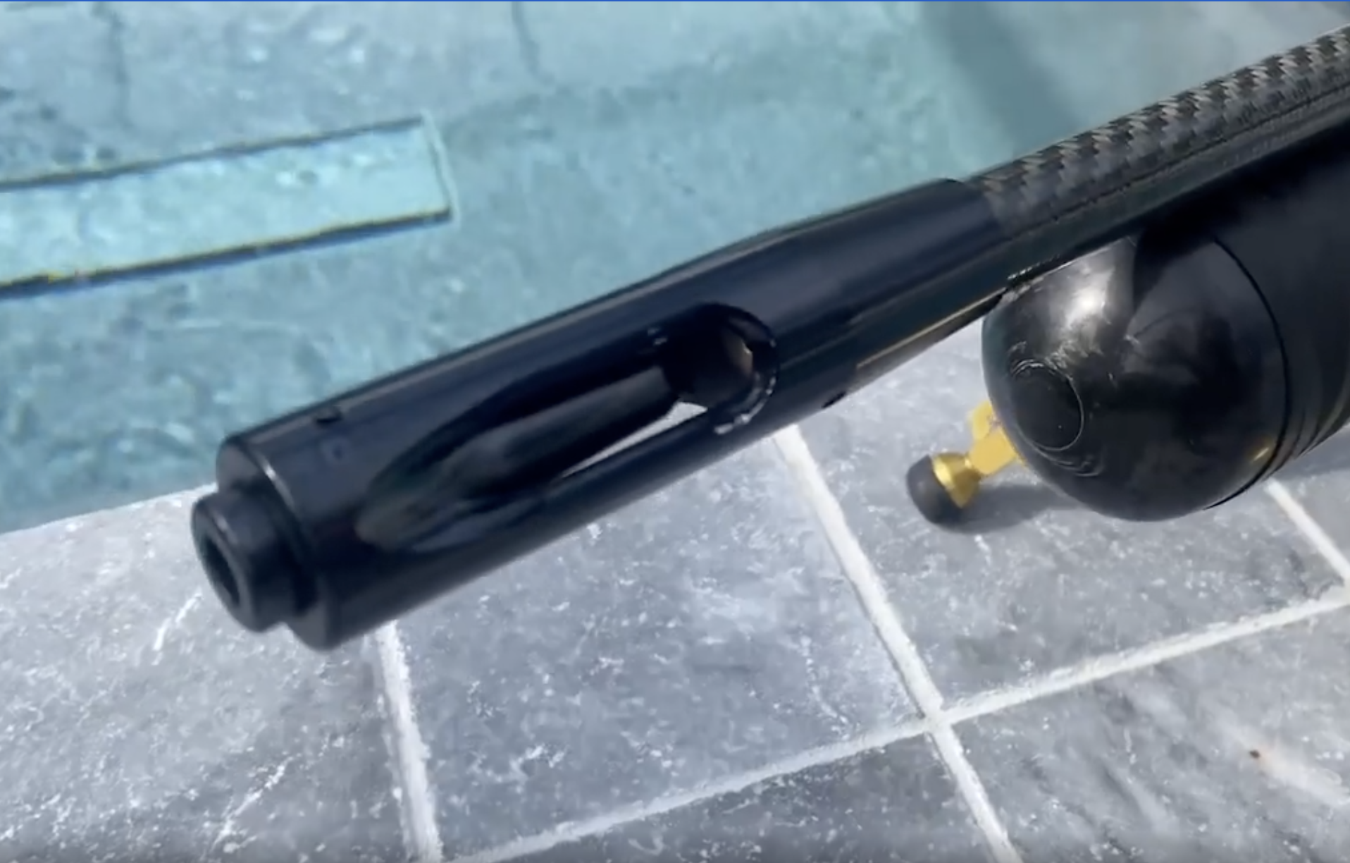

      Even better than the use of no moderator, would be the use of an air stripper with no moderator. Which essentially removes the turbulent air from in front of and behind the projectile.
