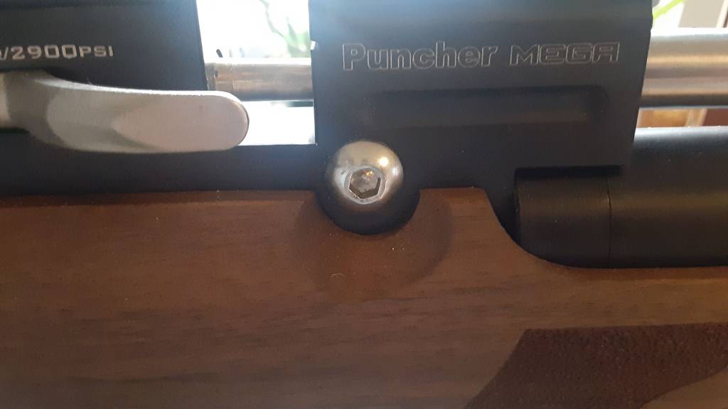

I have no use for the power wheel and replace all mine with 1" SS 5/16-18 cap head screws from Home Depot. They work perfect. I remove the existing power adjuster and ream and tap the hole for the bolt then install it and drill the transfer port size I need. For 25cal I like 13/64" and can produce in excess of 70fpe but typically run 55-60fpe with the JSB 33.95 JSB.

I’m guessing you tap both sides of the action and thread a cab screw into each hole and have a gap between then bigger then the transfer port size?
No, the bolt is 1" and fits flush with the other side of the breech. Goes all the way through then drill the transfer port down from the top through that bolt.

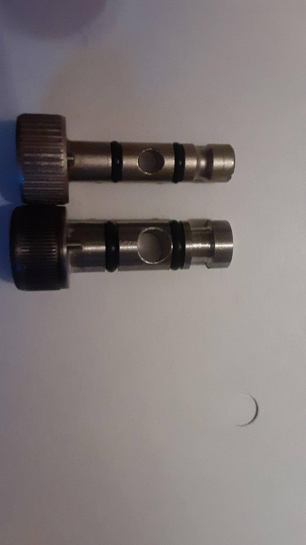

Why not keep the power adjuster and replace it with a larger diameter allen bolt ? E..g. 8 mm easily allows a 5.5mm transfer port. I made one, the only tools used were (my limited) brain, some patient measuring, a power drill, an iron saw, file and fine grain sandpaper ...
I am trying that out. Picked up some grade 12 8mmx70 Allen head bolts and turned one out. Looks like it will work very well.
