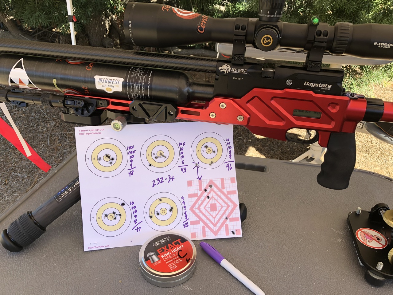

Daystate PRS Chassis for Redwolf with FORM Furniture Kit
Anyone else have the PRS Chassis for their Redwolf ?
I had a PRS Chassis two years before with Steve Corocan furniture but the rig was too heavy for Hft
I am setting this .177 Daystate Redwolf HP model up for 25 M and 50 M Bench Rest because this "particular barrel" is VERY accurate.
I put my Sightron S6 on this rig until they let Hft people use more X
Once I validate a couple of 50M BR cards on a no wind day, I can decide exactly what this gun / barrels purpose is in life.
If its BR, I'll change the 300 air bottle to a 480 or 540 or 720.
The chassis furniture is made by FORM, I haven't installed the FORM cheek piece or palm riser.
Notes:
if anyone is wondering about weight differentials, the PRS stock will ADD 2 lbs to your Redwolf; the lightest Redwolf stock is the walnut, then safari then the laminates. The UIT / Arca rail extension under the bottle is 12 oz by itself.
Anyone else have the PRS Chassis for their Redwolf ? I had a PRS Chassis before with Steve Corocan furniture.
Notes:

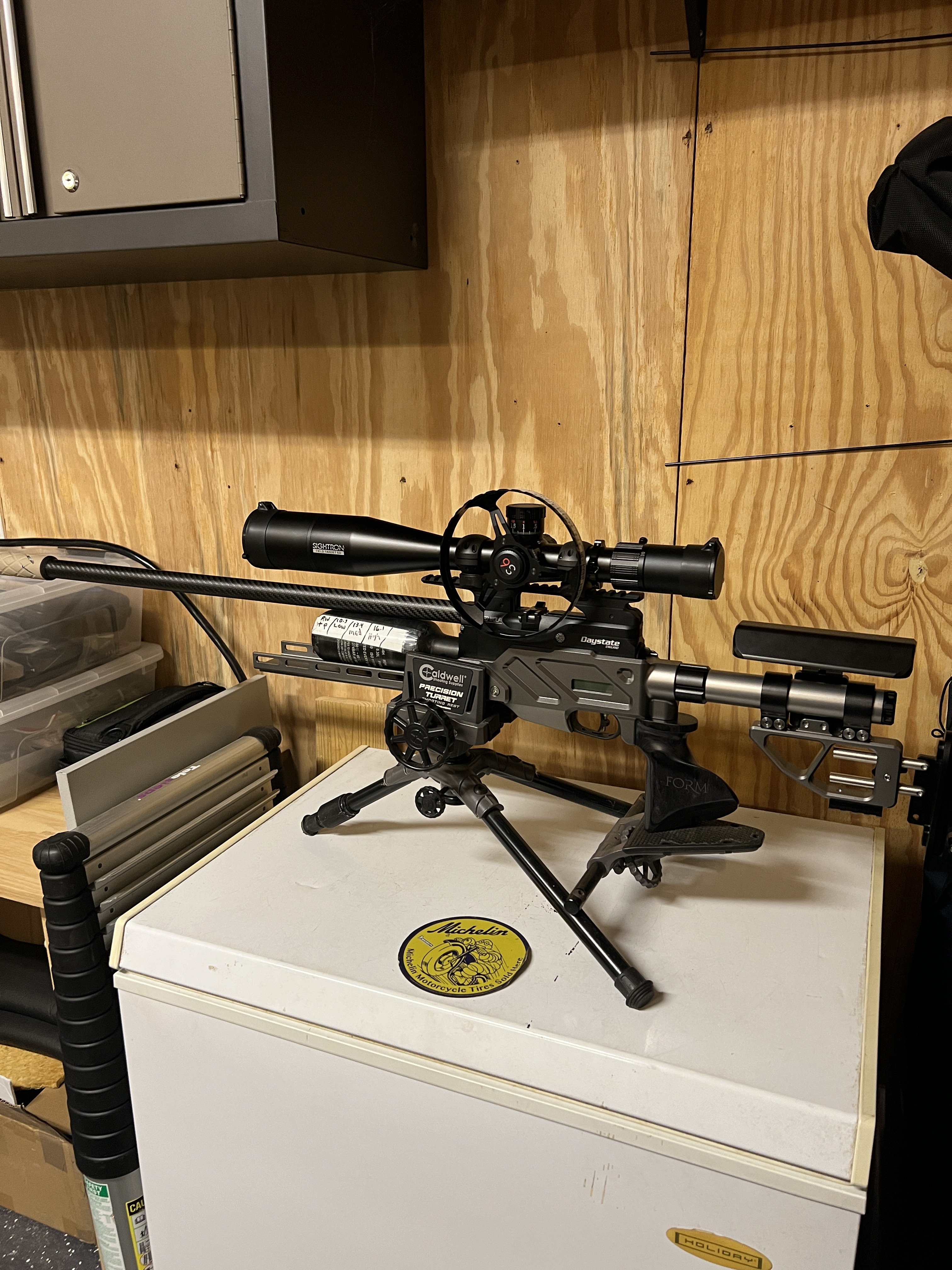

While most would argue against the aesthetics, I love the functionality of chassis’s.
Reactions: cavedweller
Although somewhat beastly to shoulder at age 68, the chassis is superb for me on a bench…. Although I will shoot EFT with it occasionally, I expect all my forced position lanes will be drive by shots or zero 😳 after all two lbs is TWO POUNDS 😬
