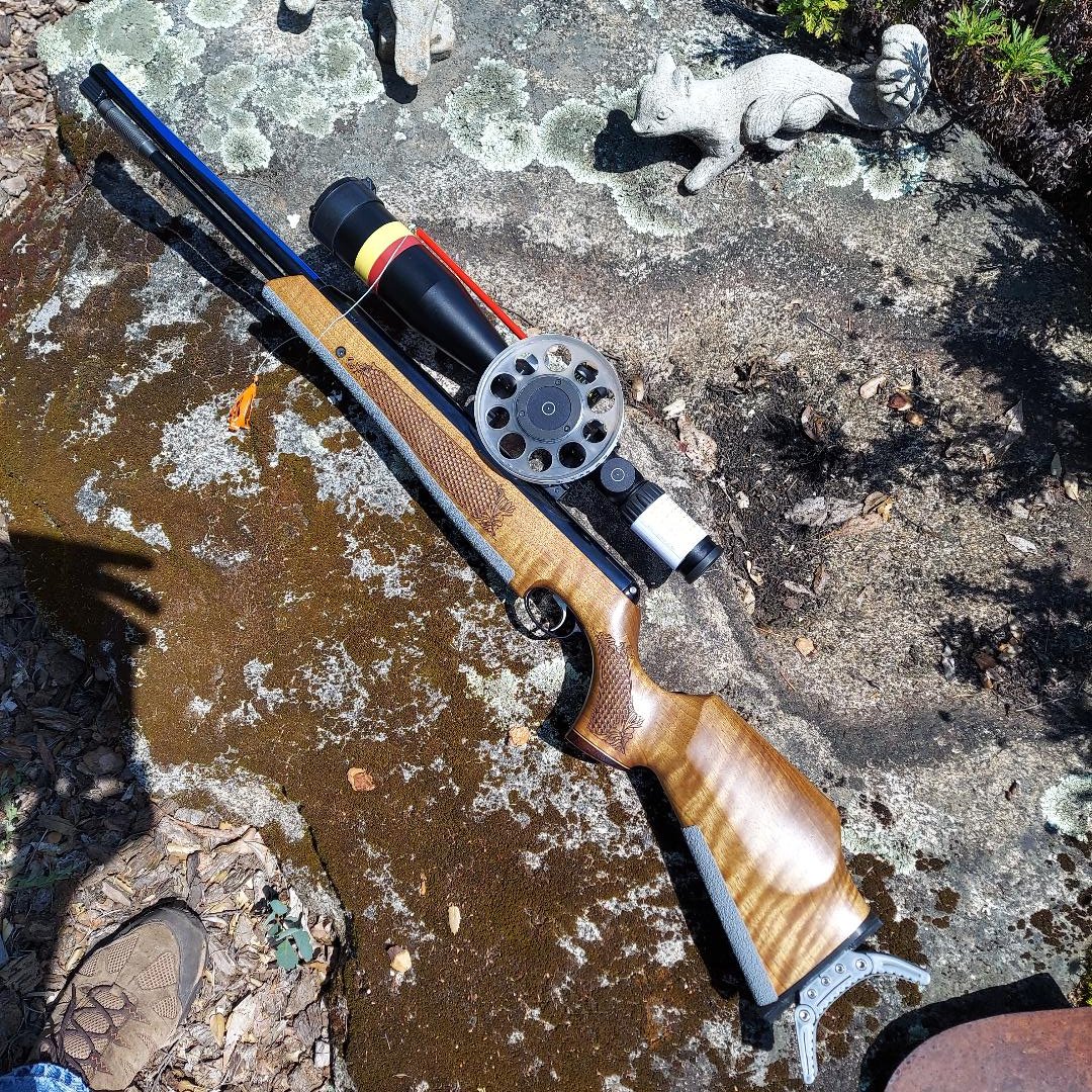

I have not touched my Pro Sport yet, I might do it over the holidays. I use this on my Daystate stocks. The stock simply soaks it up like a towel. This man is a wood working genius.

Yes that looks good , what oil did you use, and how many coats did you apply?
I think it's CLP .... I only put enough on to just coat the surface using my basic oil rag. I started light because I didn't feel it was a good idea, but I couldn't argue it looked great. I've never done this before or again.
However, it worked better than one could expect .... it's such a beautiful piece of wood (that's likely the most import factor).
Again, I'm not pushing this as a solution.

I understand, I'm just trying to get some ideas. I actually wiped mine with my oil rag lightly when I first got it, but it soaked up in a matter of mins. The wood is extremely dry like sponge..lol. I just don't want to put something on it that's going to be sticky and not dry completely, time will tell what I decide to do.
Does it dry completely or kinda tacky, finger print? Just asking because I've never used it before..lol.
I've heard various approaches to using it. Personally speaking, I generally apply a fairly liberal coating and let it soak into the wood for a while. After which I wipe it dry with a clean cloth. I use the clothe to handle the rifle until I can place it to dry . I have a table covered with packing blankets for this. I let them sit overnight or longer then give them another good wipe. At this point they are dry and not tacky.

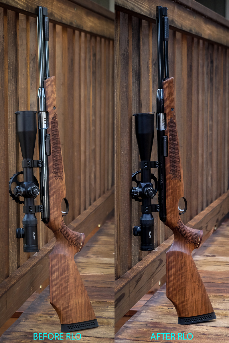

I'm a big fan of ARH Royal London Oil. It's super easy to apply and get exactly the sheen you want. I've used it on several stocks, and other walnut and it has always come out great. I've found that with walnut, 3 coats provides a very slight satin sheen. This is what I like as it shows figuring really well.
It looks nice. I see the checkering gets a bit dark,
not sure how you could avoid that though.

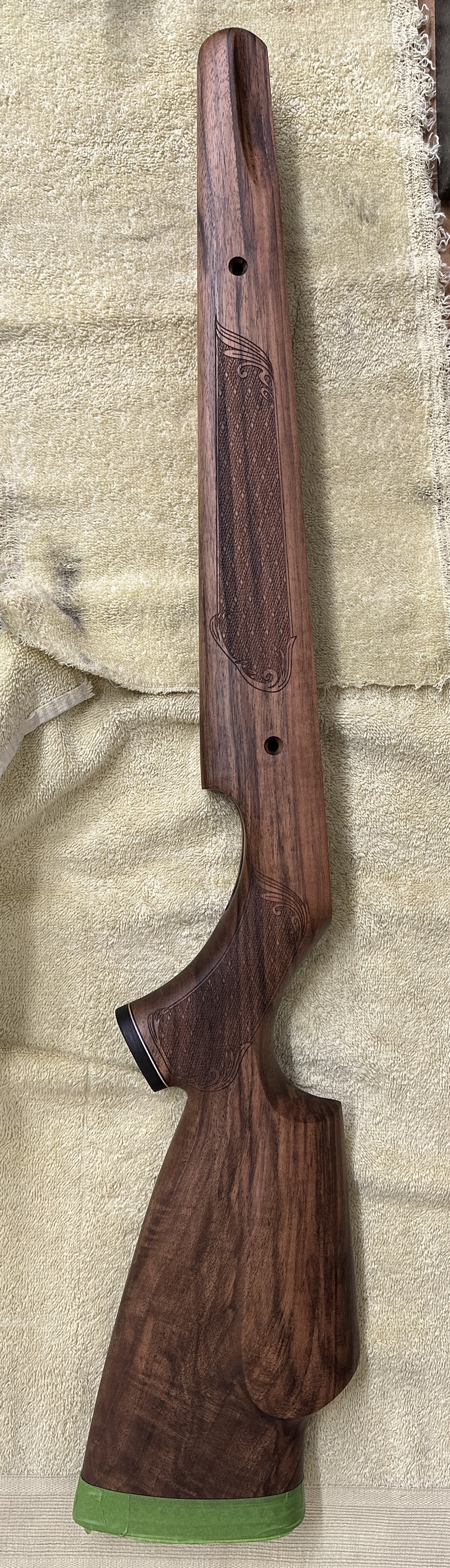

So I finally applied the first coat of 100% pure tung oil tonight, I thinned it 1:1 with mineral spirits
because it's pretty thick oil, and this is what most people do, that I saw. Any way here's some before and after pics...

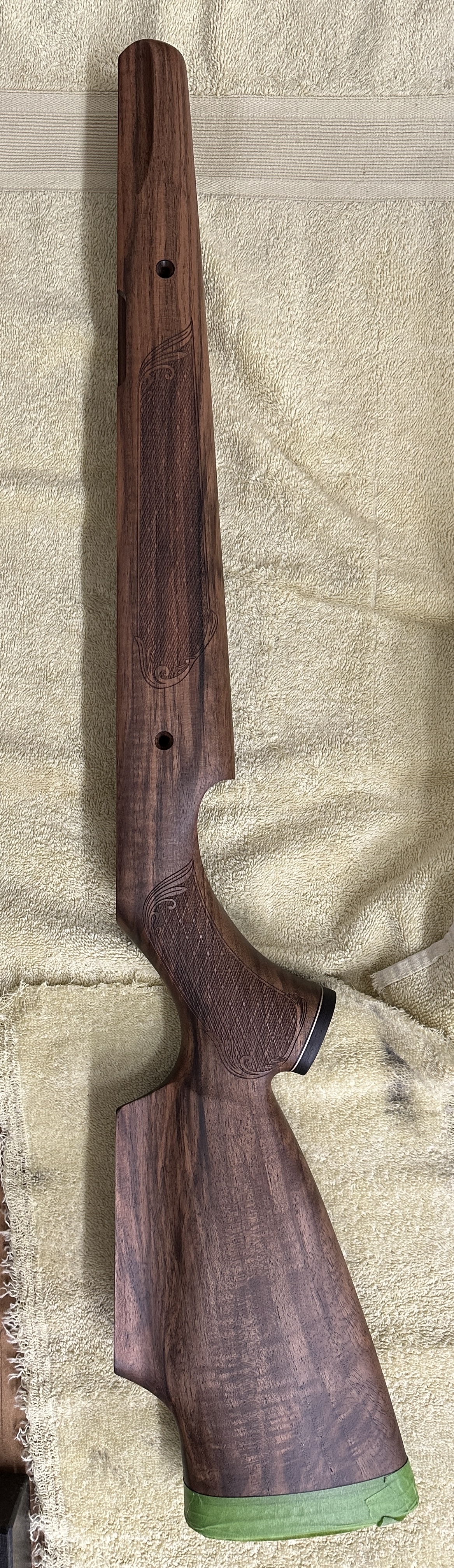

Before.......

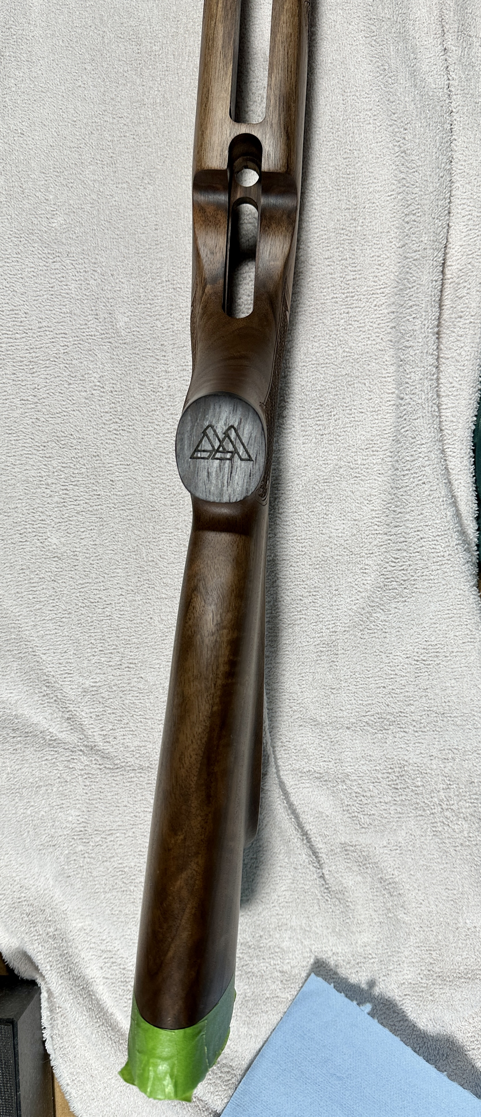

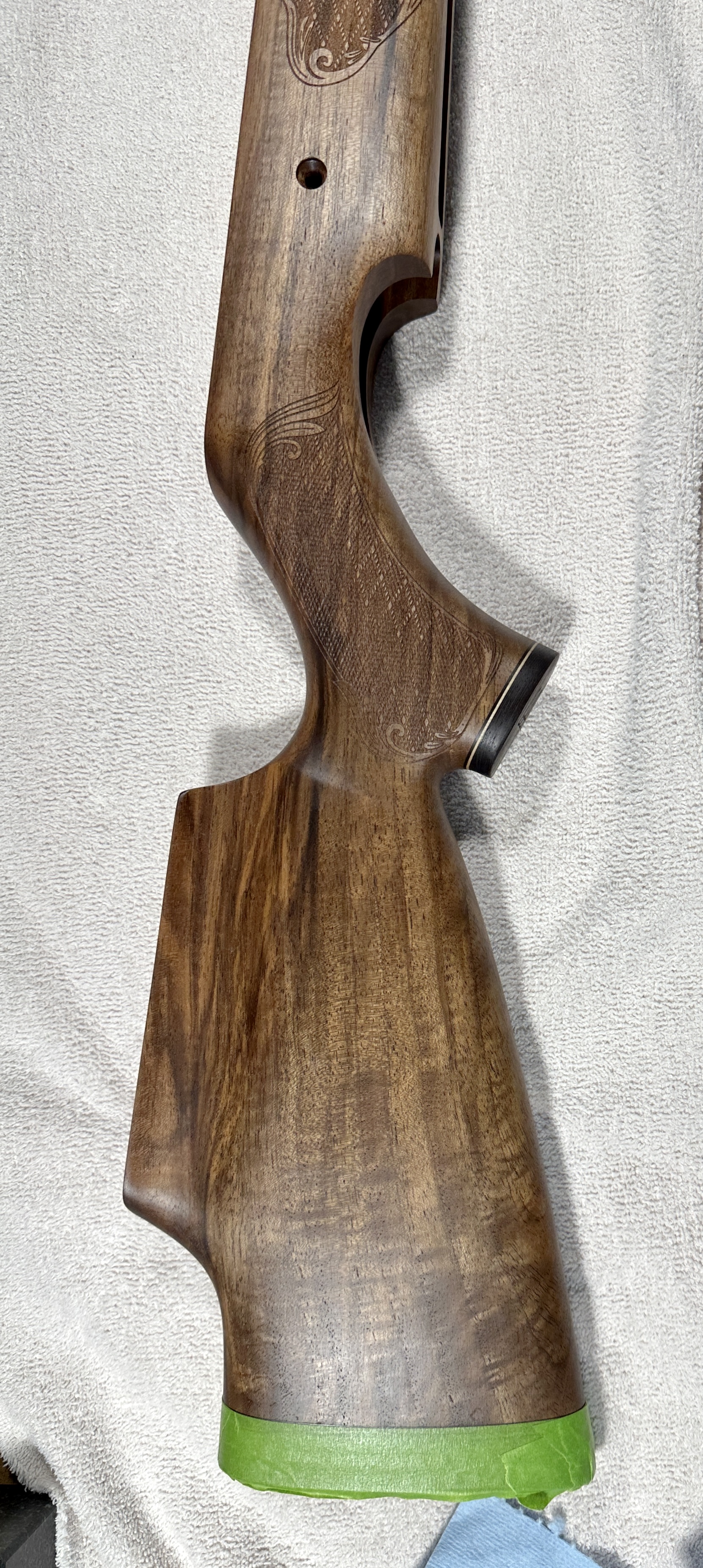

After and still wet....
It looks lighter around the forearm in this pic, but I'll see in a few days of drying what happens.
Other side is the same, I didn't really see it until I took these pics, maybe didn't penetrate as much on the forearm IDK. Anyway I like the new look better than the lighter factory color that was bone dry. I'm going to apply at least one more coat, not sure after that. Everything I've researched says it takes a week or more to fully cure. I'm going to wait 3 days before another coat at least. I also bought some 0000 scotch bright pads for buffing, not sure about doing that either..lol. I'm learning as I go.
