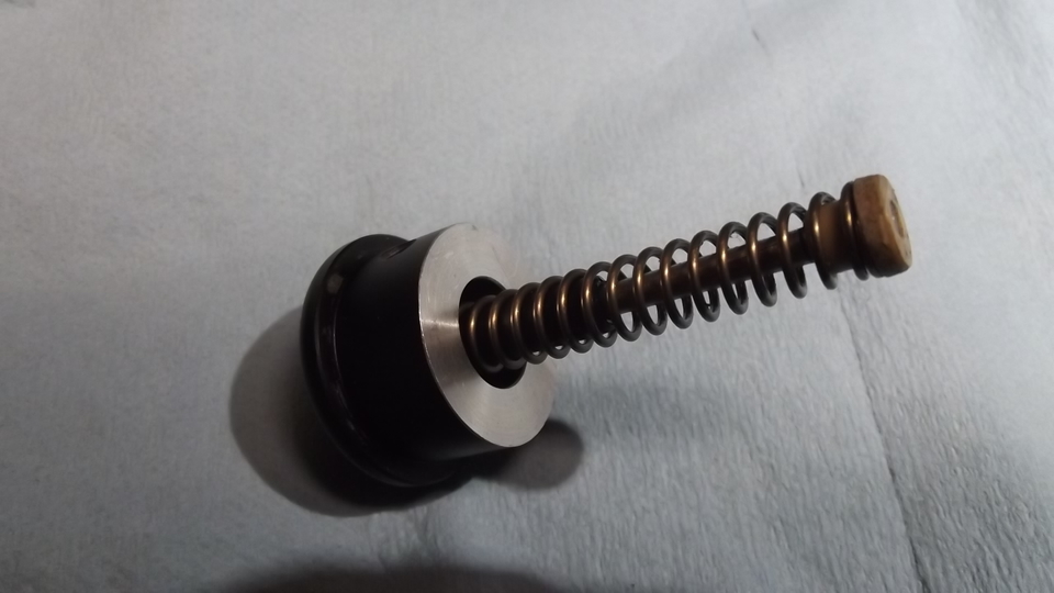

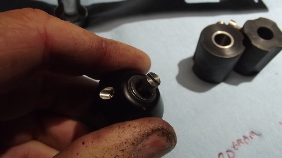

I bought turn-key solutions from Troy Hammer at Annihilator airguns. The new gen bottle guns (Pro, Knight, etc) have a different hammer that needs to be bored to size and cut down to length. That part is hardened steel and will take specialized tools to accomplish. Contact Troy (THAMMER here on AGN) to get your own.
https://www.airgunnation.com/members/thammer/

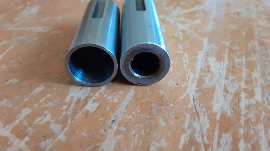

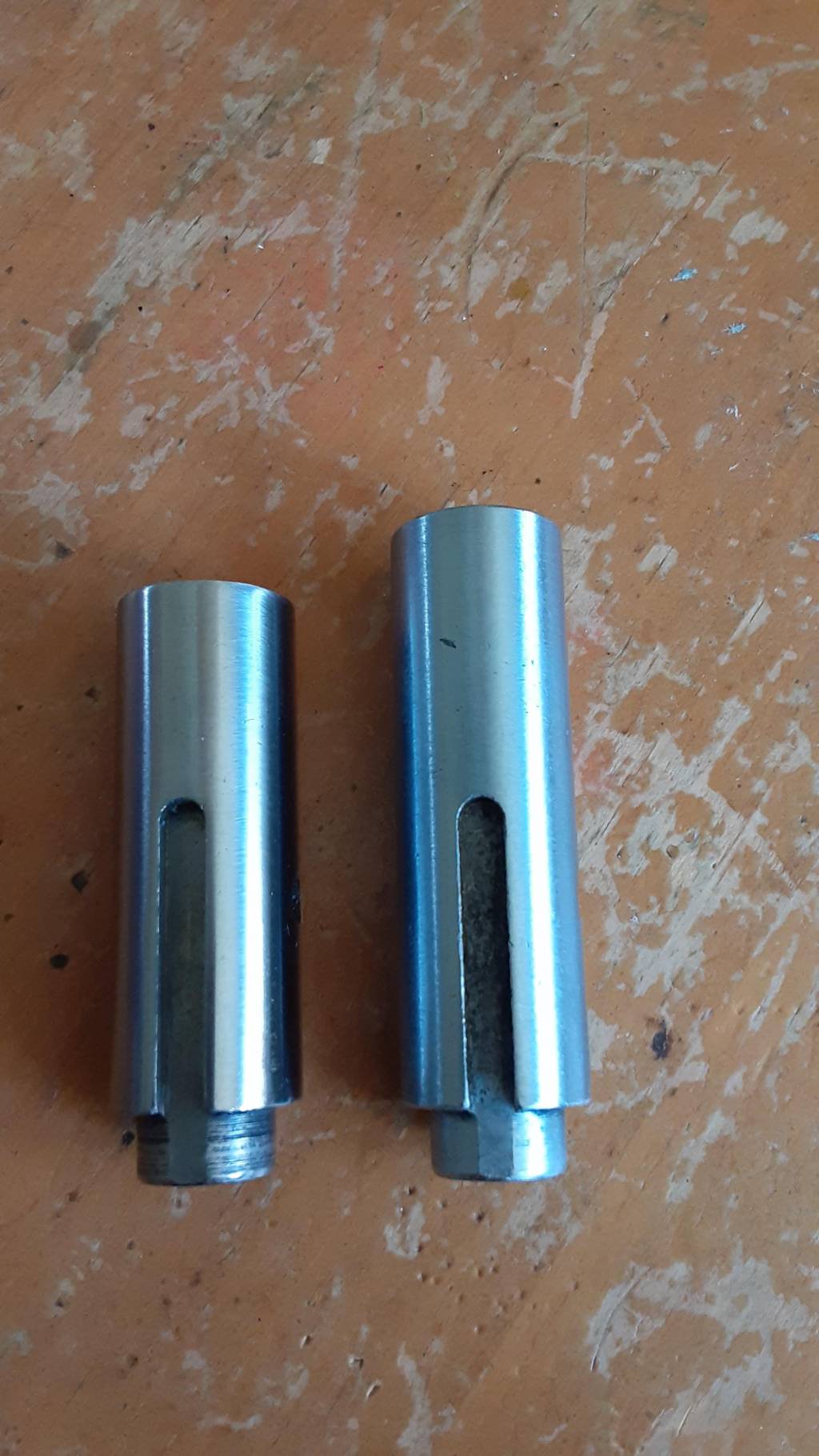

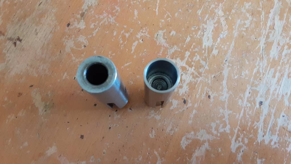

Thanks Troy! The pre-mod hammer you show is the exact same one as in my Puncher Pro 6.35 (not the bottle version but the cylinder version with cocking bolt). After I regulated it, hammer bounce started reducing shot count - just like you said in one of your videos. I then lightened the hammer and increased the reg set point -- shot count doubled to 38 consistent 55 joule shots (ports opened all the way thru to 4.5mm). I would be grateful for your validation as to whether that's good shot count for my 330cc cylinder, or could still be improved upon? Note also that cocking remains smooth -- I wonder if double spring would not make it too hard on the bolt. My only real frustration: the JSB king heavies travel at only 223m/sec from the 58cm long barrel. Slightly underpowered IMHO -- presumably 100m accuracy could be better at higher speeds don't you think? I wonder how I can increase that speed though -- Open up the ports more ? (I would send this beauty over to you for some TLC but I live in Europe...). Advice in the above points appreciated!

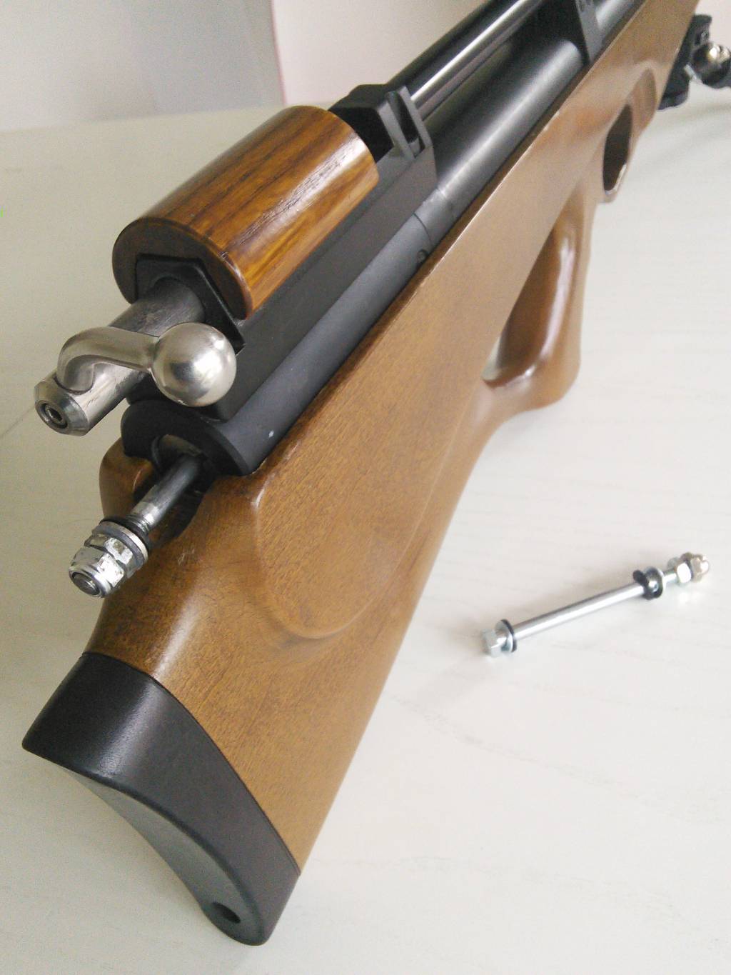

The type of device you use to eliminate hammer bounce sometimes depends on your guns design. I use the design that sticks out the back of the gun if it’s hidden, semi hidden or a really clean design. On my Prod I had to use an internal SSG because I have the gun in a stock that I didn’t want something mechanical sticking out the back. The Prods hammer didn’t require me to drill a hole which we know is no fun with hardened steel. There was barely enough room in the Prod and the spring had to be heavy which made cocking no fun. I regulated the Prod and was able to then use a spring that made cocking almost as friendly as stock. Just remember, either of these designs requires a heavier spring because you are no longer trying to drive the hammer through the valve. The hammer is in free flight and has lost some of its ooomph.
Exactly .... the "TYPE" SSG one can use is many times w/o choice based upon design of the gun & if or not Stock clearance for an external can be done ?
Myself ... MUCH prefer a free floated SSG that is NOT attached to the hammer. It can float independent or be attached to the end cap ... just not attached to hammer !!
Outside of my RAW / Theoben guns that allow a completely hidden design, all are external rod types, when cocked the stop rod becomes a COCKED indicator extending outward off the rear cap.
This one for a gen2 m-rod. It stays attached to end cap, tho when SSG stops spring expansion the hammer is free to continue forward striking poppet stem.
These types are the MOST CONSISTENT because the energy from the spring transferred to the hammer makes a clean break being just an instant disconnect.
* Unlike designs in M-rods where a bolt goes threw the hammer and when spring expansion stops THE BOLT / SPRING ASSEMBLY that was stationary is now brought into motion. This absorbs energy and hurts the consistency ... they still work, just not as well.

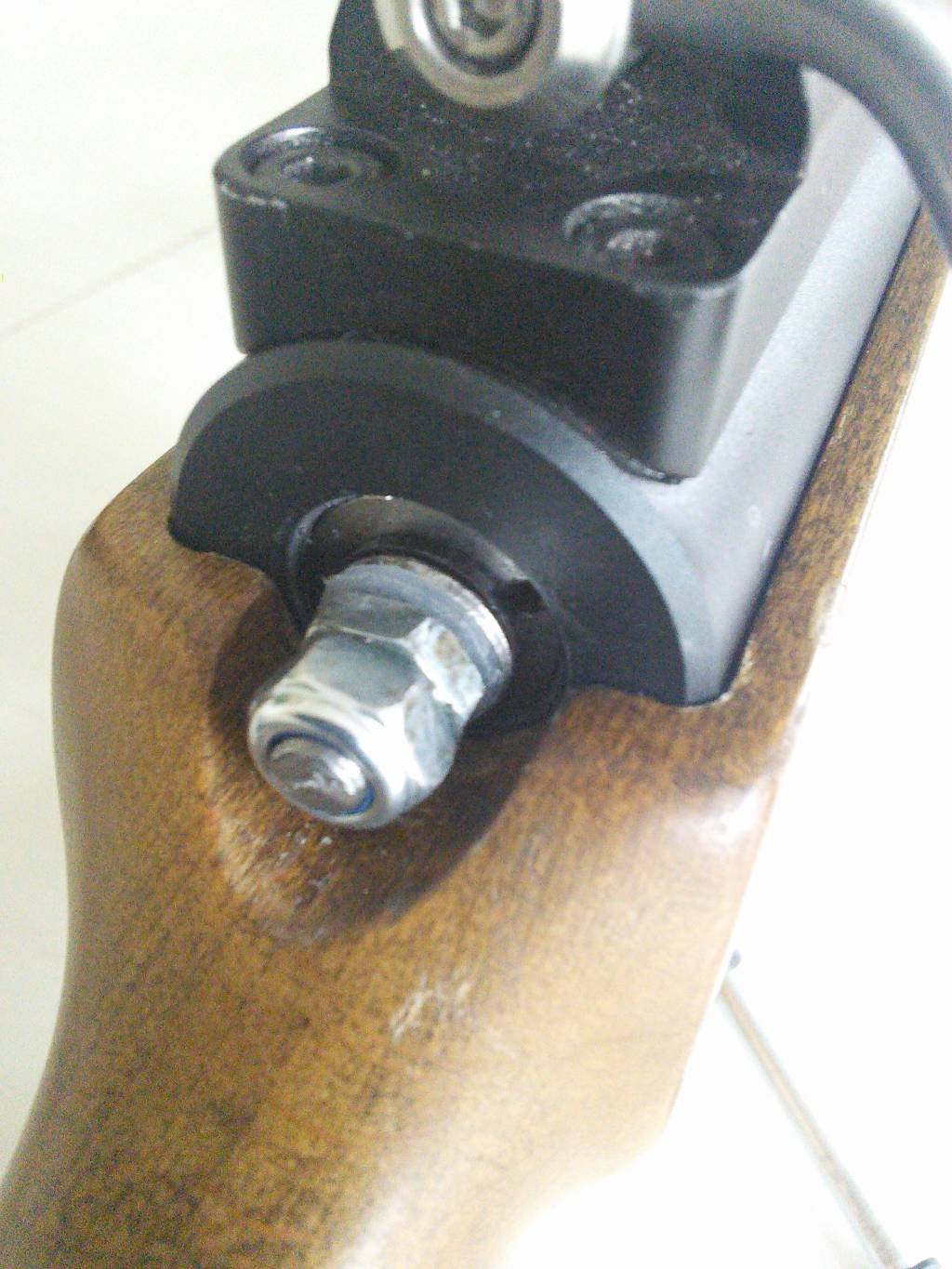

Armed with all the knowledge & advise gained I made my first SSG (the external version) for my P12. Takeaways:
- it was easier than thought, despite my reluctance to saw off the spring guide from the hammer spring adjuster. Left 7.5mm in place to continue serving as a guide. I then drilled thru the adjuster from both ends, first with a thinner drill and then opening up to 6mm.
- I used the stock hammer spring, a 6mm diameter bolt (rounded off the hexagonal head), and metal + pvc washers. Two nuts to secure the setting.
- cocking is noticeably easier than with the previous twin spring setup. There also is a slight risk of pinching ...
- adjustment is extremely sensitive. Only a tiny lightening (turning out) of the SSG nuts increases fps significantly. The hammer spring adjuster continues to play as well -- in the other direction. The right balance needs to be found. Once that is the case, consistency, accuracy, and shotcount are achieved. I ended up with a tiny bit of preload on the hammer, not a free floating one, to get the right amount of power&accuracy. Maybe this would be different with a lower regulator setpoint. But I want to stop messing for now, because this P12 .25 is finicky with unexpected impacts on accuracy. It is fine now at 60m, 260m/sec with the JSB Kings. 40+ shots.
