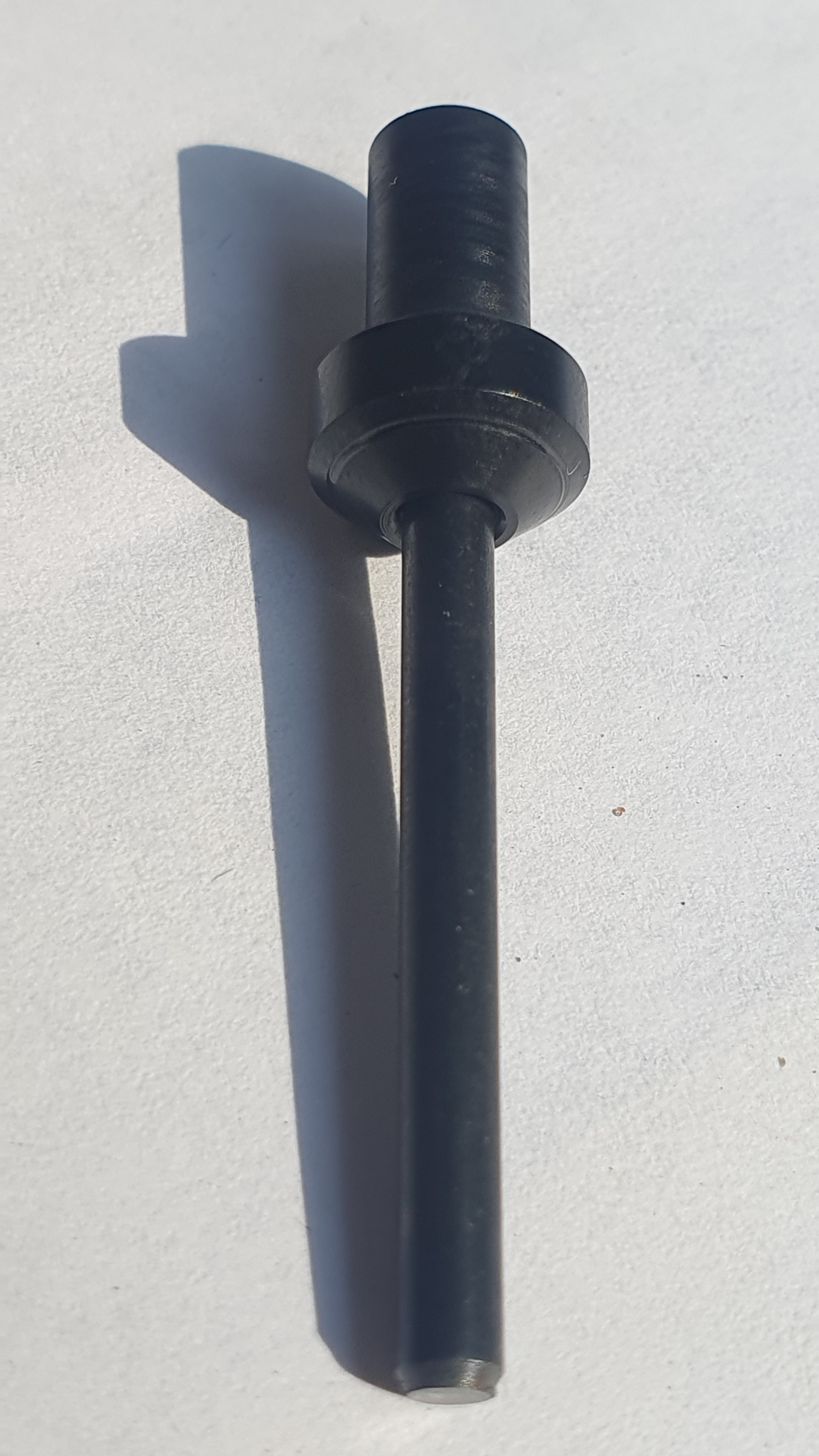

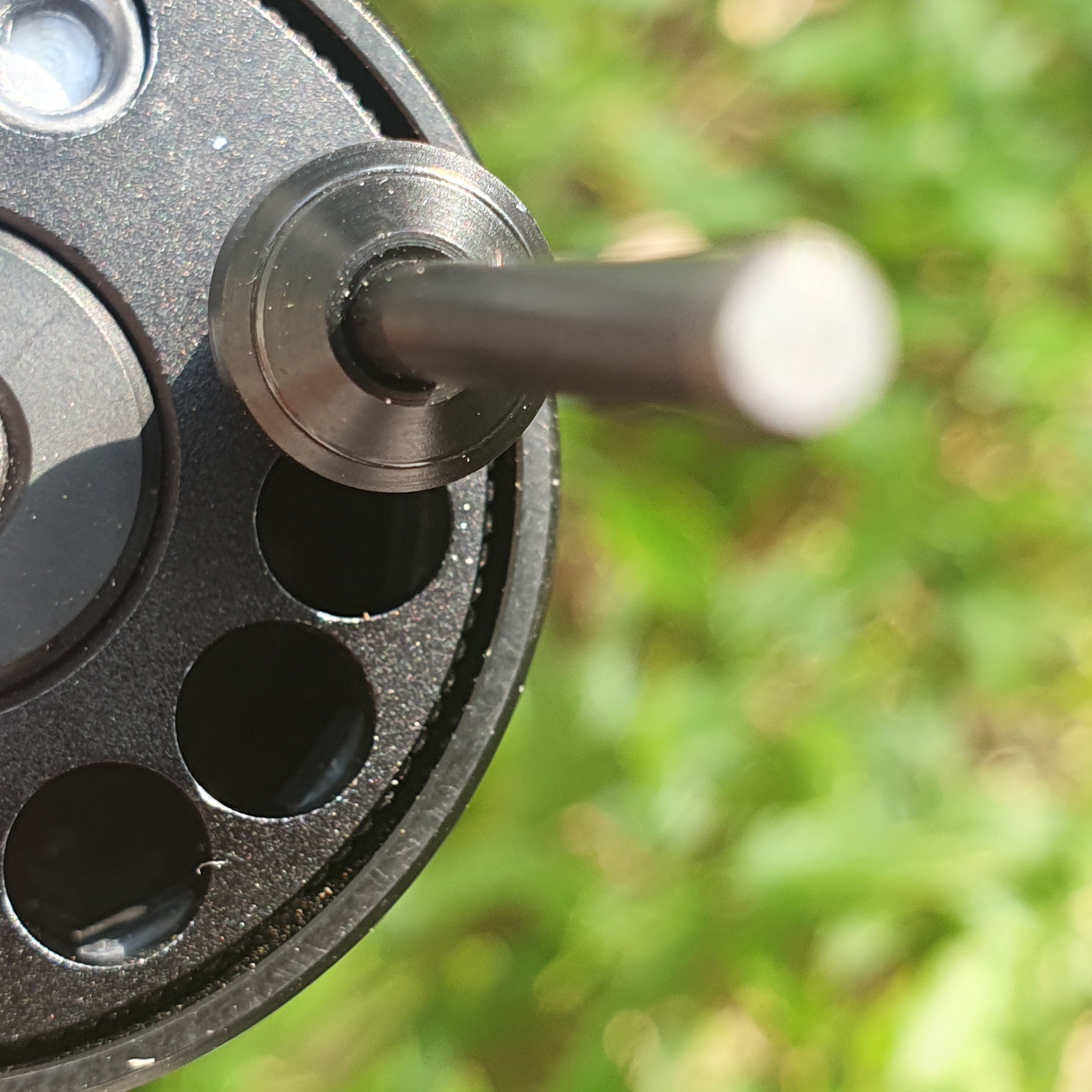

● The pellet pusher still has the o-ring #64 on it....

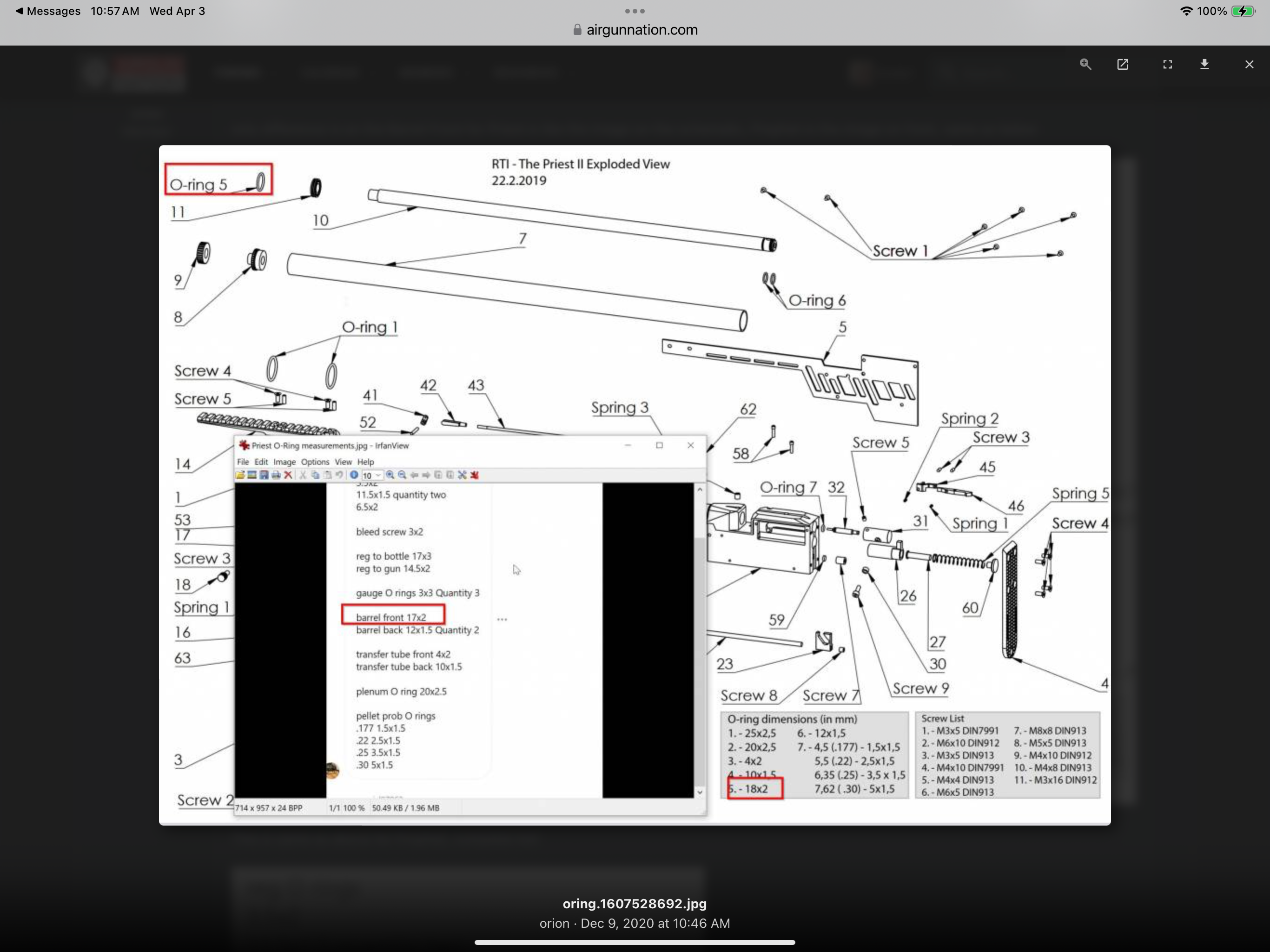

● The schematic shows an o-ring #65, but the diagram leaves me confused as to where that o-ring is located.

As trompis said above, it is likely the barrel to rear block o-rings, #6 in this diagram. I’ve changed mine to 90 duro, and as suggested, you need to be very careful not to damage them on install. This is a Priest diagram, but the barrel seals are the same.

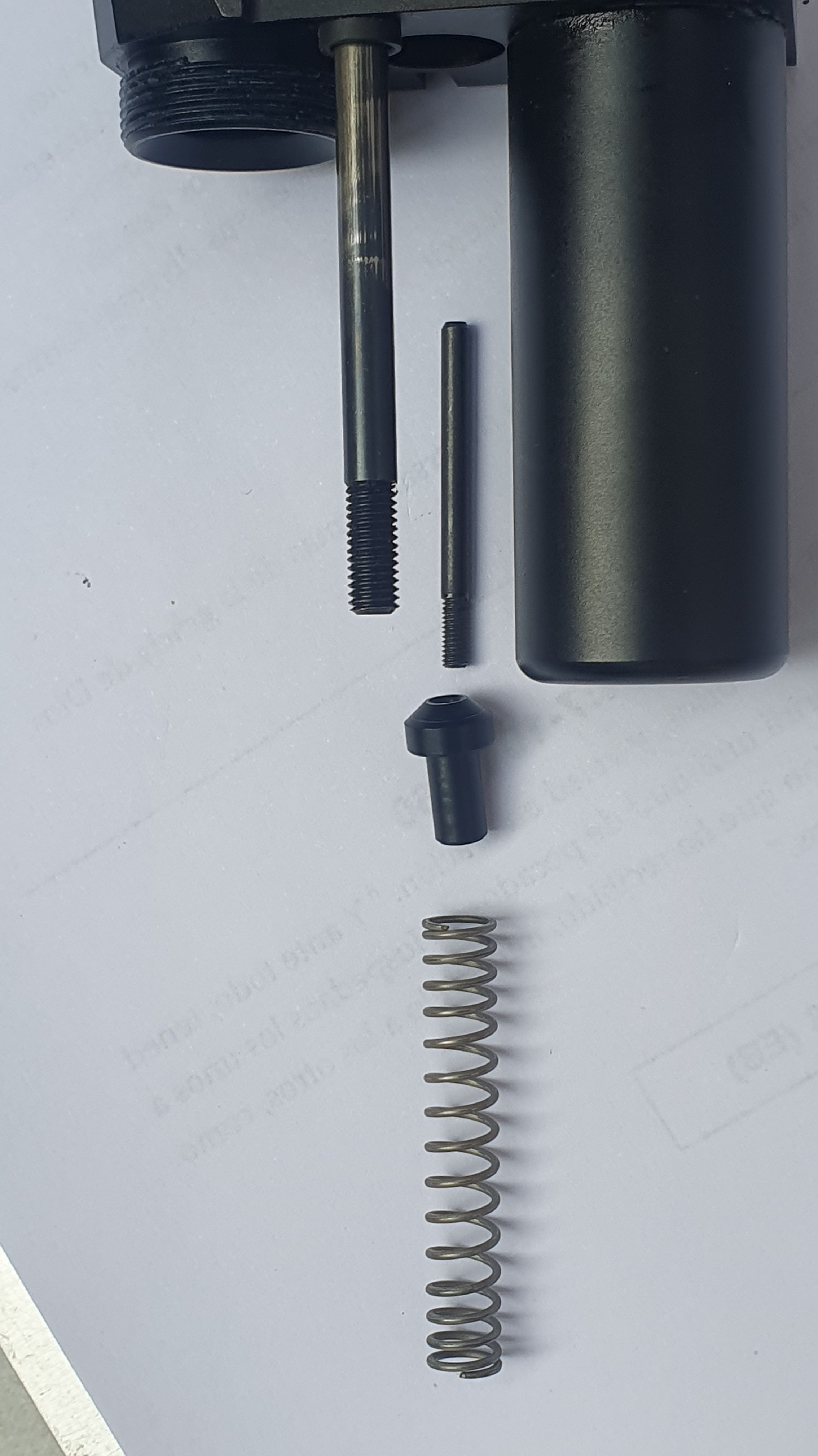

OK, friends, I have done it.
➊ I changed the two o-rings on the barrel, and also the pellet pusher o-ring.
There was nothing that looked weird, sharp edged, or messed up.
I started analyzing the shoots a little more. Here are two things that in my excitement on the hunt my mind must have simply blocked out:
➋ After the shot, the gun makes a loud, high pitched, metallic after-clang — and I would say, it's different than "the ping" that's often talked about.
➌ With every shot there is quite a lot of air coming out of several holes:
▪ top of the action, where the screw is for the pellet pusher
▪ right side of the action, where the trigger adjustment screws are
➠ My layman conclusion: There is something bigger that's wrong, something more complicated to fix! 😳
➍ I have not grown up like a lot of you guys, surrounded by tools and engines, guns, and RC's to fix. You guys are my heroes, really — what I read about you accomplishing on your guns, simply amazing! 👍🏼
So, when I decided to open up the action and dig deep to find the valve... — that was not an easy decision.
➠ And now I am at my wits end. 🤷🏻‍♂️
I find nothing wrong, nothing missing — unless the valve requires an o-ring somewhere, but I can find no shred of such o-ring....
The schematic drawings of RTI are less than helpful, as they improve their guns constantly — so my gun looks differently than the exploded diagram that I downloaded from the RTI website some years ago.
➠ I'll attach some photos.
➠And hope for some advice....
Thanks! 😊
Matthias
While you’re in that deep, I would replace the poppet. You bought the gun used, and apparently the gun has been shot at 160b by you. And who knows what kind of power chasing the previous owner did. When you assemble the gun, make sure you have the cocking linkage adjusted so your probe is locked nicely. Also inspect your block where the little screw cams down and locks the probe from going backwards. RTI’s will wear the block on the corner where the screw goes from moving forward to down. Back to your problem. You are getting some weird air pressure in a part of your gun that shouldn’t see any pressure except the slight pressure the hammer creates moving forward. There is a vent for that on the side of the hammer tunnel that leads to your trigger adjustment screws. The only way to get excessive hammer air is if you use a thick grease. I’m hoping somehow it’s poppet related. Or possibly if your transfer port wasn’t lined up. But that’s almost impossible.
