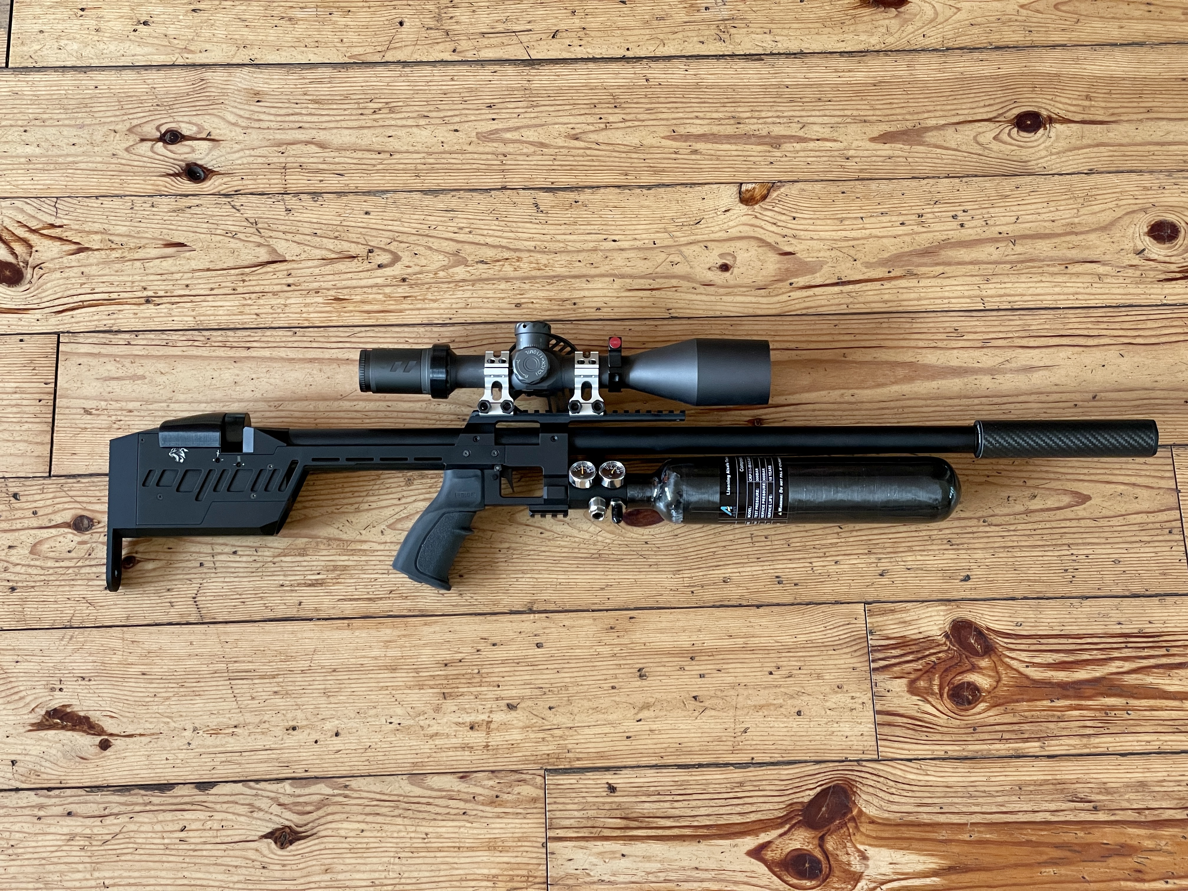

Had the prophet 2 for a few days and its very good.
One little problem. The first few shots after the gun has rested about an hour are very low power like the hammer is not hitting hard enough. Its adjusted according to Orion vids ie- enough hammer to get the valve working properly then 1/4 more. Ive tried increasing more than this but the problem is still there.

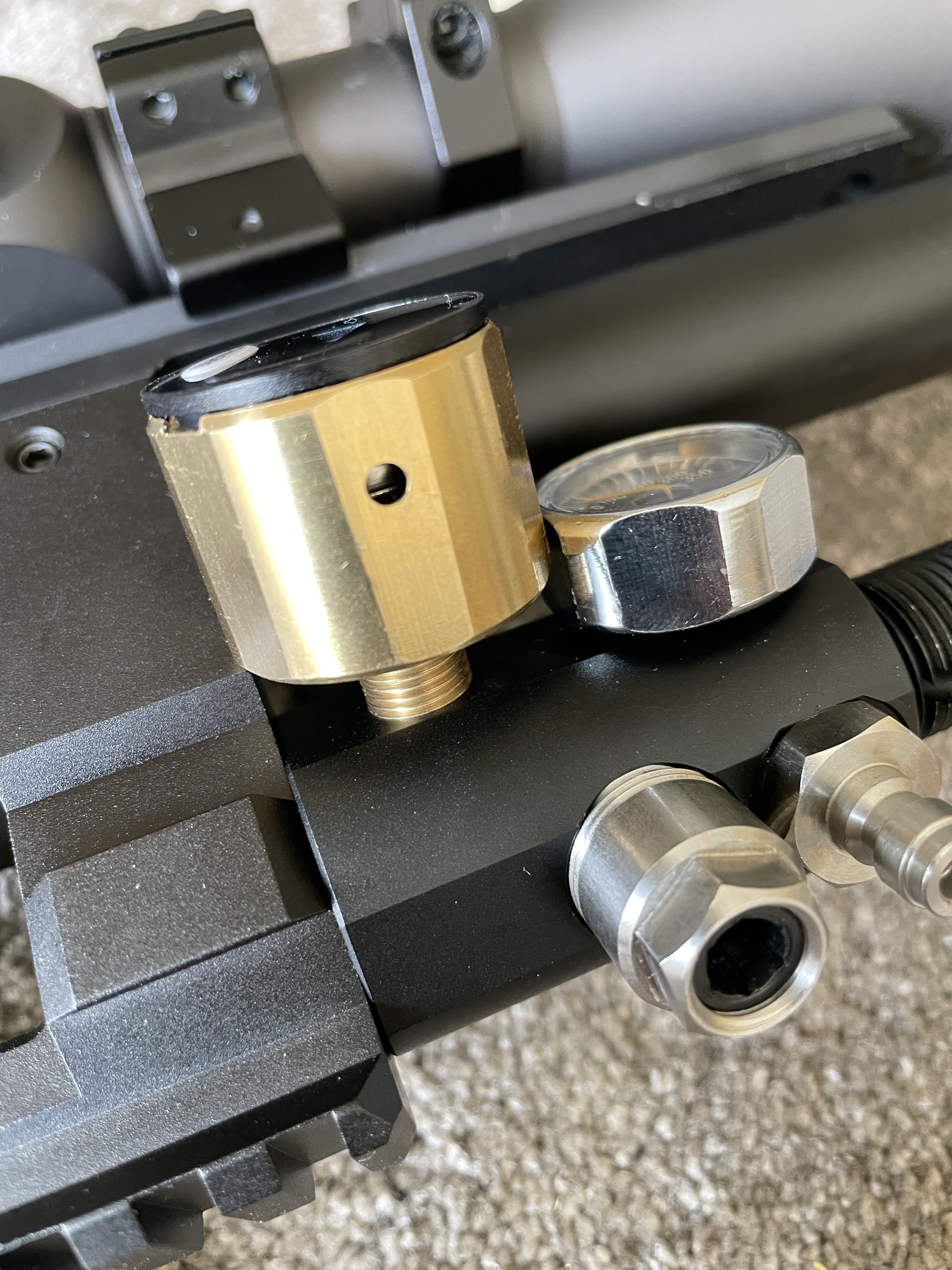

Mine is 22 P2 performance. I would like to put a digital valve on there but its a VERY tight fit and looks awful. I may make a plenum cap that will take the gauge. 1/4 turn on the reg changed pellet speed (25gn) from 850 to 950. The pressure change could hardly be seen on gauge (around 100 bar).

If it is creeping its not enough to show on the gauge, which is why I was trying to get the digital gauge on there.
Every "classic" gauge is produced from the same 2-3 Chinese factories. This doesn't mean that they are bad products, but they have all the same tolerances, ~ 5-7%. So, e.g. you have your reg set at 90b. A creep between 0.1b and ~4.5/6.3b will not be showed. I have 2 gauges on my RTI Prophet, one on the reg, and another right behind the plenum. They have a 5 bar difference, but my gun doesn't leak, so...
Digital gauge are good for sure but honestly, you don't need them. Just shoot 5-7 times before getting serious. Every closed regulator will have some small creep, not a big problem for sure once you know.

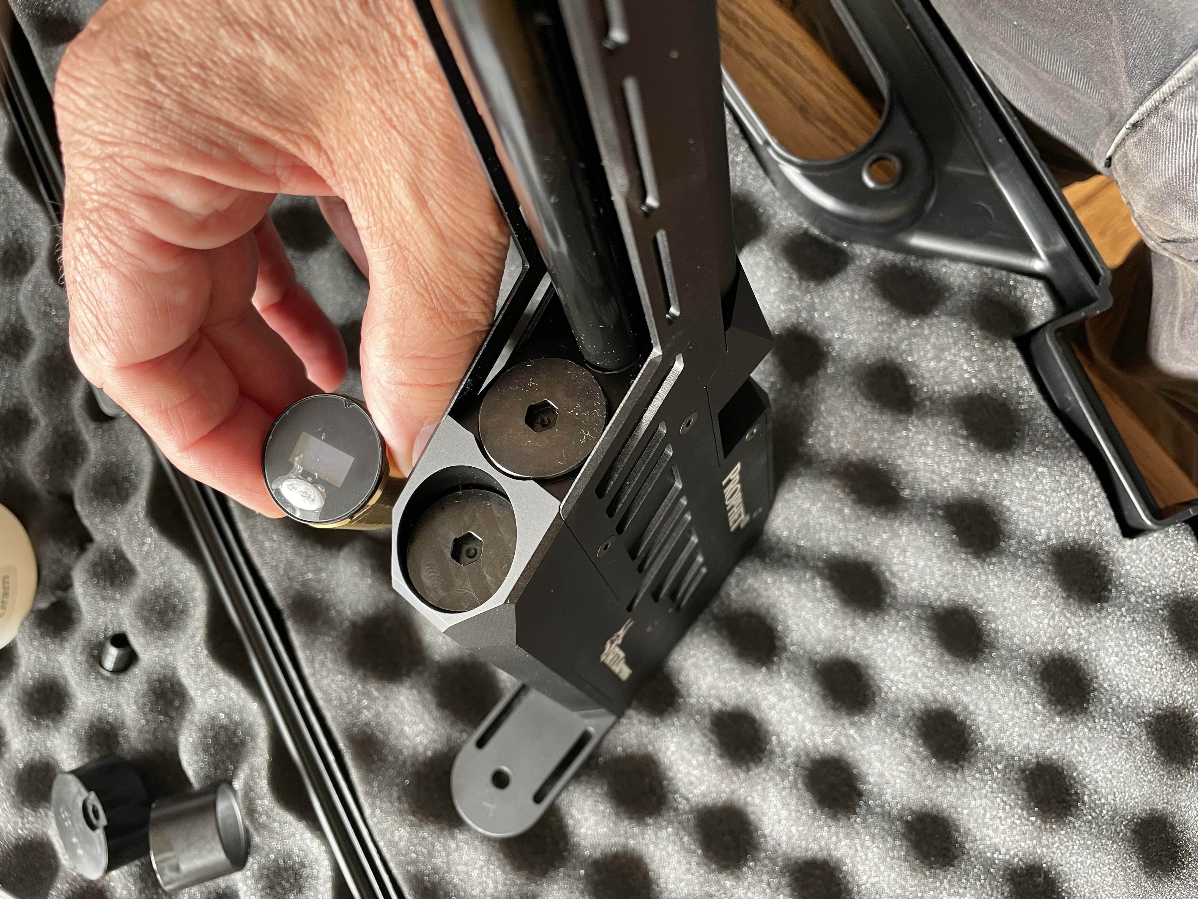

Yes, at 120 mine was giving speeds over 1000 with 25gn redesign. I wanted to try 880 which needed reg at 100. Seems too low so I suspected the gauge was not accurate so thought I’d try to get the digital on there. Was worried if too much hammer may damage it (it’s not more than one turn past the “light up” setting). Also the hammer screw is about 5mm deep. Some people are saying its flush when working properly. The adjuster screw is really loose and I suspect it may move over time. I’ll mark it.

Don't be afraid to have the screw in, my gun came with the screw almost all the way but the reg came like at 150, I think they were testing slugs or something when they send the gun, what I want to say is that the screw doesn't have to be flush, keep turning it until next day you don't have a slow shot.
