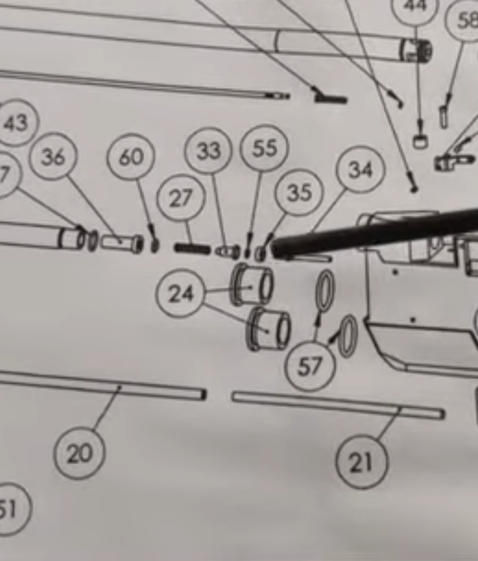

O-Rings for the valve and the stainless assist deal. OLD VALVE. Part #60 would be the same, part #55 might not be.
#60 Steel Balance tube O-ring is 5.5x1.5mm (Isn't the proper designation 1.5mmx5.5mm? Cross Section x Inner Diameter) I found some of these on theoringstore.com, Buna N 90 Duro for 15 cents
#55 Valve O-Ring is 4x1mm ( 1mmx4mm ) Not finding any of these in a 90 Duro, but the same place has them in Buna N 70 Duro for 7 cents. The old O-ring definitely was not N-90.

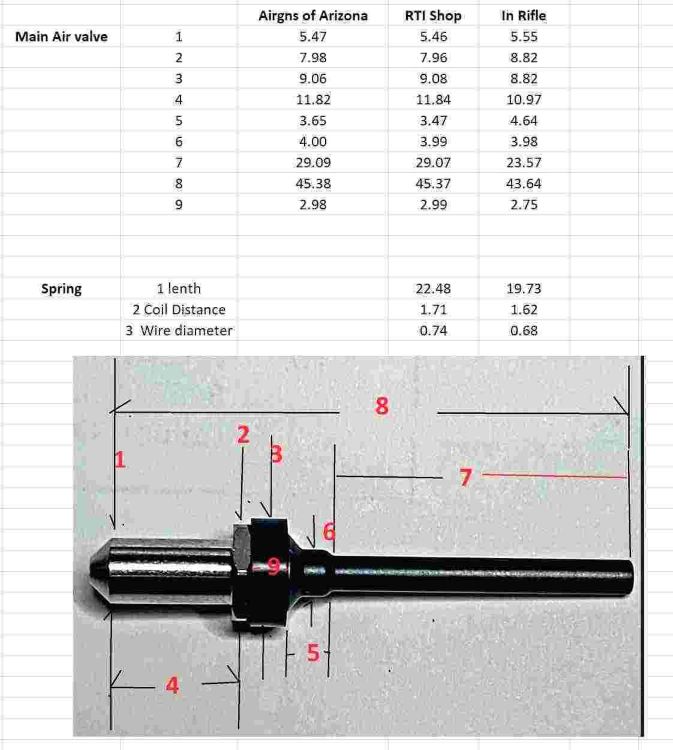

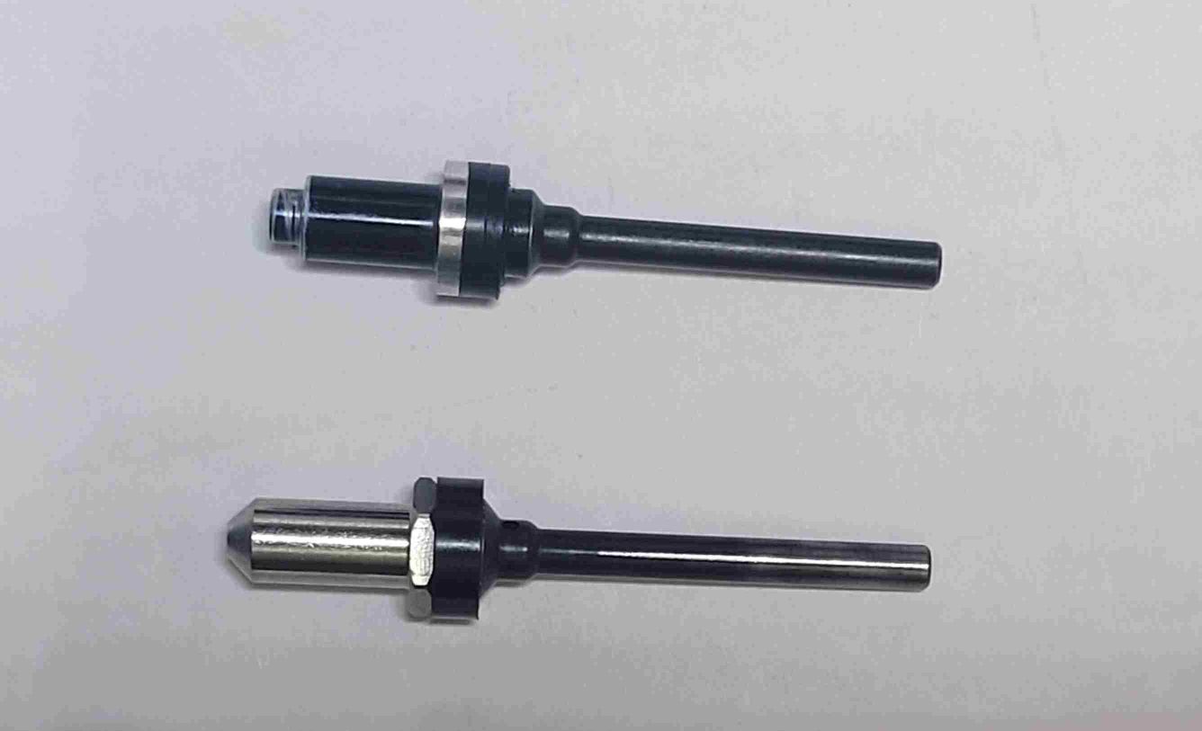

Rok was amazing in giving guidance. He said that he would send me a new valve & It’s on its way. However, me wanting to fix the problem immediately I decided to order the new valve from Spain and Airguns of Arizona. I ended up having two new valves on top of the one coming from RTI.

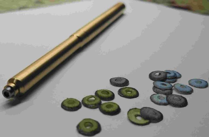

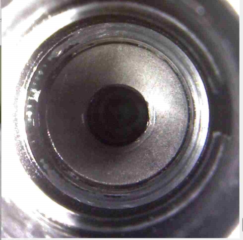

Just to make sure I put a bore scope to check the surface of the breach seal flange and it looked that it had some anodizing left on it. It is supposed to be smooth and polished. Airguns of Arizona and Rok said that it could benefit from polishing. How do you polish the breach flange in there? So, I asked Rok and he sent me a sketch of a tool for me to make on my lathe, and so I did.
I then polished the breach flange from 400 all the way to 3000 gr. Changed to the new valve assembly and a new valve spring. Removed the check valve and inserted a steel ball in its place. Rok also sent me an updated regulator while back.
Oh boy did those changes make a difference! Now it is holding pressure and the spread is less that 7fps for the first 50 shots I fired. No asthmatic wheezing, fast cycling, and a five shot group gives a 6mm center to center at 30 yards on a bench.
