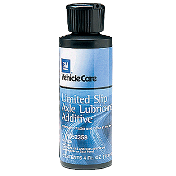

Many moons back, I had an AMT AutoMag (semi auto, .44 magnum pistol). Like the one "Dirty Harry" had in the presentation box in the second movie.
It's ALL...stainless steel, front to back. Everything but the springs, and they MAY have also been.
Anyway...yeah, trying to find a commercially available lubricant that worked on stainless steel, with high loads, was a pain. EVERY time that I shot it, I had to clean off all of the gall marks on the bolt and the frame section where the bolt rode.
After a couple of years, and MANY shots, I finally found a lube that worked fairly well. It turned out to be a GM (General Motors), posi (positraction) lube additive. Don't know if it the exact same stuff, I'd guess...yes.
This was in the beginning of the synthetic oil era (today!). There may well be other lubricants that work today, but I "know" this stuff works.
It saved me a LOT of cleaning time after a day out shooting my AutoMag.
