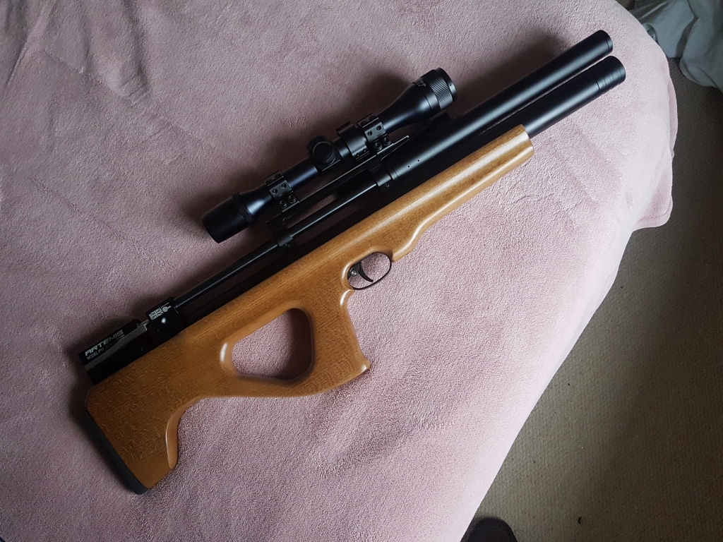

Project P15 just about finished.... offset shroud update...

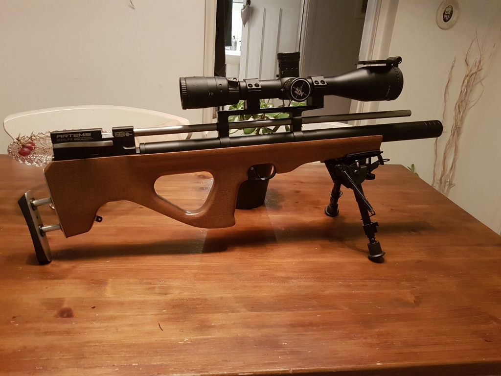

After tuning my Impact it was just to much for ratting, so decided to get something small in sub 12FPE that I could fettle during lock down. After much research decided the P15 would be ideal. Small/ lightweight/ inexpensive and would probably need work out of the box-
Unfortunately even after dealing with the bad breech and crown I still couldnt get it to shoot for poop. It appeared that the chamber was machined to large so pellets could tumble before being pushed into the badly finished leade. Wasnt worth sorting so fitted a choked Weihrauch 495mm blank-
Ended up removing original baffles and using hair curlers spaced with delrin washers which work well enough (only 12FPE remember)
The gun was spiking wildly coming off reg so to keep things legal over here in the UK reduced pressure from approx 100b to 65b, polished and lightened the hammer, and fitted a delrin top hat to it aswell, also made some slip washers for either end of the hammer spring. Now running at 11.8 with a 6fps ES using 5.52 16gr Airarms fields.

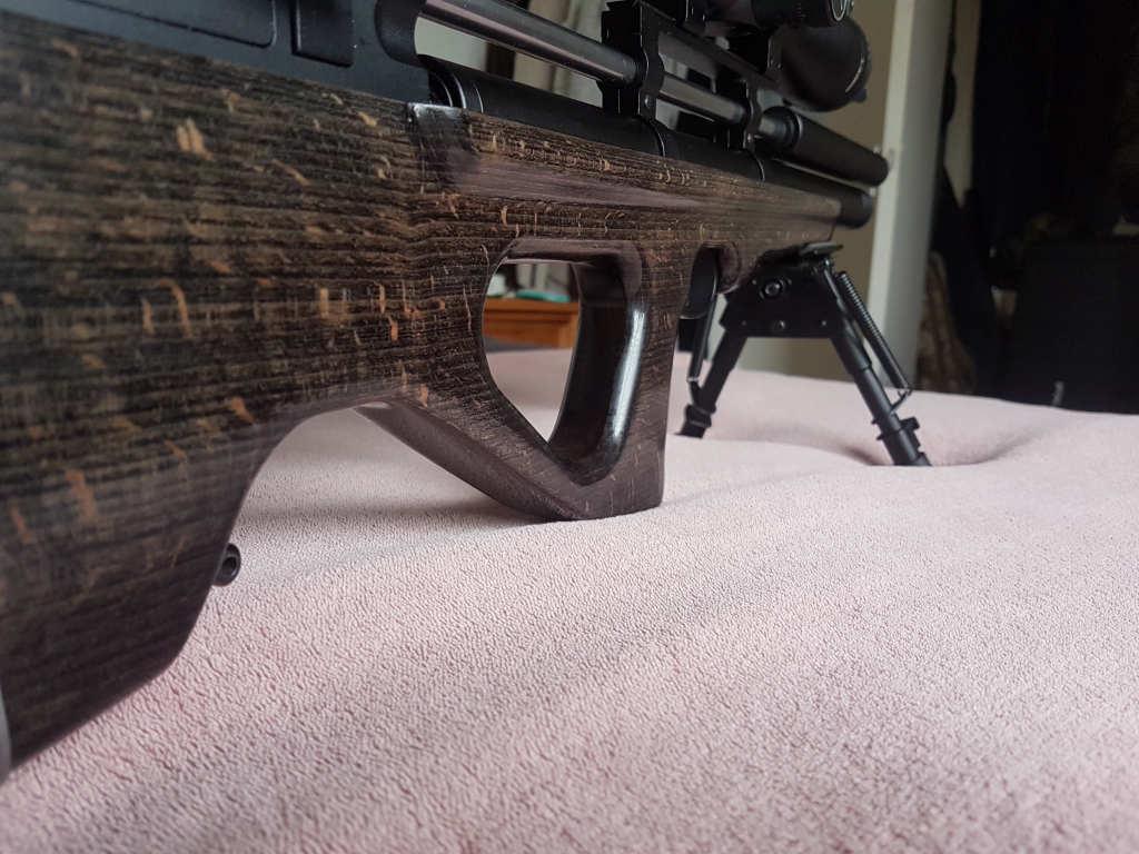

Next was the stock. One coat of black stain followed by several coats of danish oil-
Not the best finish in the world but better looking than the original in my opinion!

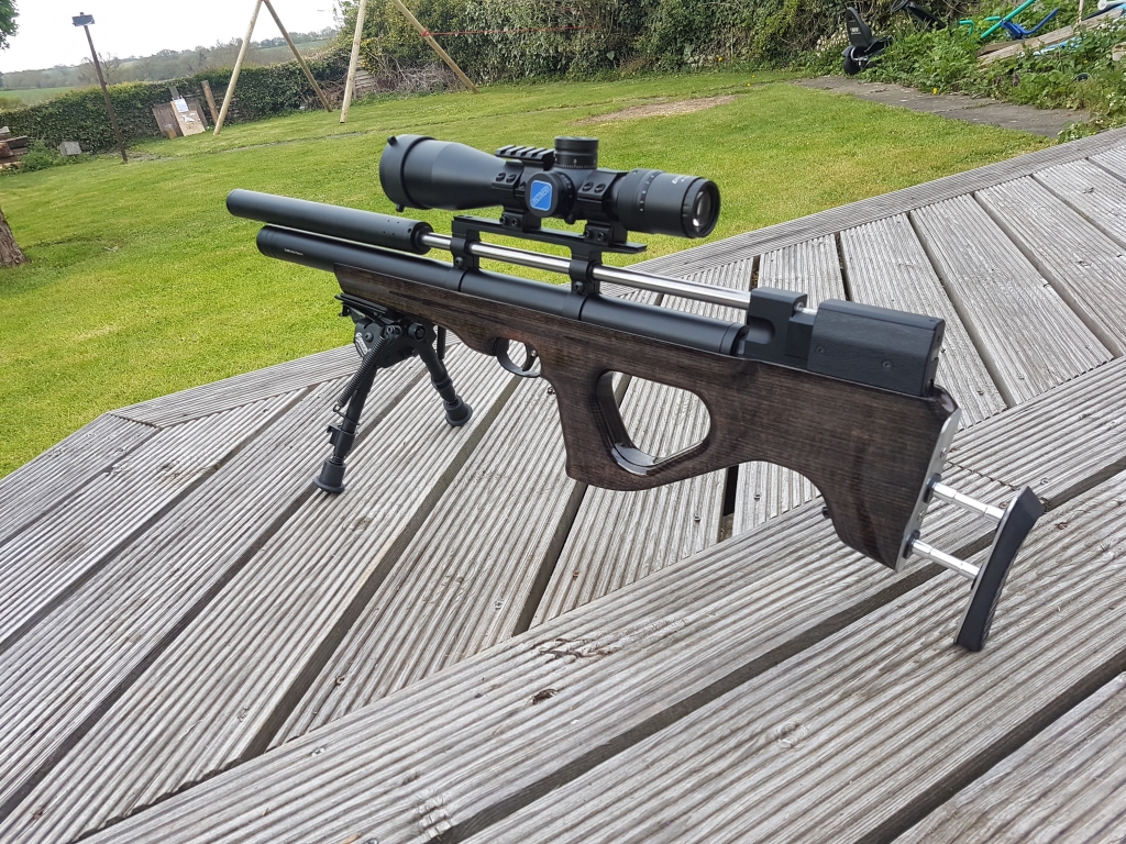

Also made a much needed butt pad spacer, and finished off with a nice little/ lightweight Discovery VT3 FFP Compact scope....
Original mags are in the bin, replacements from Darko should hopefully drop through my letterbox this week.
Trigger set needs a polish, and seeing a little reg creep overnight so may fit a Lane reg eventually, but shooting lights out otherwise so....Fingers crossed this lockdown doesnt last much longer!

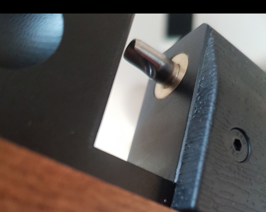

Forgot to include- original probe was sharp across the scalloped section so with the oversized probe guide, the probe was eating orings....
Cut a 2 deg angle across the scalloped section, and machined a new brass guide at the same time (pic taken pre polishing)-
Everything lines up as it should now, except the mags, became totally unusable once new guide was fitted....

Thank you!
To be honest I was a little surprised it needed as much as it did too! I did a lot of research on them beforehand and read about the little niggles with mags/ pellets clipping baffles/ bad crowns etc but thought they could all be easily sorted....
Even after correcting those issues it still grouped like a shotgun at 30 yards with every pellet I tried....guess I lucked out but no complaints, this little gun has been a great project and a welcome distraction...
Strangley though, the first time I shot it off reg the power spiked to nearly 18fpe, and the groups started to tighten up. Unfortunately I wasnt shooting over the chrony at that point so celebrations were short lived, as soon as I reduced the power to legal UK limits again the groups opened up....suspect these barrels may be happier at FAC levels...
Either way, now its sorted, have gotten quite attached to this little gun. Definitely a keeper! 👍

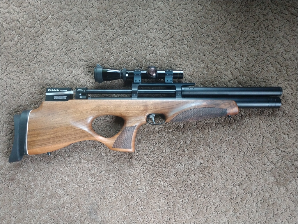

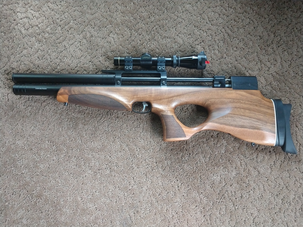

I picked up the Diana Skyhawk version about four months ago. Mine is a laser with JSB 15.9gr.
I love this versions walnut stock, and its two way adjustable butt pad is awesome. But I didn't care for the dark mud colored factory stain. So I sanded that off and refinished it with 4 rubbed in coats of Macarri RLO for a nice satin oil finish. Polished the cocking lever and trigger for a brushed aluminum look, added a white line butt spacer, and sling swivel studs.
I'm really liking this little pup. It's the least expensive PCP I own by a long shot, but is such a joy to shoot. Very light weight for long woods walks.

I purchased 3 extra mags when I purchased it, plus got 3 of the CARM mags. I actually like the 9 round factory aluminum mags better than the 8 round 3d-printed ones.
You can't beat this great little gun for under $700.00 IMHO.
