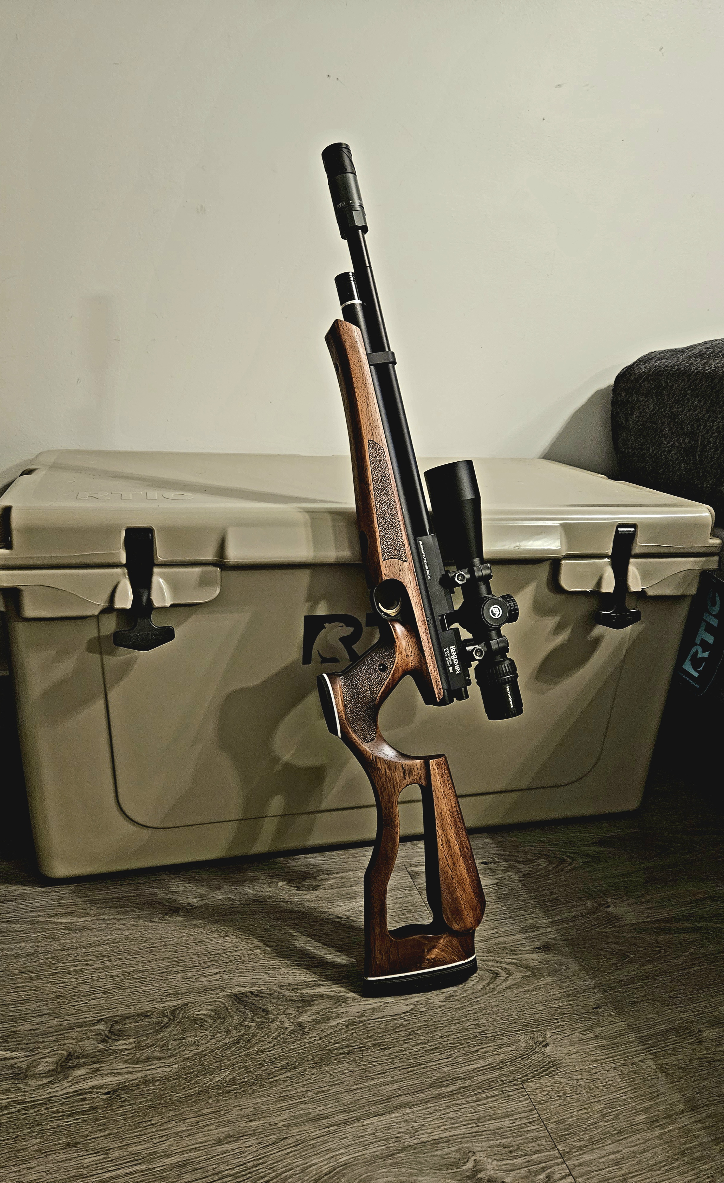

A posey shot taken on my deck sofa:
Now to be known as “Precilla” due to her accuracy. Remarkable to recall that at the outset, this Prod would do well to shoot a 2inch group at 30 yards and then only with H&N FTT copper coated pellets.

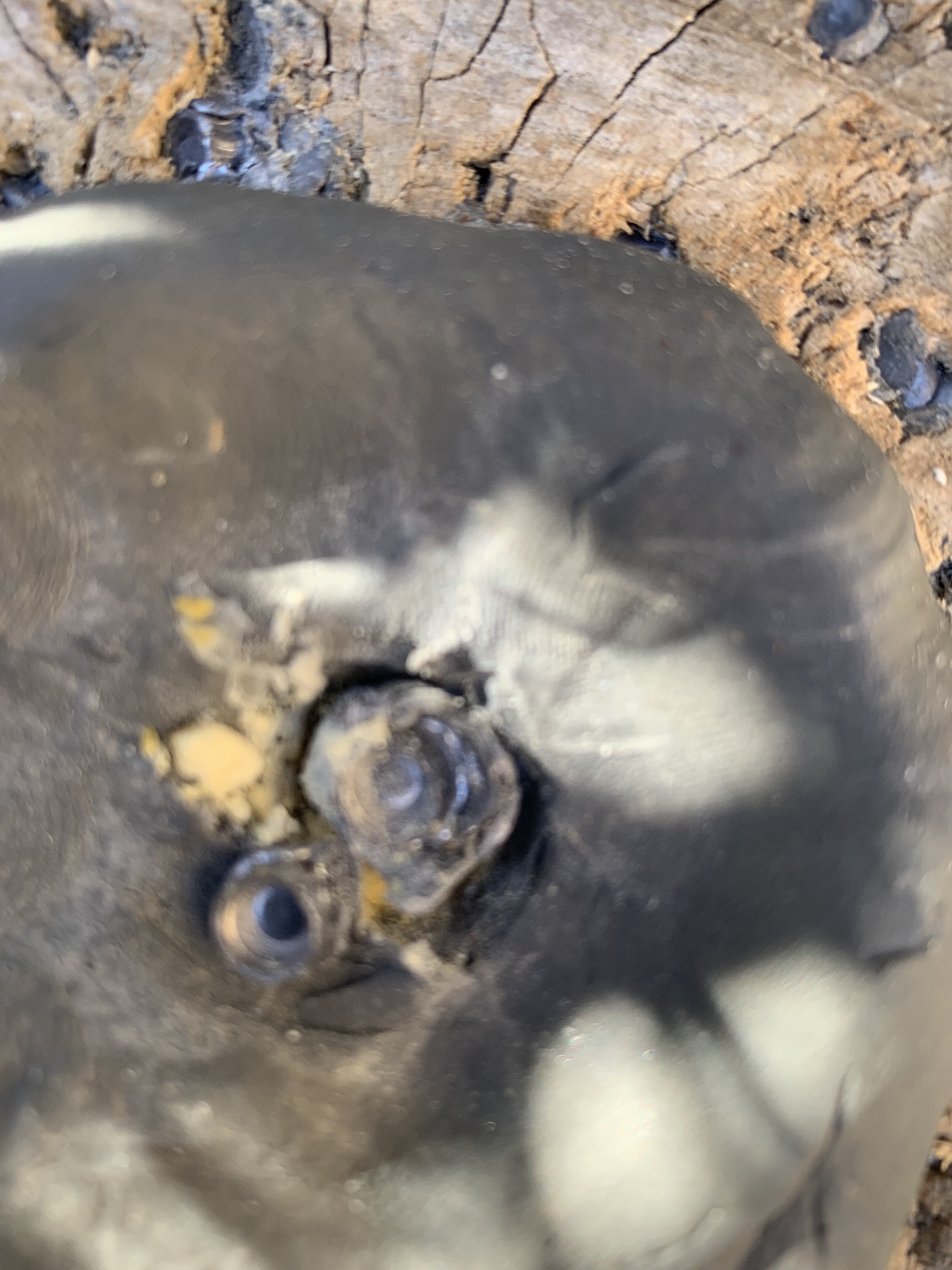

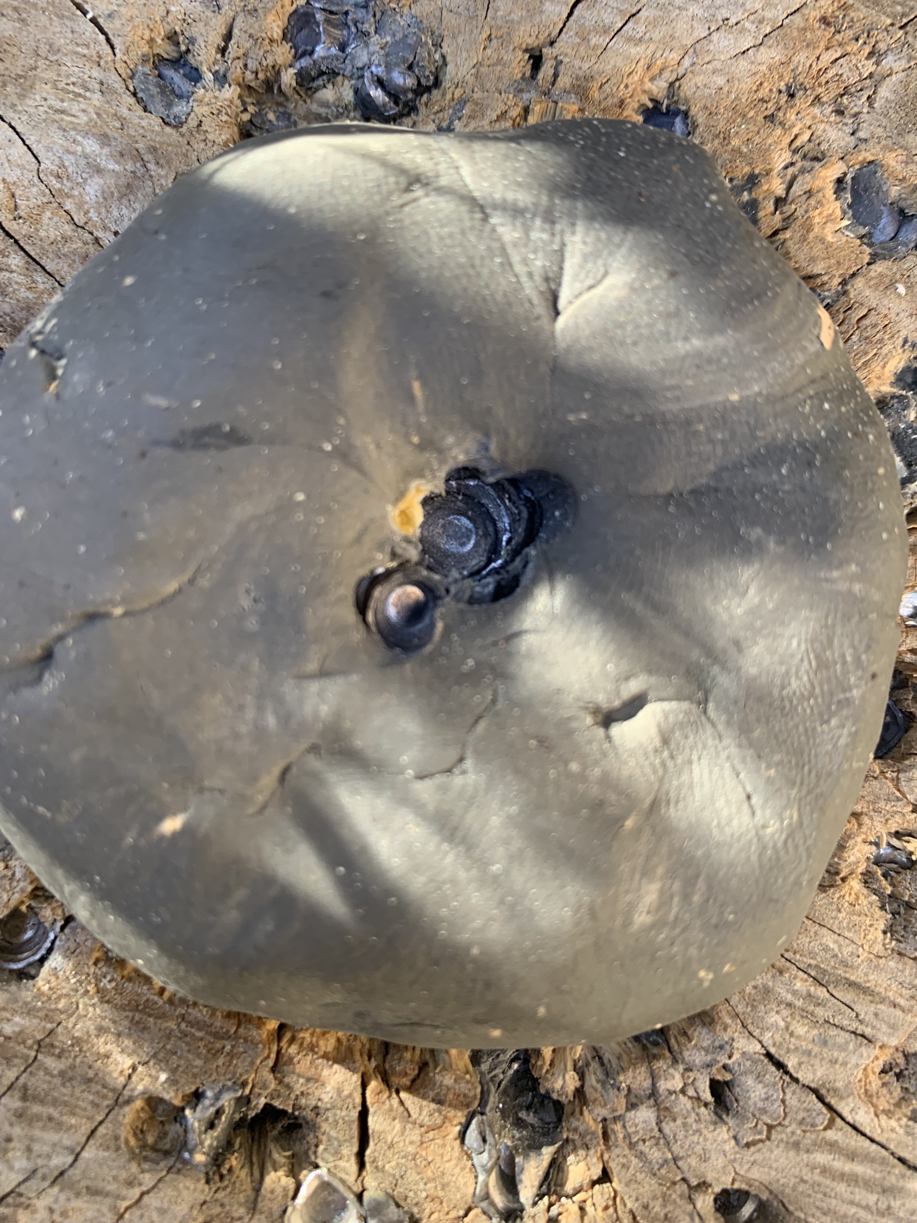

Beautiful morning to shoot its first groups in the stock. 40 yards aiming at a grain of corn in a duct seal block. The gun deserves better. Group #1 after sighting in shot from bags, getting used to the hold:
Group #2 I took a lot more care. This is typical of what it is capable of:

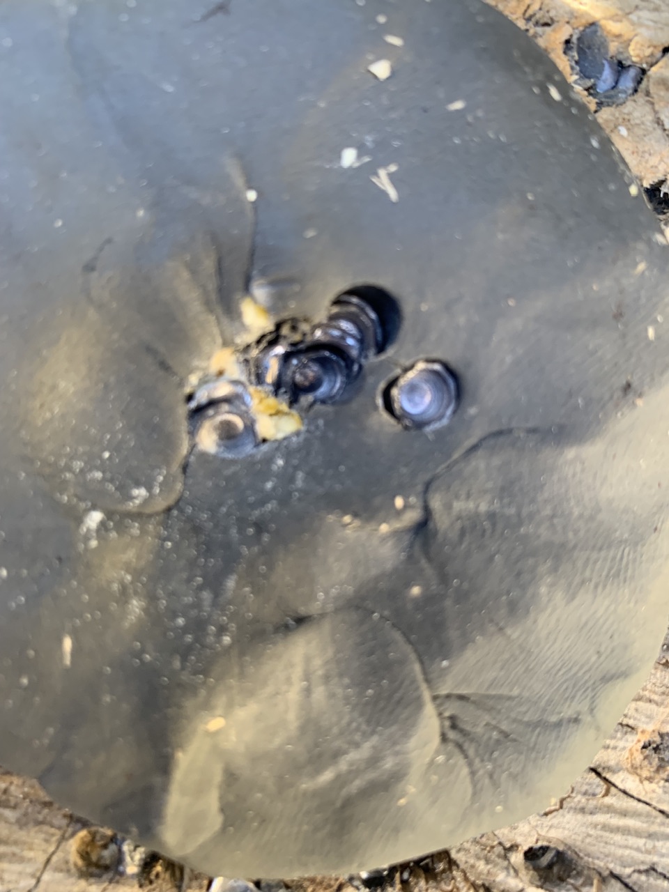

Opening up the duct seal shows 4 pellets stacked and the one “flyer”:
The stock has definitely not hurt it!
Great groups. Very accurate. What power and projectile in this group ?

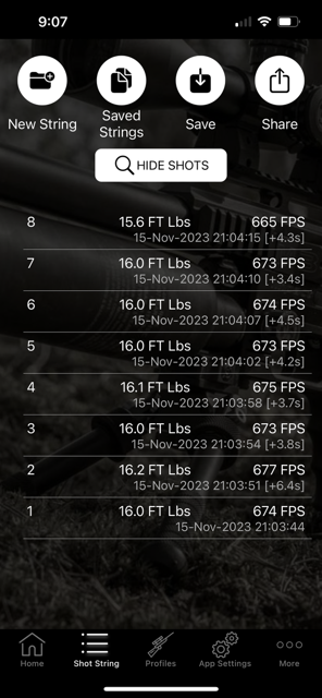

I love my little Prod build. It's a solid shooter!
25 shots at 18fpe per fill.
Corcoran Carbine Stock
Marmot Militia Barrel
TKO Moderator
Light Weight hammer
Valve porting
Trigger work
Custom springs (Hammer and Valve)
Huma Regulator installed
Some secret mods I don't share online
Tuned for reasonable power, I could go for more power, but why? It shoot so well at this speed.
