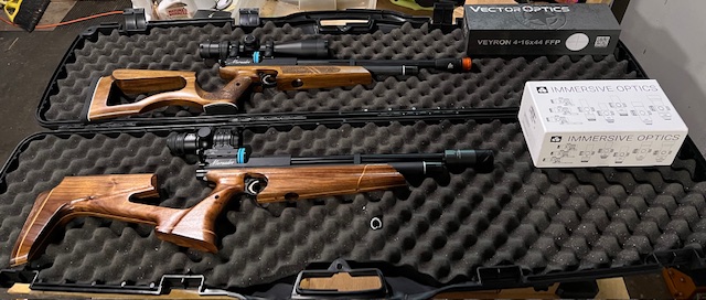

@weevil we are twinning now lol 😆

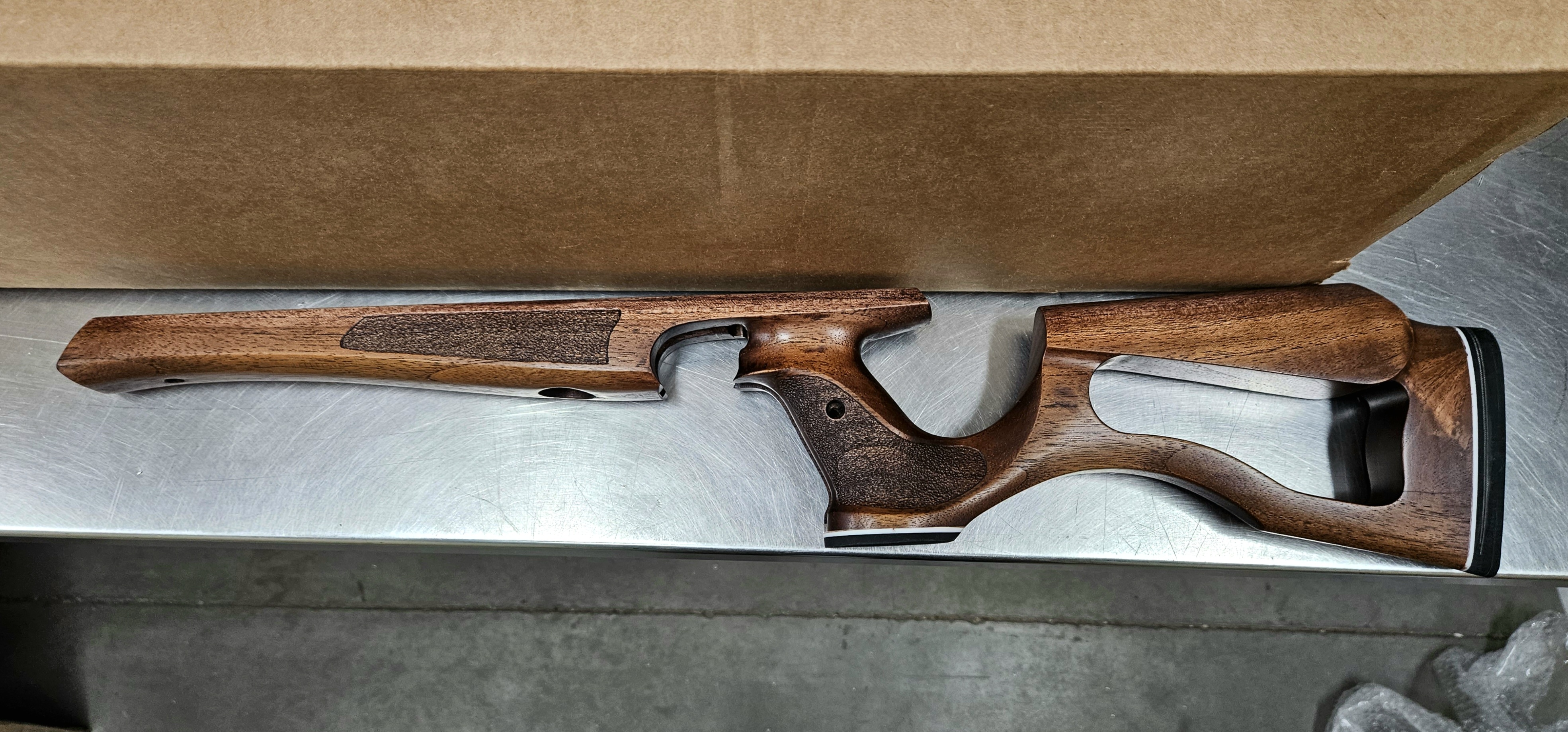

I made a booboo in the first stock and one of Rich premier stocks showed up yesterday, have to get her mounted up sometime this week.
I'm glad my post could give you some motivation, happy shooting man! 🔫 View attachment 406133
Dang. If I were closer, I’d ask you out for a shooting date!

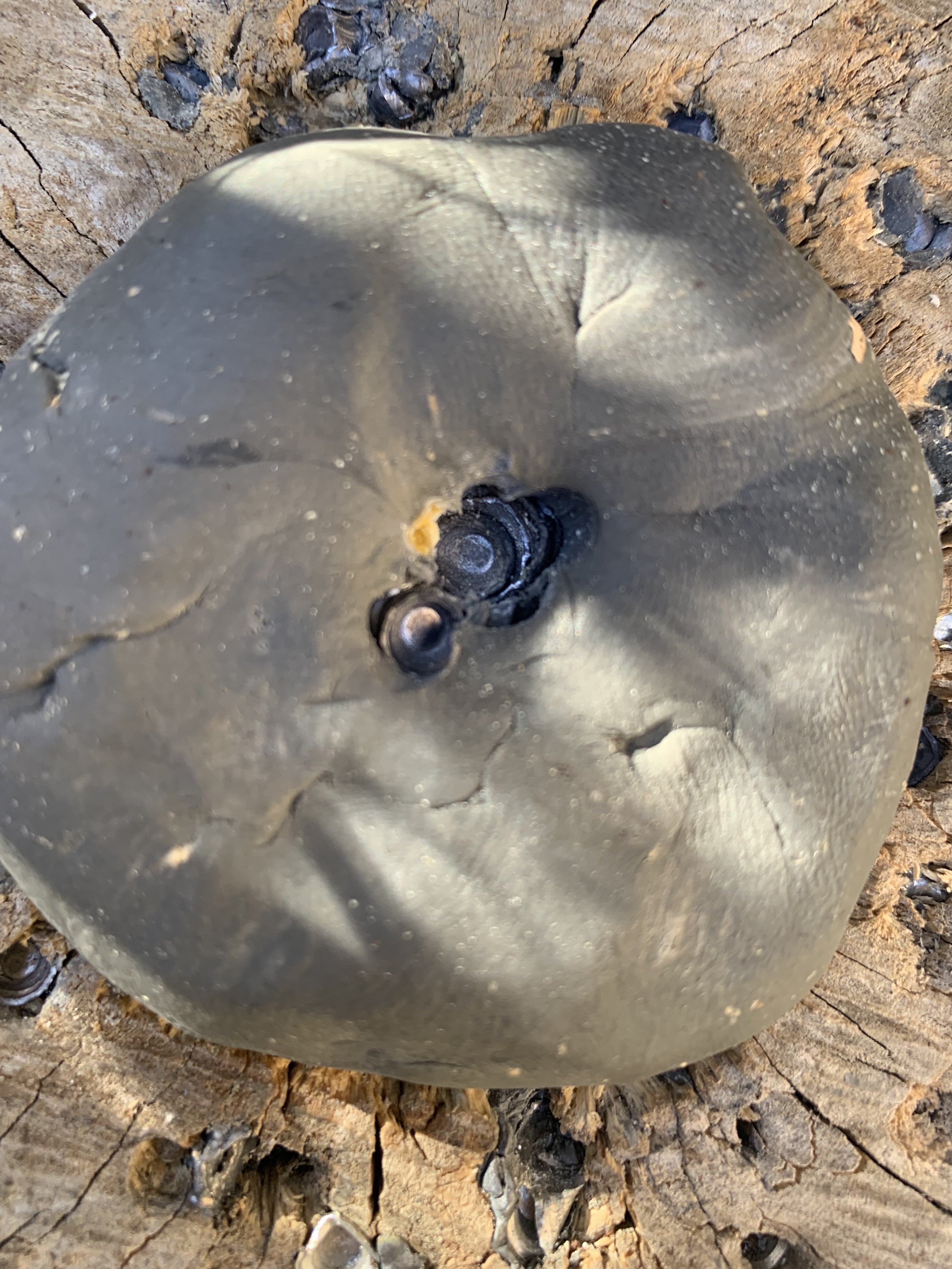

Beautiful morning to shoot its first groups in the stock. 40 yards aiming at a grain of corn in a duct seal block. The gun deserves better. Group #1 after sighting in shot from bags, getting used to the hold:
Group #2 I took a lot more care. This is typical of what it is capable of:
Opening up the duct seal shows 4 pellets stacked and the one “flyer”:
The stock has definitely not hurt it!
