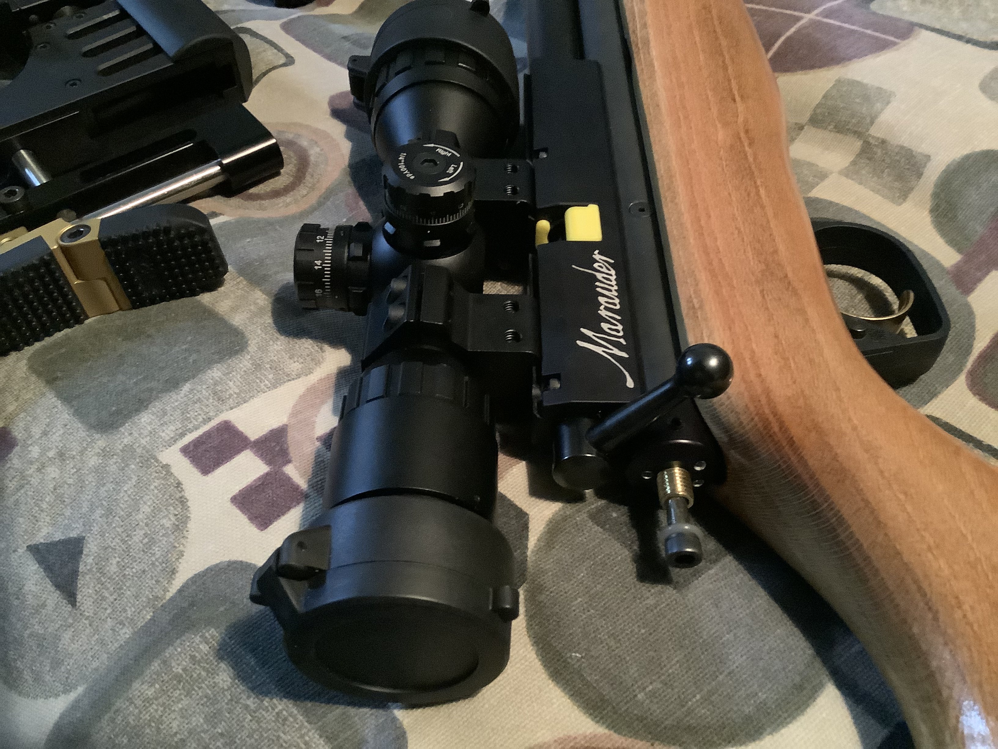

Bought regulator years ago (LW barrel also) but just installed the reg. Reg supposedly came set to 1750 psi. I’m only getting 600fps (consistent 15.99gr H&I) with the hammer spring at it’s tightest.
Question: Do I need to open up the port and barrel air hole to get to the mid 700fps range?
I would think 1750psi on the reg would be enough. PS. I increased the plenum area slightly also.
