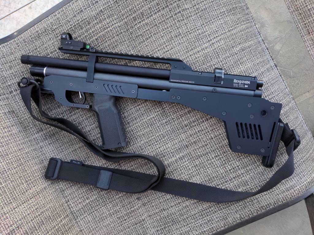

Don't have a Flashpup however aging with neck and shoulder issues we have switched to a rearward bias with Leshiy 2s and bullpups. Six pounds is sill six pounds, it's not the same as a four pound Prod. On a rough day when the Leshiys and the RM5 are painful to shoot the Prod is a joy. It's even more so converted to a bullpup.
Bullpups help keep me in the game by reducing the weight on my support hand. Less polar moment means less effort for general handling, limiting fatigue.
