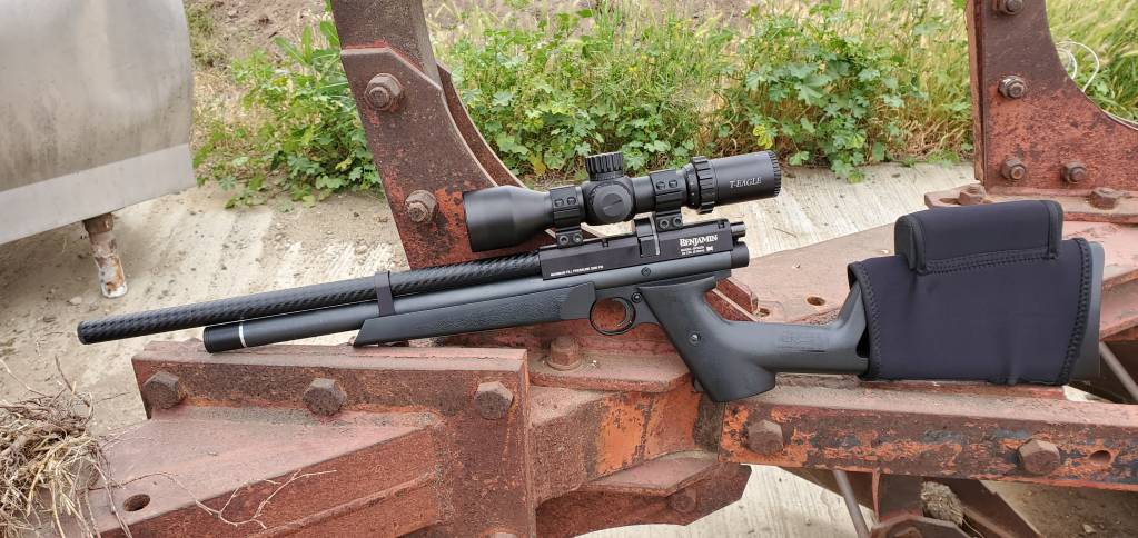

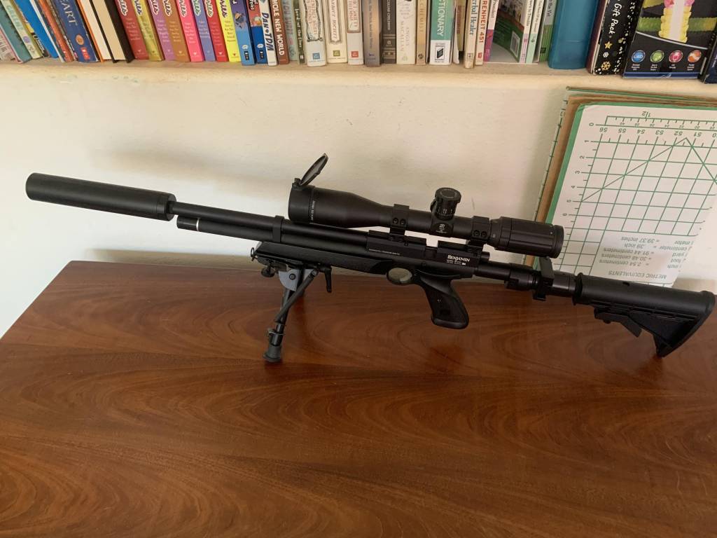

FPS isn't the end all be all. I've got rifles a lot more powerful. But my Woodswalker prod is what I grab. The carbine form factor is utilitarian. Polymags and Hades @ a pedestrian 613 with 3fps std dev are tree tiger kryptonite to 40. dime sized groups and 4 magazines. Squirrels are not wearing Kevlar last it checked.
Mine has huma, RAI, fold stock dump, etc.
Crosman should make a regulated semi auto carbine version.... Capable of pedestrian sub 700fps Skip the pistol all together. Nobody uses the prod as a pistol. If the haven't figured that out they are idiots. just price below $800..
I spent a ton making my bolt action prod a super consistent carbine. Corpsman could get all that margin up front...

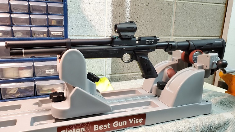

Love my PRod, got my Huma reg coming. Put an air stripper on, but have a TKO ldc too. Power valve machined and honed, transfer port at .110 and exhaust.
