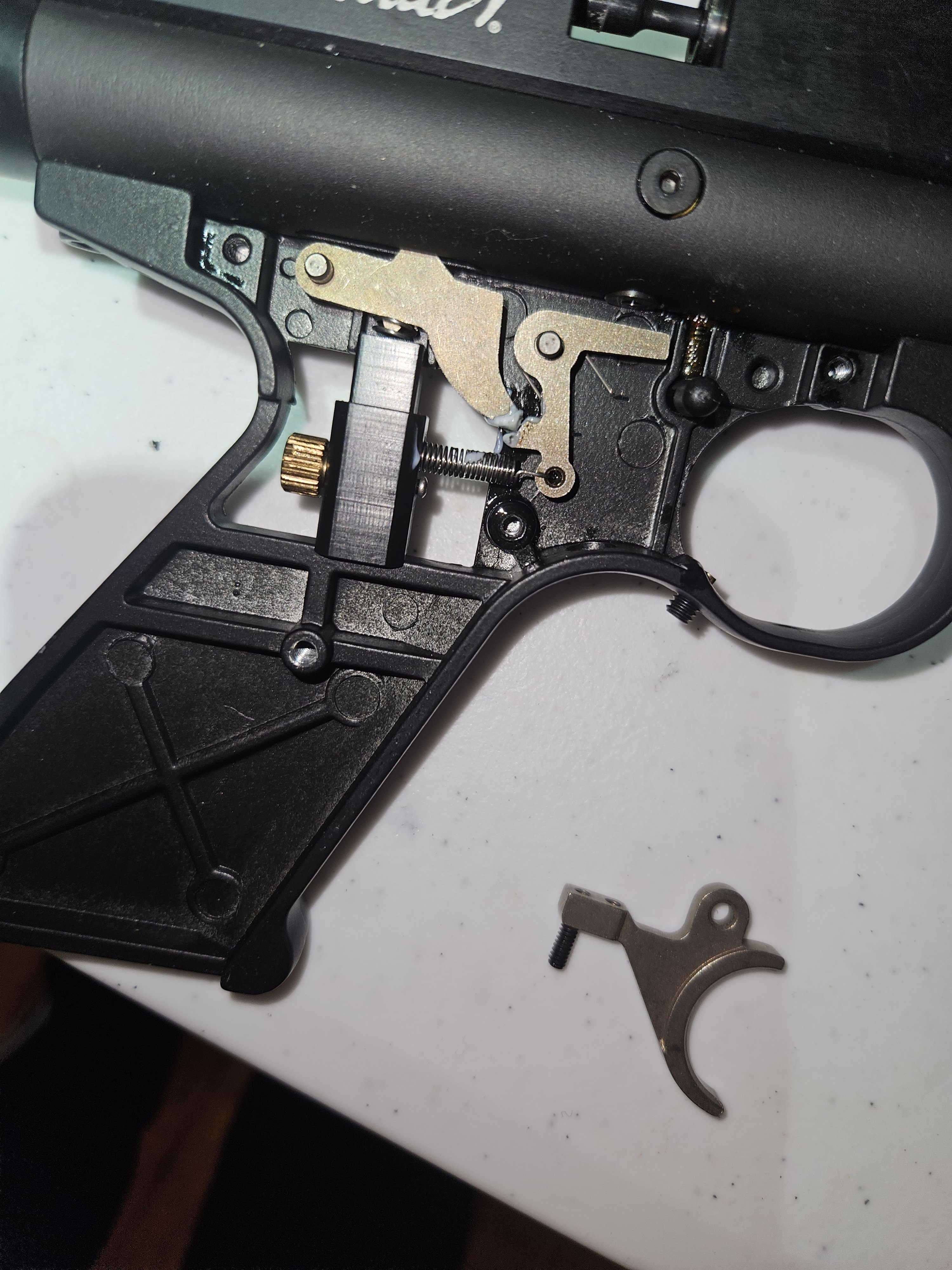

So the little screw backed out from the bottom of the trigger. I screwed it back in and now it works, but there is a second threaded hole in the trigger that is empty. Idk if a screw fell out of it in thinking so. It seems to work now, although without a safety. :D the little ball bearing was driving me mad so I skipped it and pulled the whole safety out.

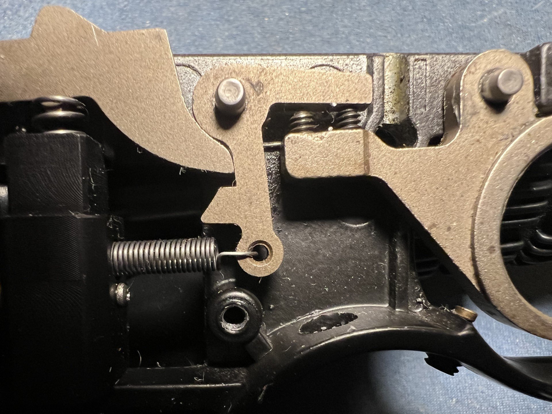

that's the screw on the trigger that was almost all the way unscrewed. There is another hole next to it that has no screw, maybe it fell out... great design!

so you know now that your first stage adjustment screw is missing and your second stage is about to fall out

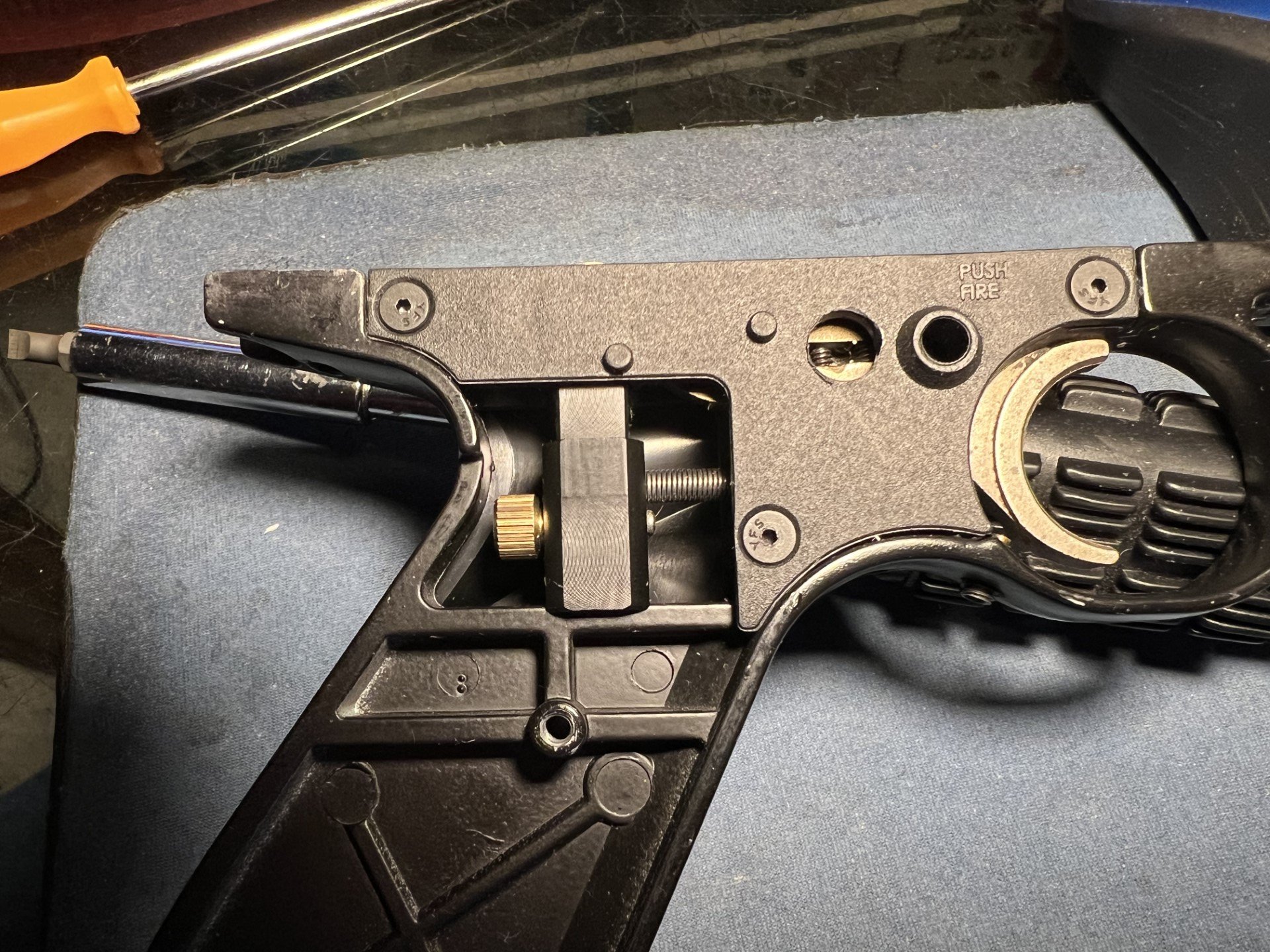

you see in the picture i have drilled a hole in the cover so you can see the adjustment screws and how you have adjusted them and it is not my idea
you can see maybe how i have mine setup on an extra 1701p frame i have

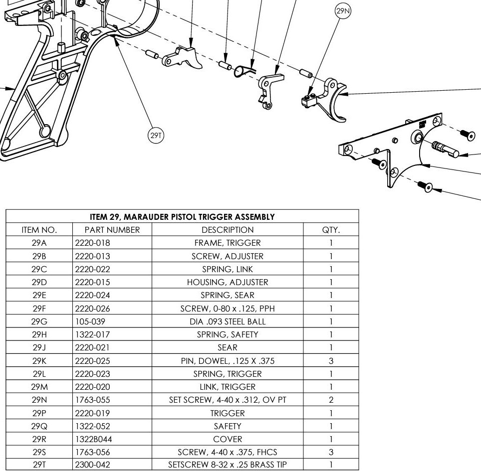

they list the size of the screws in the parts diagram

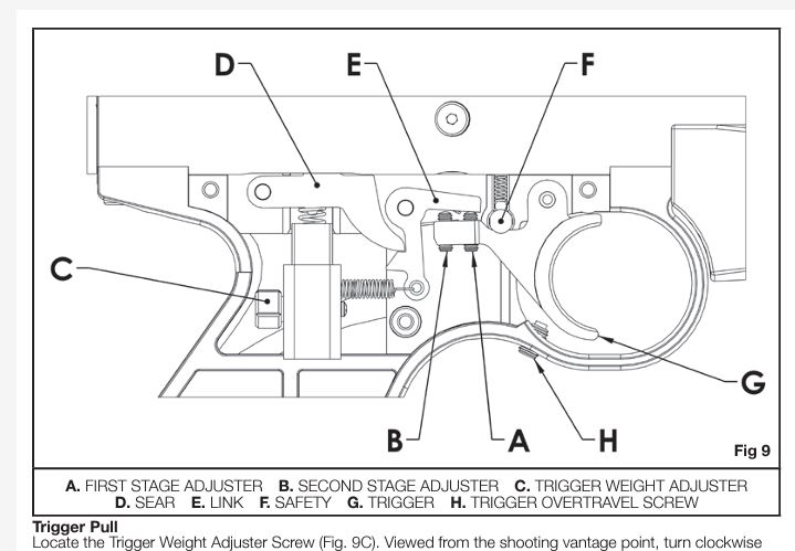

also the trigger now can be adjusted out of the gun push down on the sear and pull the trigger and adjust the trigger till the sear and the trigger are disconnected meaning the sear just moves up and down at that point you have gone too far and you need to turns the screws back also the trigger stop can be adjusted and all of that is much easier off the pistol then on
the front screw hits the sear and the back one trips the sear how you set it up will be how much trigger movement you have
Seems like a lot of grease on the sear. Did it come that way from the factory?

View attachment 455343View attachment 455344
Thank you so much for those photos. I had the trigger put back on the spring incorrectly and saw how to do it correct from your photo, very helpful, thanks.
